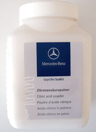

Mercedes Benz sell the citric acid like this for cleaning cooling systems - which works fantastic
the new jar below
would you prefer to buy this from Shahnawaz Ltd? - Its literally food grade citric acid - the same kind you buy at a karyana store / supermarket.
