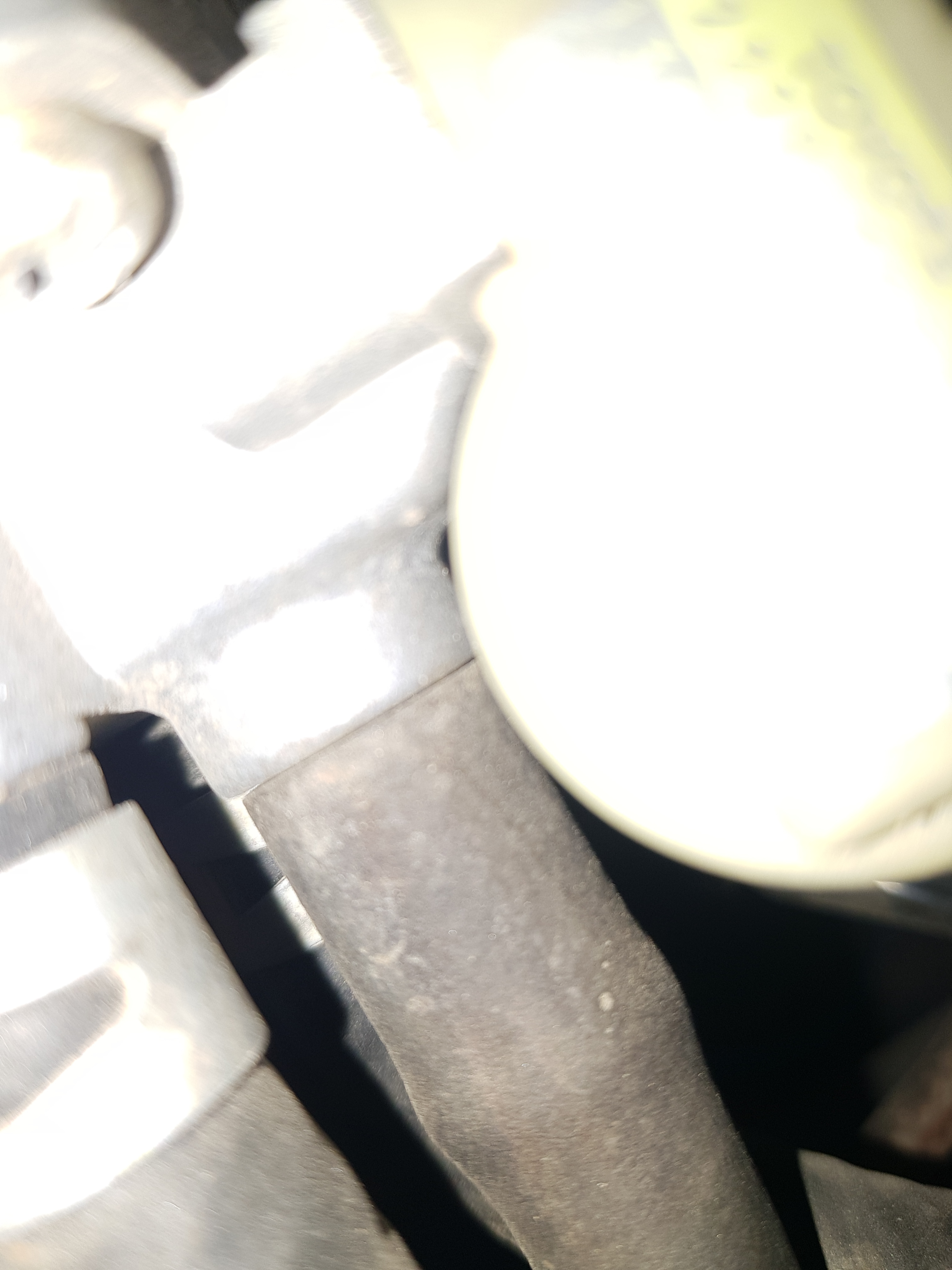

Dear really sorry for late reply. I totally forgot about it.Here you go
1st pipe is directly connected to the manifold.
2nd one is connected to the throttle body right between the both coolant pipes on TB
I hope this will help.
Thank youActually my car is swapped from 2c to 5afe.The ac compressor has just one wire on it's grip.Rest r empty.Even If I connect the idle up to manifold and throttle body my rpm on ac still won't raise.Is there anyway of getting the rpm to increase without messing with the ecu as I don't know much about it.
It has nothing to do with the compressor grip. Plz get your wiring corrected. The electrician will connect the idle up solenoid with AC button.I think you are based in Peshawar. Better to visit any good electrician. There are many in shoba, who know about the wiring of these old A series engines on finger tips.
Make sure the idle up solenoid in connected to manifold & TB and it should get 12v whenever you switch ON the AC. You issue will be resolved.AC idle-up has nothing to do with the ECU.ECU has a pin for AC signal, through which it gets to know whether AC is ON/OFF and adjusts the timing accordingly, nothing more than that.
How much should idle up cost?I messaged some pages.They r in shoba bazar.One of them told me it's for 3,500 rupees.Yes,I am in Peshawar.
Seems like Online page guys are in another world, it should be around 500 to 1k.Better to visit the market & get it yourself. I can also refer you to an electrician, who wired up my car's engine, to get the idle up solenoid installed.
In Sha Allah I will visit shoba bazar myself and get it installed.Online pages prices r too high.

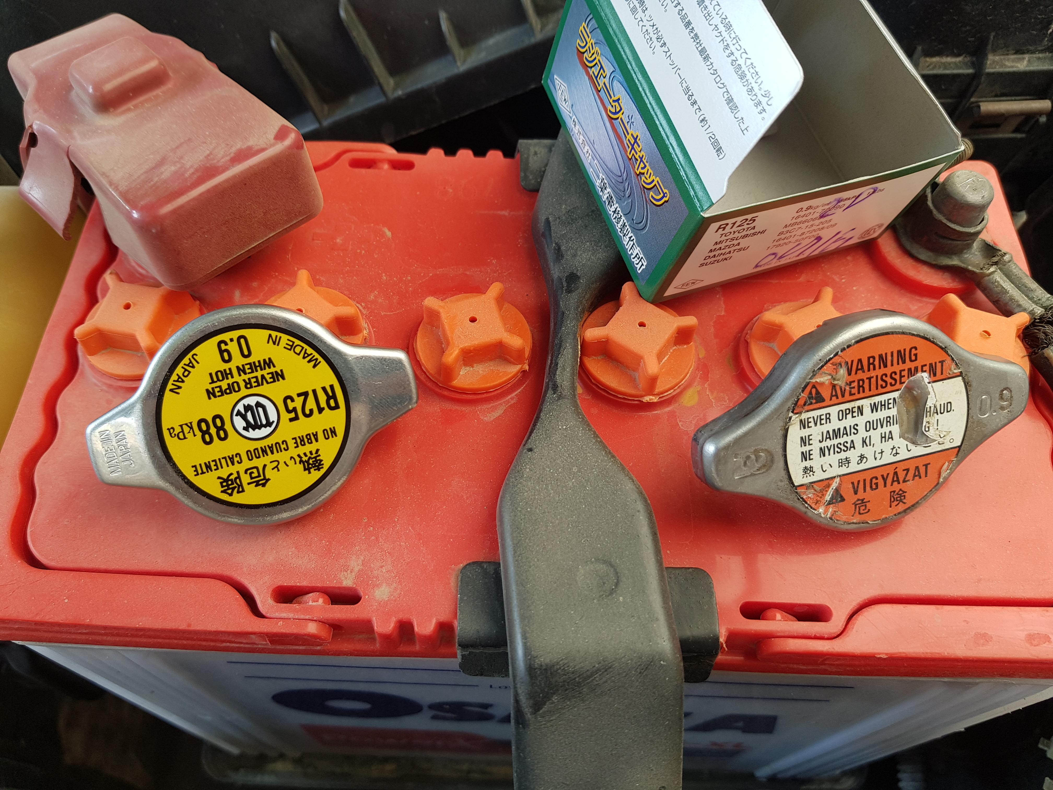

Noticed a very minor coolant seepage around radiator cap. Decided to replace the radiator cap, though the rubber seal of old cap was also intact but seems like it had completed its like.
P.s. note that I got the previous cap back in june 2018, so it was exactly 3 years old.
