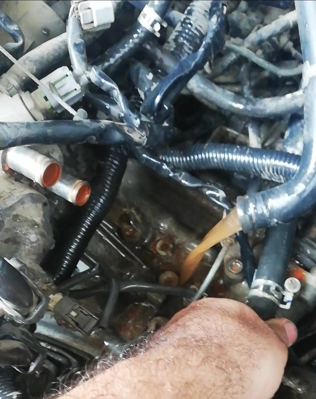

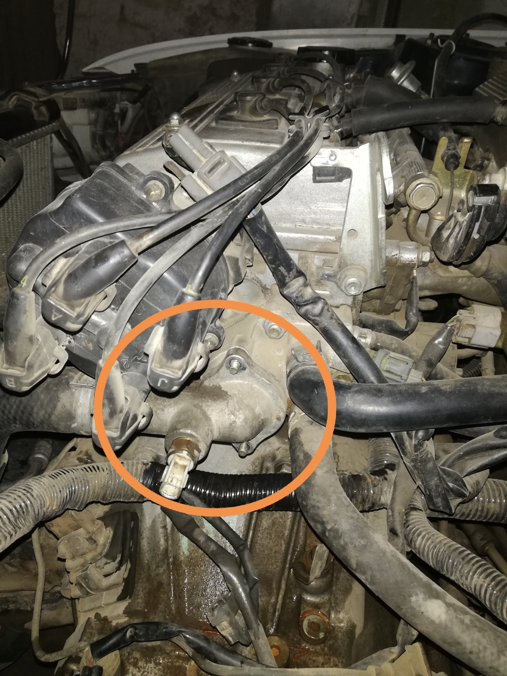

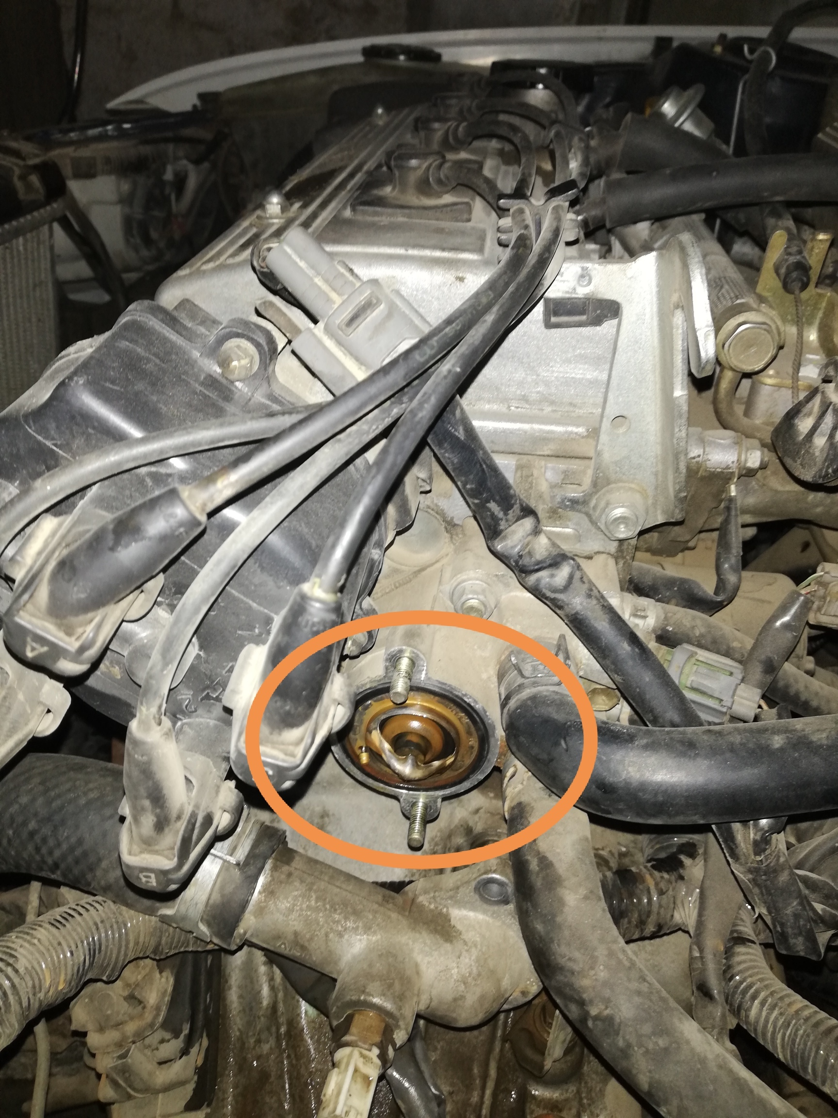

So after removing T-stat & fitting everything back.

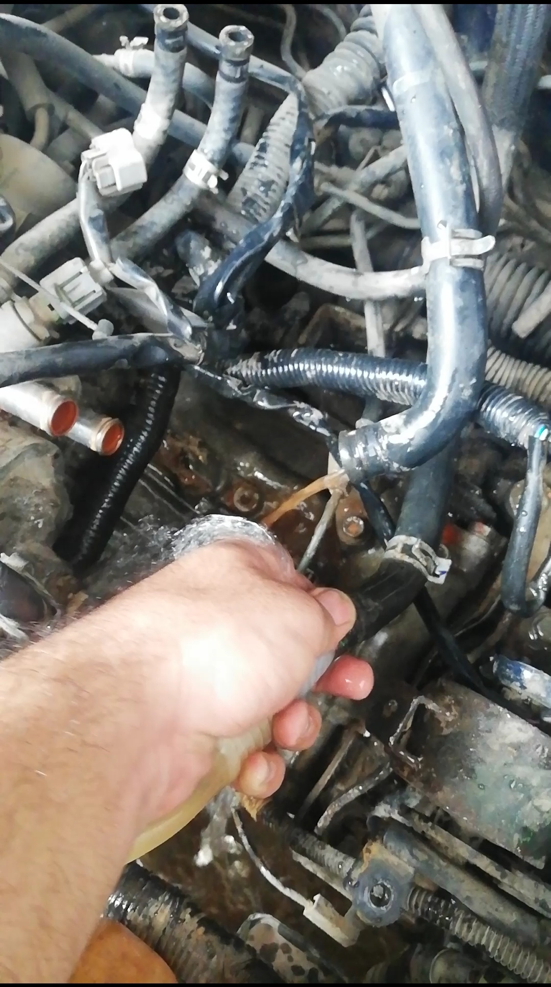

- i filled water in the radiator, turned on the heater (to flush heater coil).
- Started the engine, revved it hard.
- Turned off the engine.
- And removed the drain plug of radiator to get rid of all the dirt & rust inside the cooling system.
I repeated the same steps 3 times. And here is the rusty water that came out of the engine.
In my case, I didn't installed the T-stat yet as I am in mood to flush the system for several times like daily or once after a long drive.
