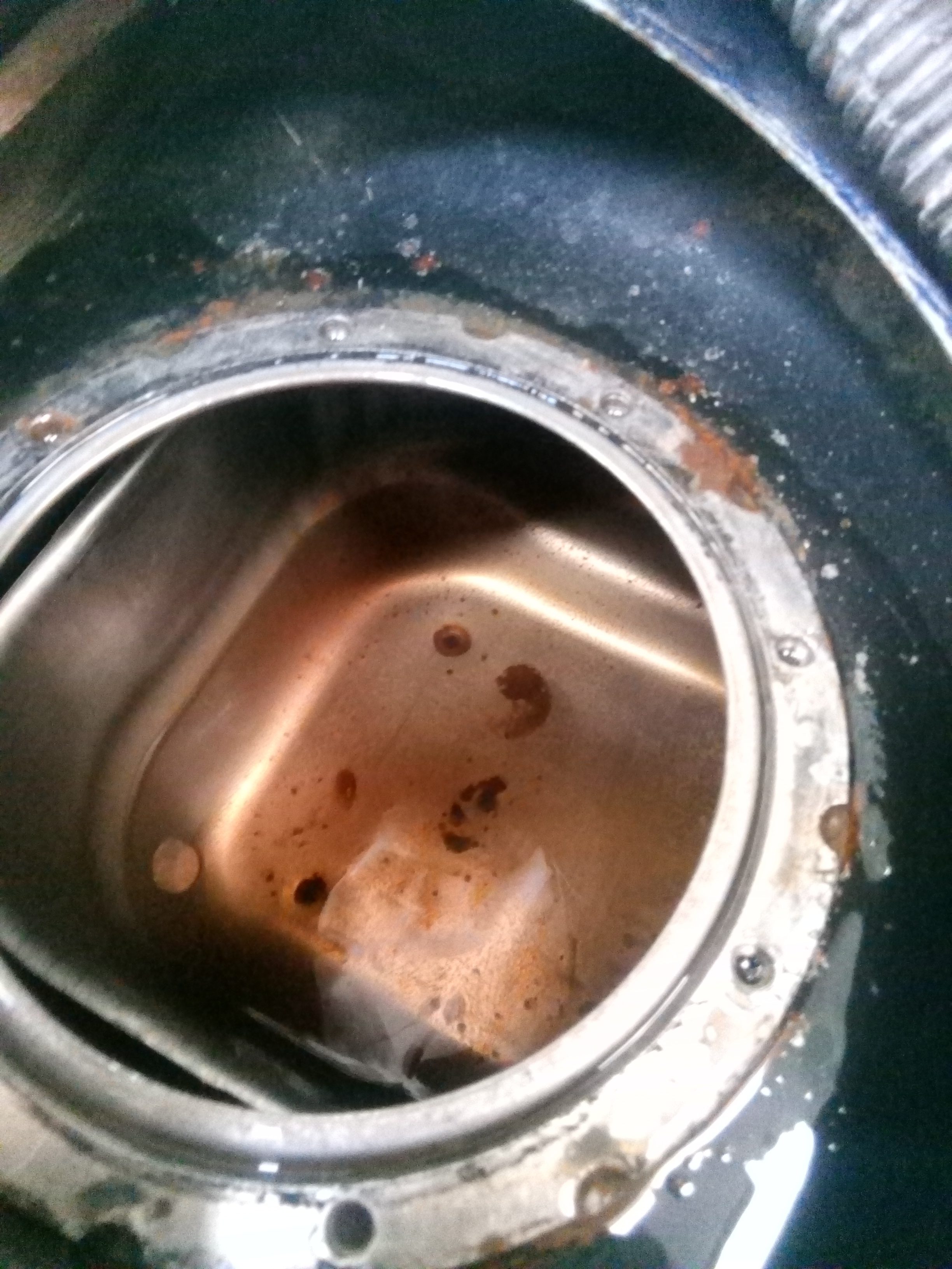

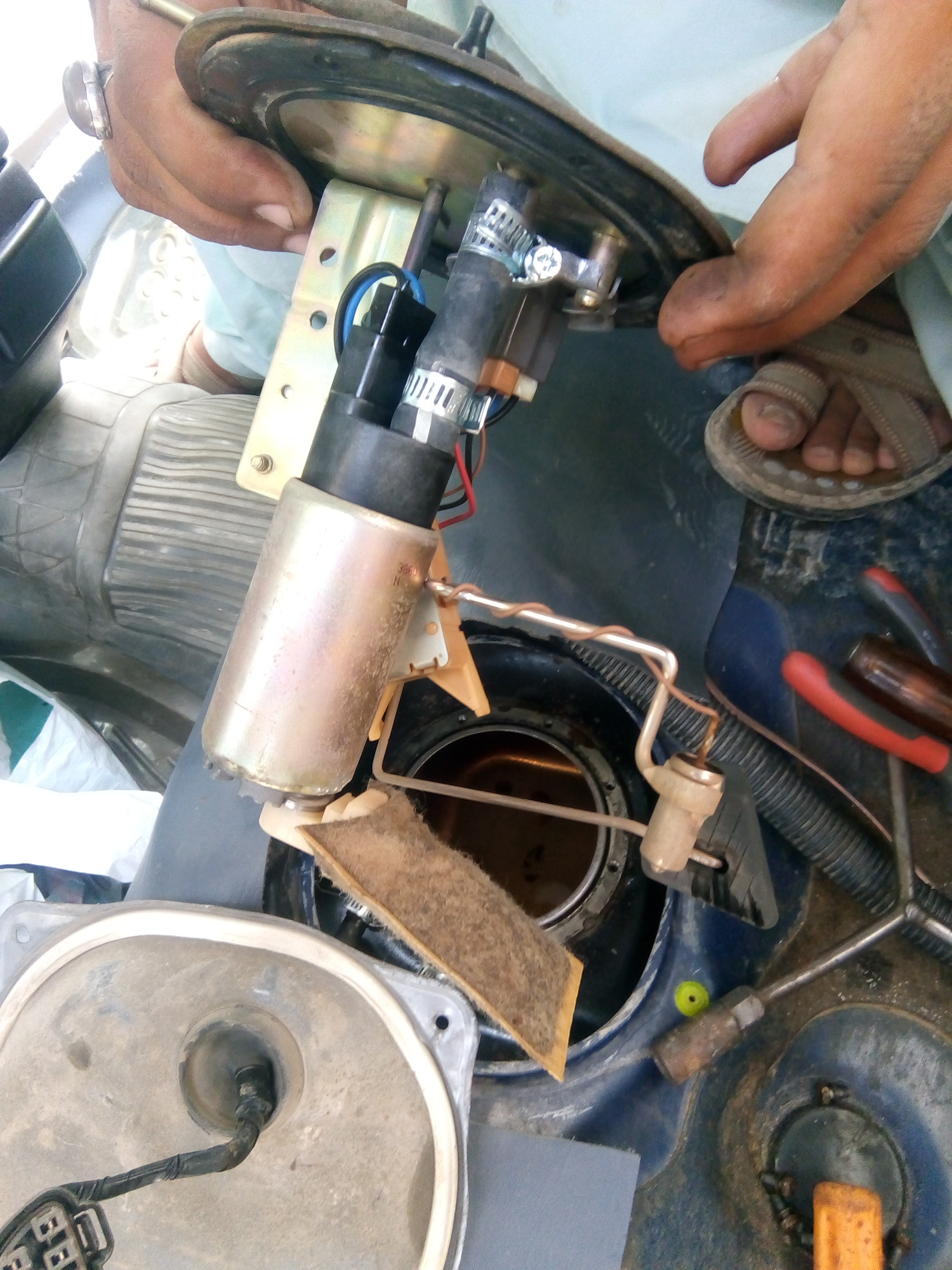

As I was not sure about the presence of fuel filter. So removed the fuel pump assembly just to make sure that the filter is there or not.And Yes it was there & was also in good condition.
To my happiness , fuel tank was also clean internally. There was no rust etc.

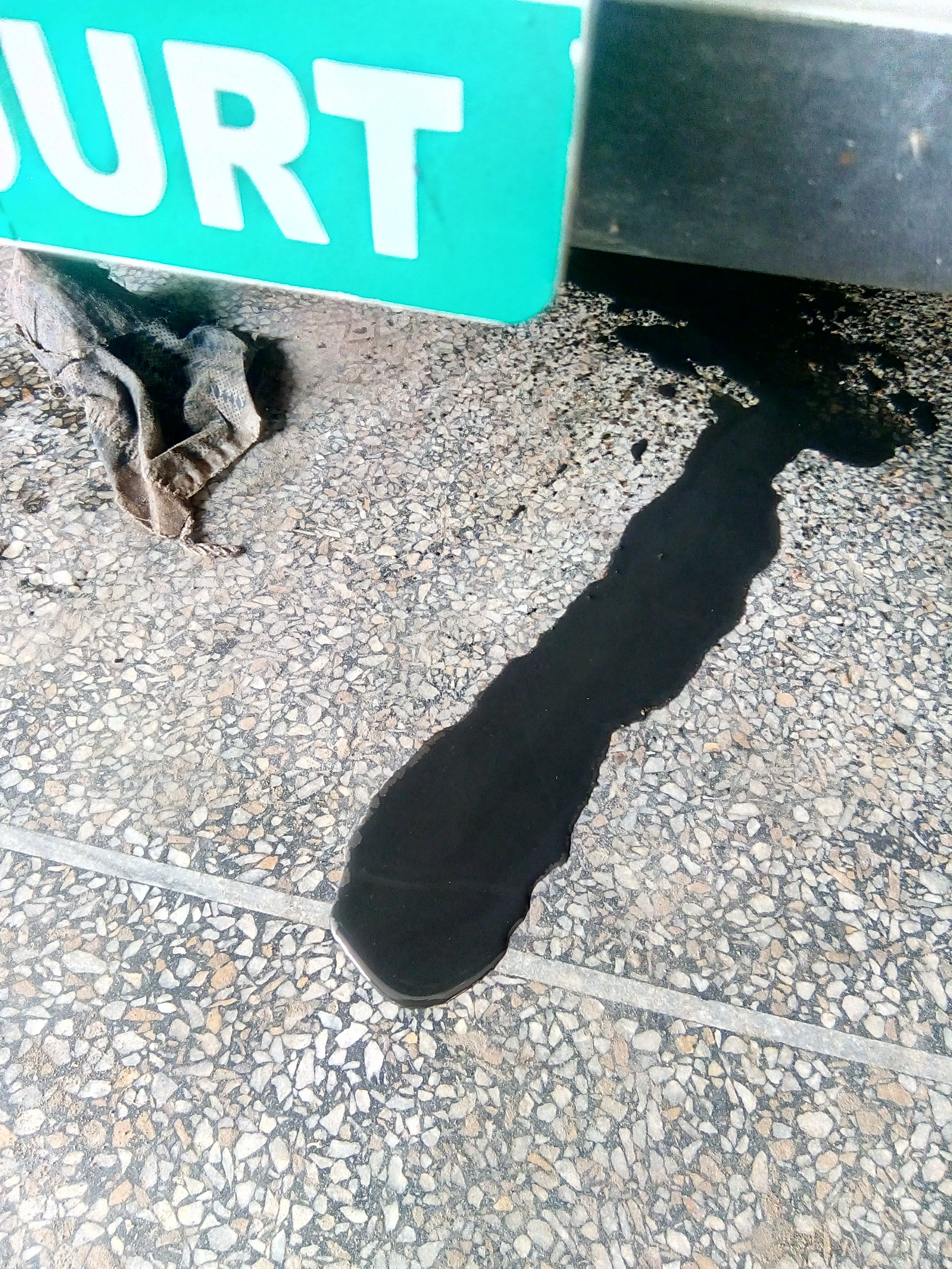

Clutch was not working smoothly, pedal was soft but it was not releasing smoothly. So I went to my mechanic to get the clutch oil flushed/replaced. This thick black mess came out of the clutch line, so I asked the mechanic to open the clutch slave cylinder & clean it internally.

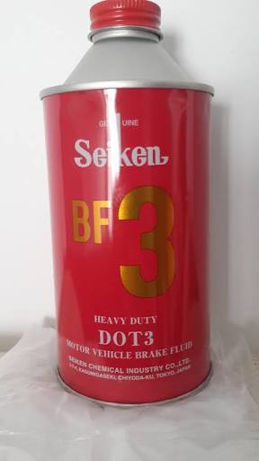

After cleaning & fitting back things, bought this Seiken Dot 3 brake oil & poured it in the Clutch oil bottle.

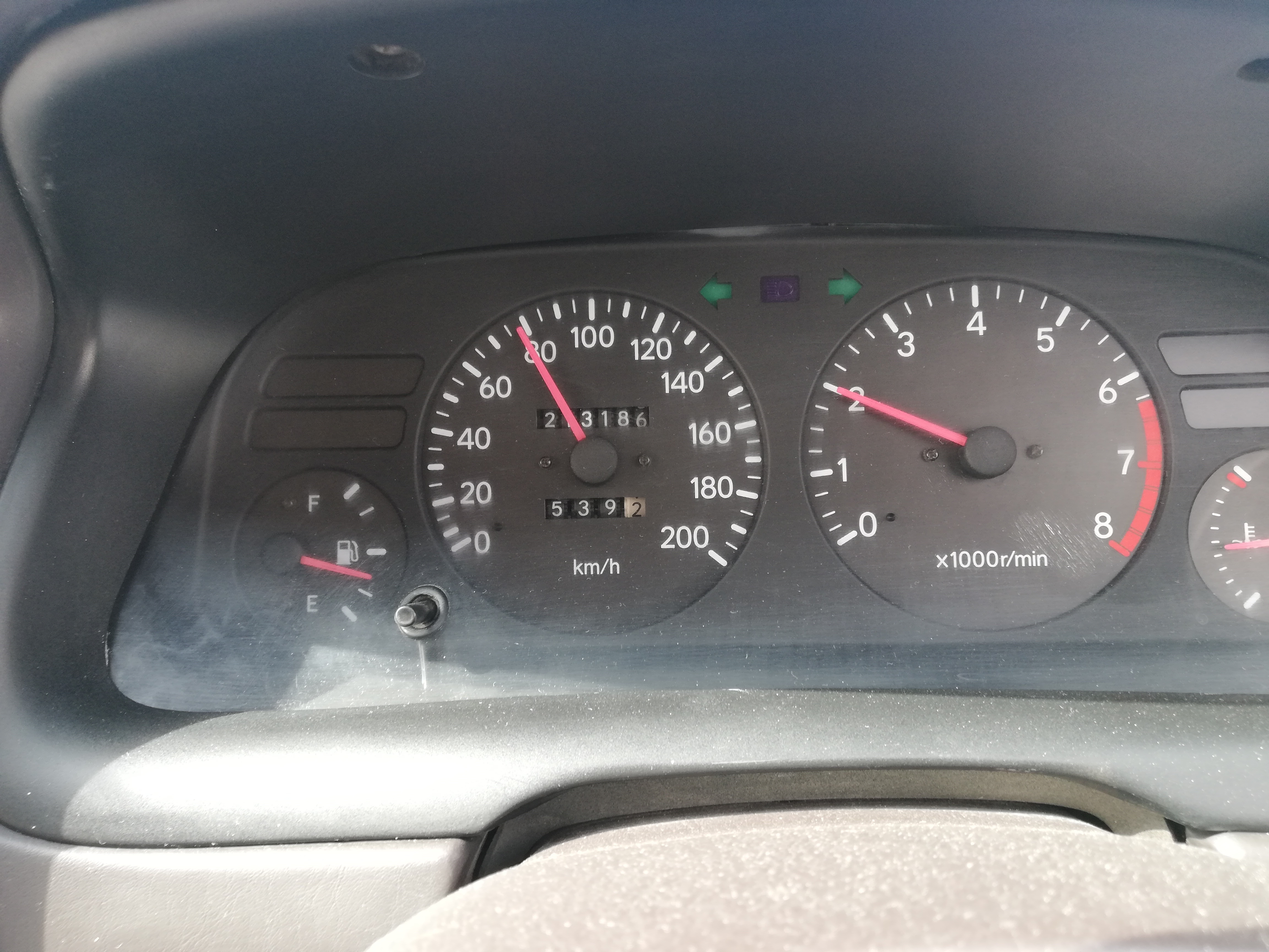

Did a 350 kms long drive yesterday & it returned the fuel avg of almost 16 kmpl with AC ON all the time & 30 mints of idling with AC.Consumed 23 litres in 350 kms ...Drove it within 80 to 100 kmph range !Happy Moments

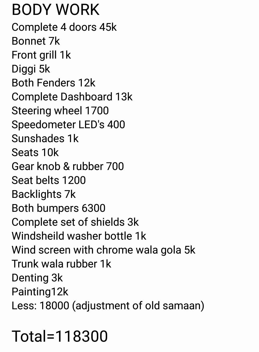

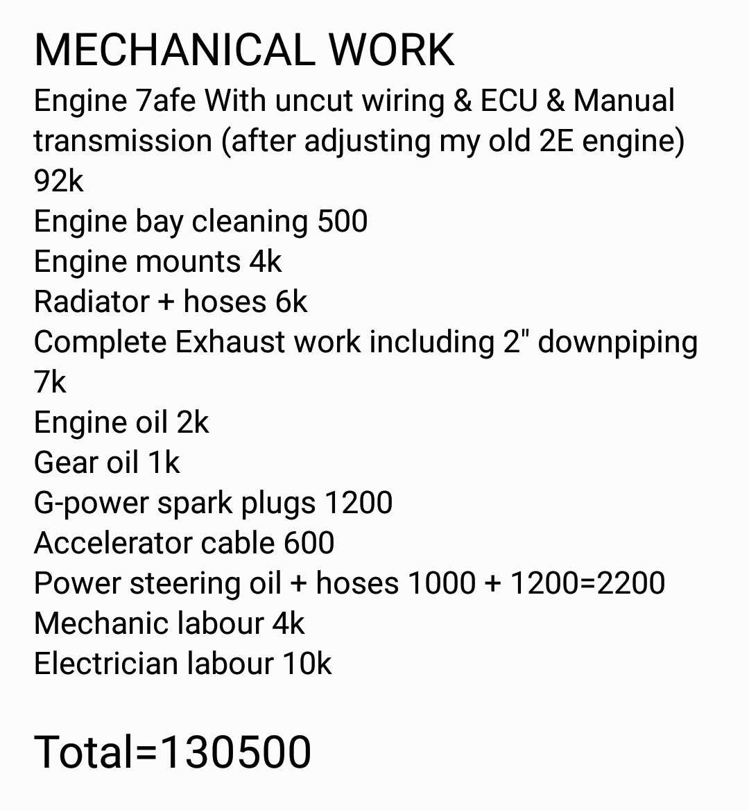

Its time to share the AKHRAJAATSo I prepared the complete list of prices last night. Posting it here to help you people getting an idea of parts costs in SHOBA Bazar Peshawar.
Rims & tires costed me 41500 after adjusting my old rims for 2k & 500 labour.Grand Total 343,300
And how many man-hours you've spent on this project approximately?
how is it giving 16. Prius does 18 which is a hybrid and newer car compared to this. I think you are missing on something
It took me 18 days to be exact, for all the engine swap, wiring, body swap, denting, painting ...Baqi performing DIY's every weekends, not counting them.
