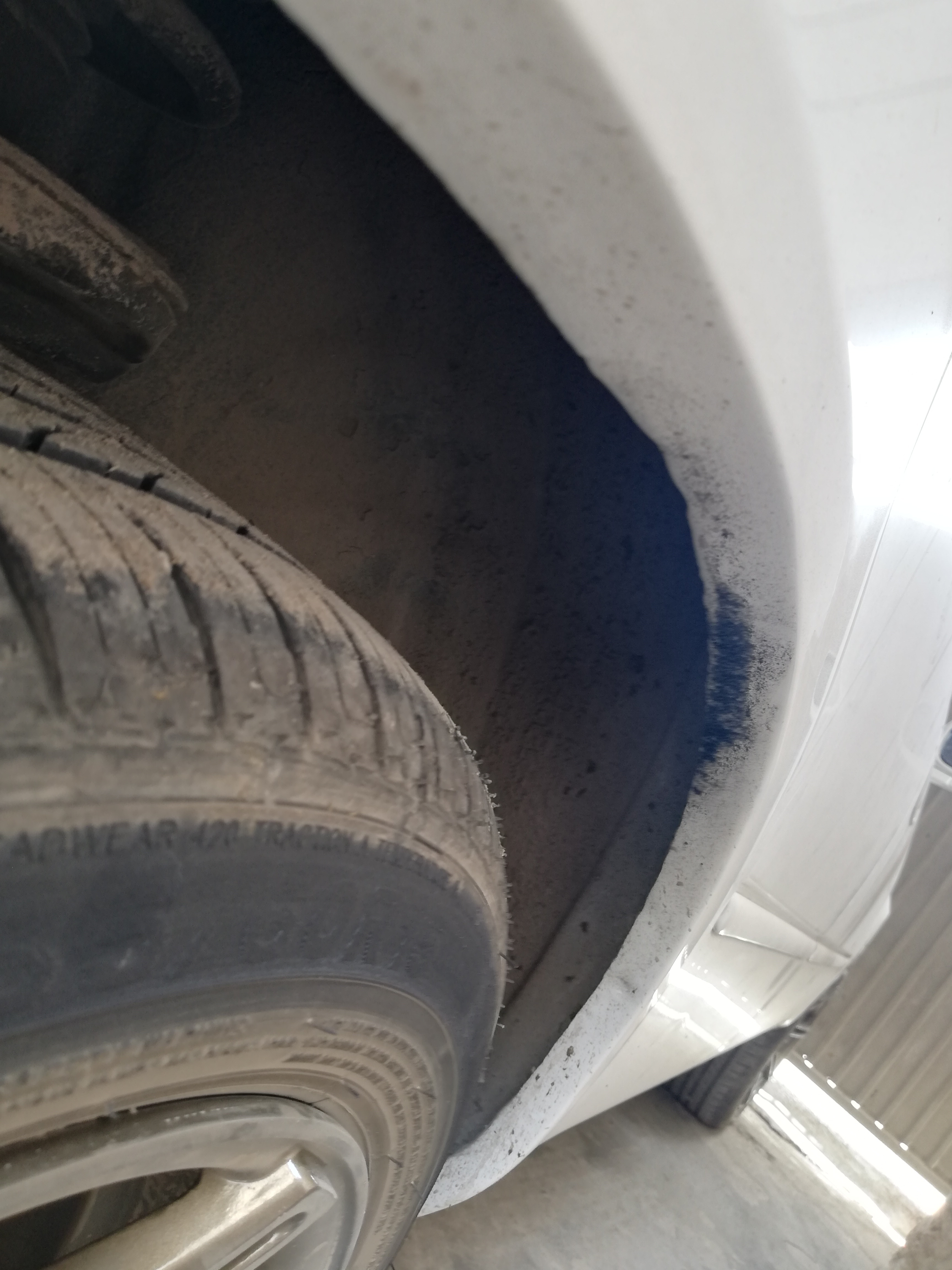

At the moment, I am facing the issue of rear tires rubbing into the wheel arch edges. It happened after installing 15" 7jj alloys with 185-60-R15 tire size.Now, the tires rub into the fenders with four passengers on board.Recently overhauled the whole rear suspension like shock absorbers & everything.What to do? Any suggestions?
A friend suggested me to shave/fold the wheel arches. I got them folded to almost half now. Still the issue persists.

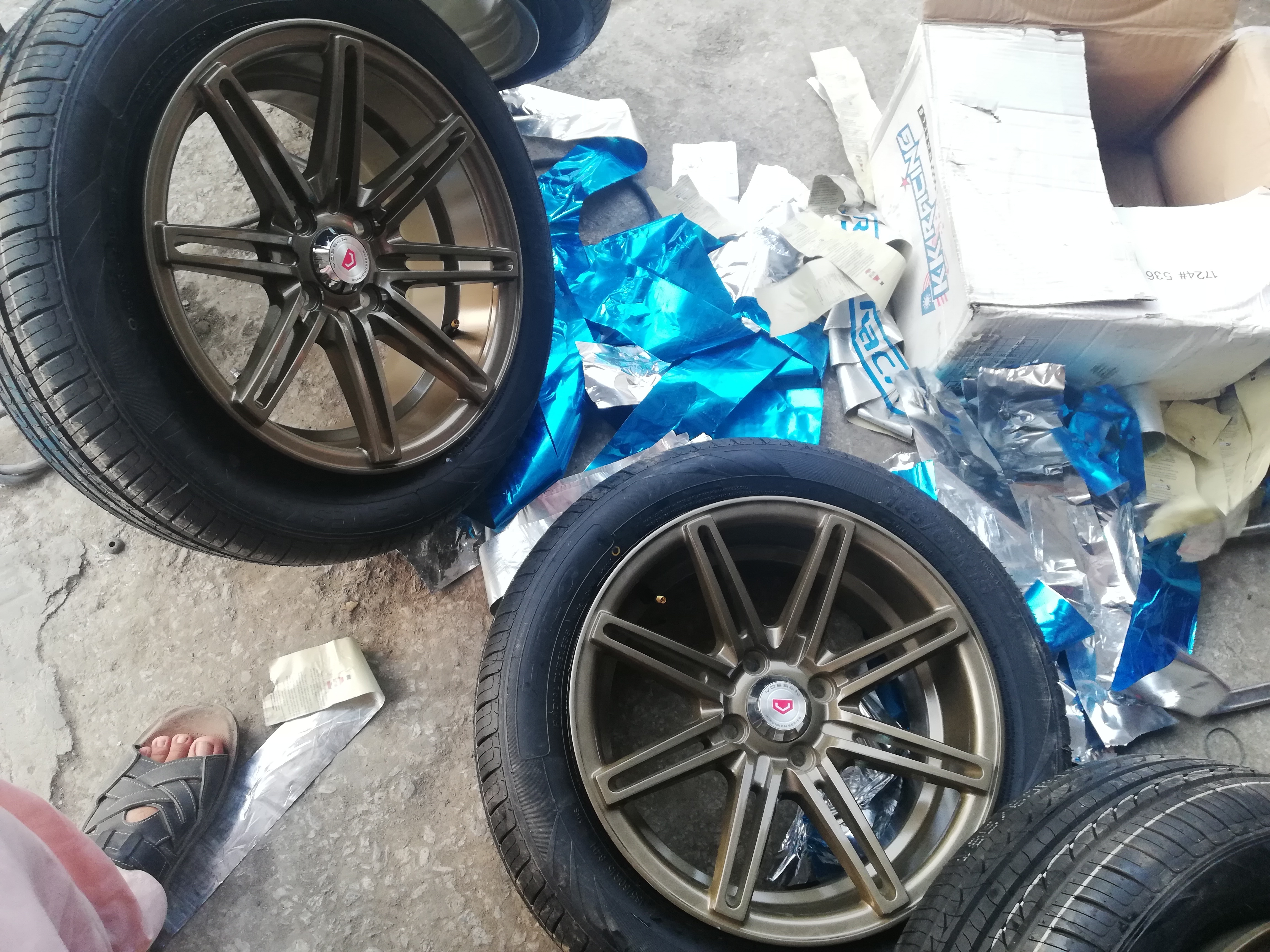

Got these brand new vossens CV4 light weight alloys ...
Get a heat gunWarm the achers and use mallet to fold them. If you warm then right paint will not crack. They are rubbing the archers not inside the fendershow i had done it.That's 195 front
That's 205 in rear
Great choice of wheels. Decent and worth looking.
The offset of the rim also matter. I think the wheels are popped out hence rubbing. The 7jj is too much mostly for 215 size. The maximum you can put is 6 -6.5 inch.
Why don't you put some slight negative camber on the wheels. It will result in greater grip and improved looks

Actually its my daily driver & I want a smooth ride. Also dont know about this negative camber thing. Can you plz explain it ?According to my little knowledge, negative camber will increase the wear n tear of tires as well as suspension. The ride will also become stiff.
I searched alot ... But 7jj was the only option I got. There was nothing less than 7jj in the market.
