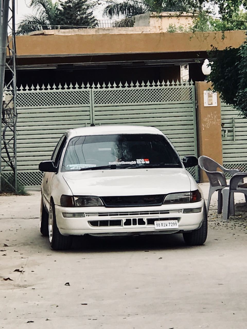

Wow ... So close ... So they dont rub in the arches ?
This is an example of negative Camber. This car here is slightly cambered to fit the larger Tyres and to give it cool looks. Plus it is also dropped on lowering springs. Depends on ur suspension and shocks settings to make how ur ride behaves.

Actually a lowered car is not my taste plus the roads in my region also dont allow me to lower it. I also got the 185 60 r15 profile after much homework & research. The tire profile is closest to the stock 185 65 r14. Still got the rubbing issue
Guys my mechanic is suggesting to get some harder springs i.e. local CNG walay springs to get rid of this rubbing issue.What do u people suggest ? Should I go for them

Depends on u brother. Agreed everyone has it's own taste. I like lowered and cambered cars personally but no modifications to the body. Stock body but lowered and cambered is . Plus a nice exhaust which changeS sound at 3000 RPM or more......
