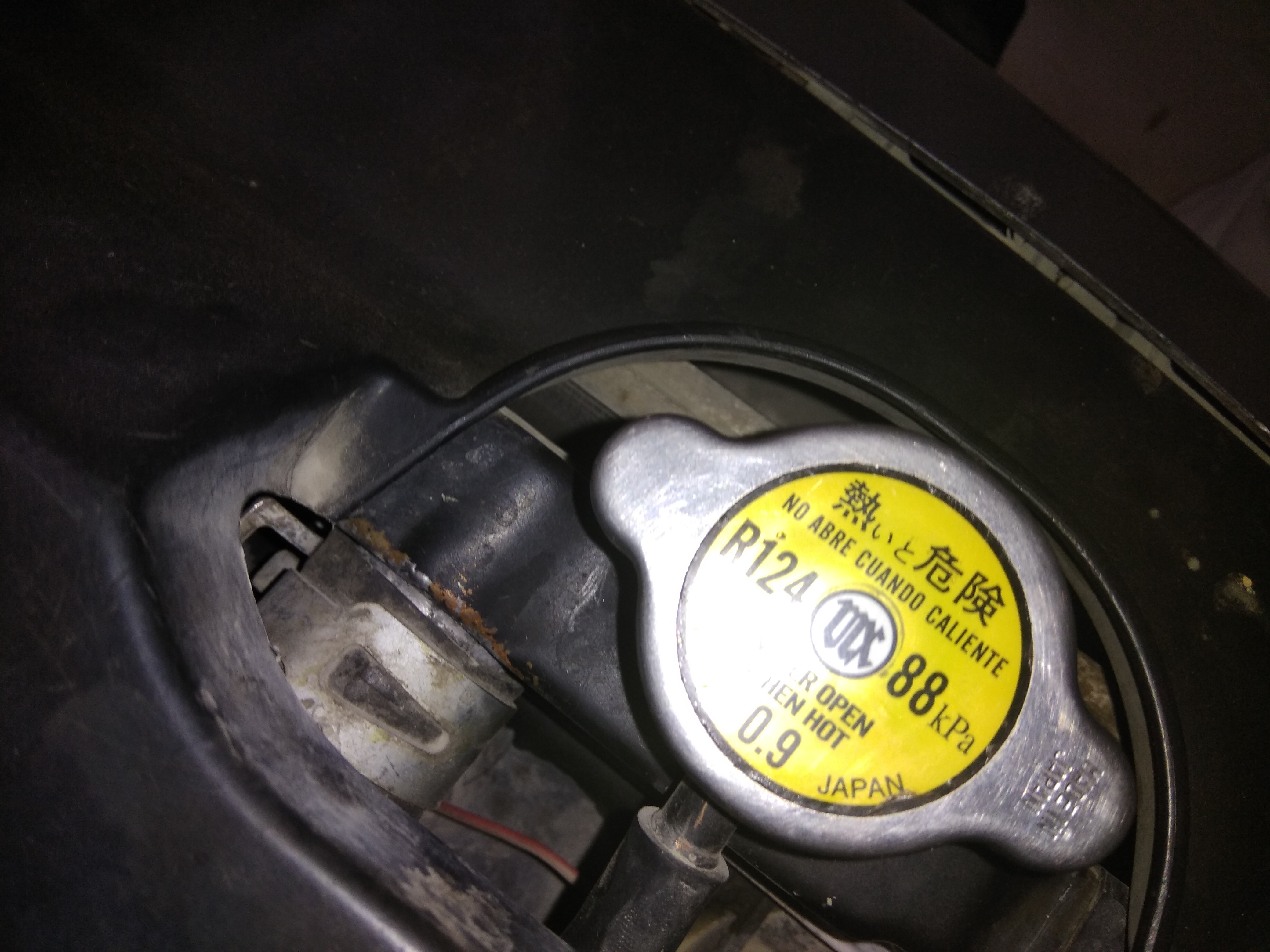

would you believe, my 96 civic is still using the same radiator it came with from the factory?
only top tank changed due to a crack in the plastic tank which was leaking radiator slightly. other wise never opened.
always used coolant no matter what. no overheat no problems till now.
