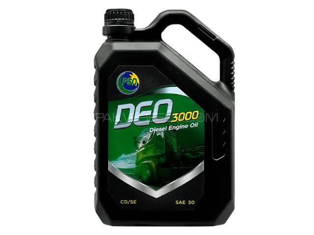

I would check your battery's voltage drop during cranking. It's entirely possible you have a weak or weakening battery, connections to the starter, or starter motor. Another possibility is that your engine oil is providing unnecessary added resistance because it is too thick and difficult to get flowing on cold start. This usually has to do with either exceeding the manufacturer's spec or using an oil unsuitable for your climate.
If it's the latter, I suggest you use the right engine oil for your vehicle and your local climate. Your owner's manual will have the correct specification.
