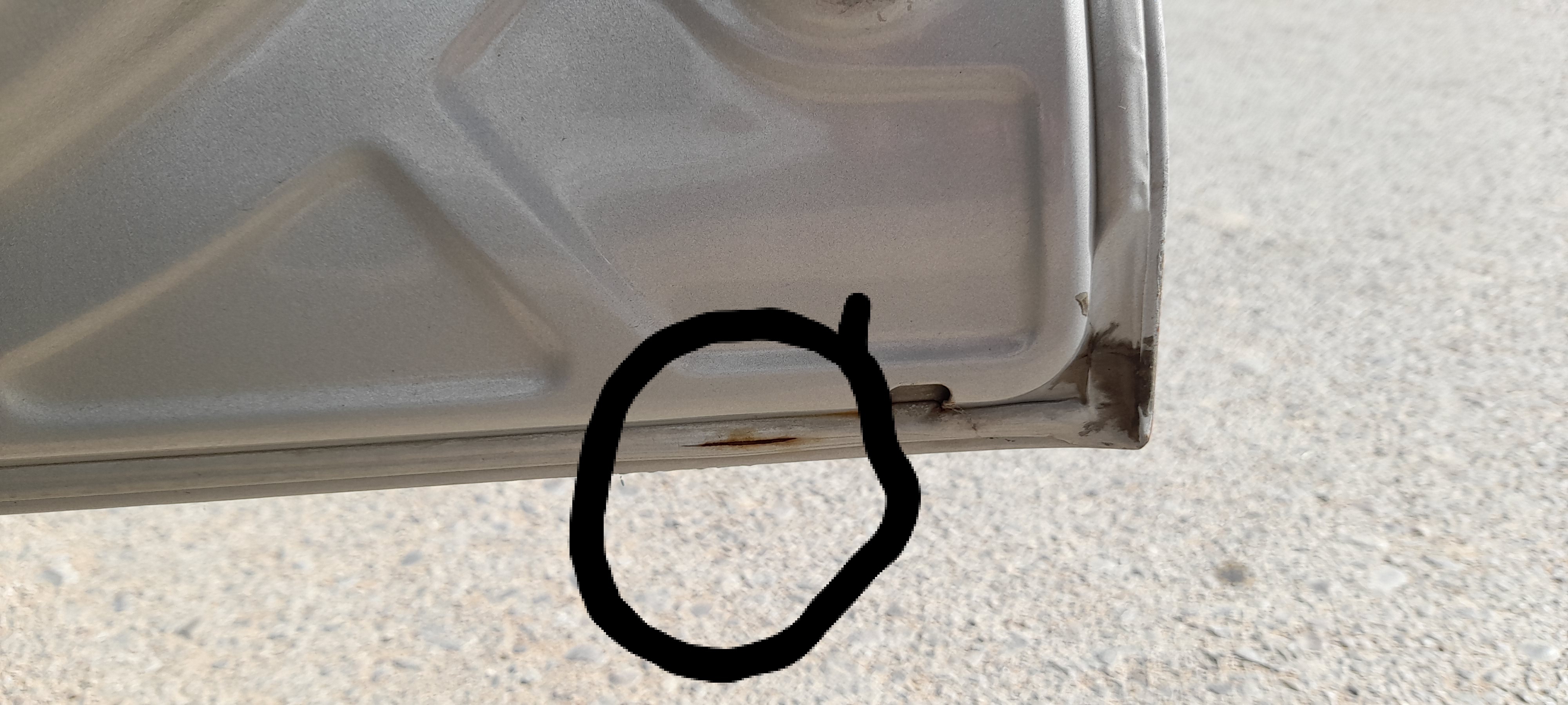

Finally rust started appearing on my 2016 city. I talked to a few friends and all recommended spray cleaning with WD-40 and application of coconut oil. What's your take on this dear PW's. Posting pic
I had the same issue on all four doors, removed the rust and added some touch up paint as selaer to prevent further oxidation.
I have never washed the doors from inside, like some service stations do. Is it a possibility that tain water seeps in from outside the door to this area. I will cx the drain hole for blockage, shouldn't be any.Comments on WD wala desi totka plz
You are from Karachi?
Thank you
Presently I am in karachi, close to sea. Within 4 months the rust has appeared.
Yup. True
I kept city for 8 years.... From 2012 till 2020..... Drove 140k Kms.... Not a dot of rust.... This is specific to Karachi i guess
Yup. This all happened within 4 months. Before moving to karachi the car was clean.
if the car is washed cleaned with brickish water in karachi such rust fractures appear very often. The best way is to clean it with a rust remover and apply coat of antirust clear lacquer. Both can be purchased from adenwala mr. abid 0300 1105253 or from daraz
Been washing the car once every month. Should i reduce the frequency to maybe bi-anually?
