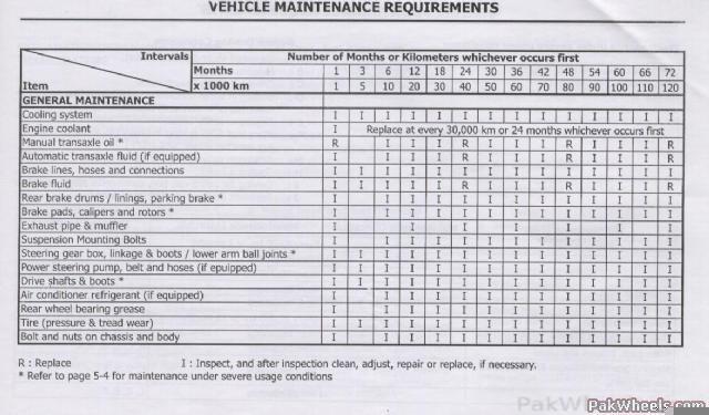

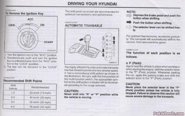

For all Santro owners, i am attaching Santro manual pages for guidance
