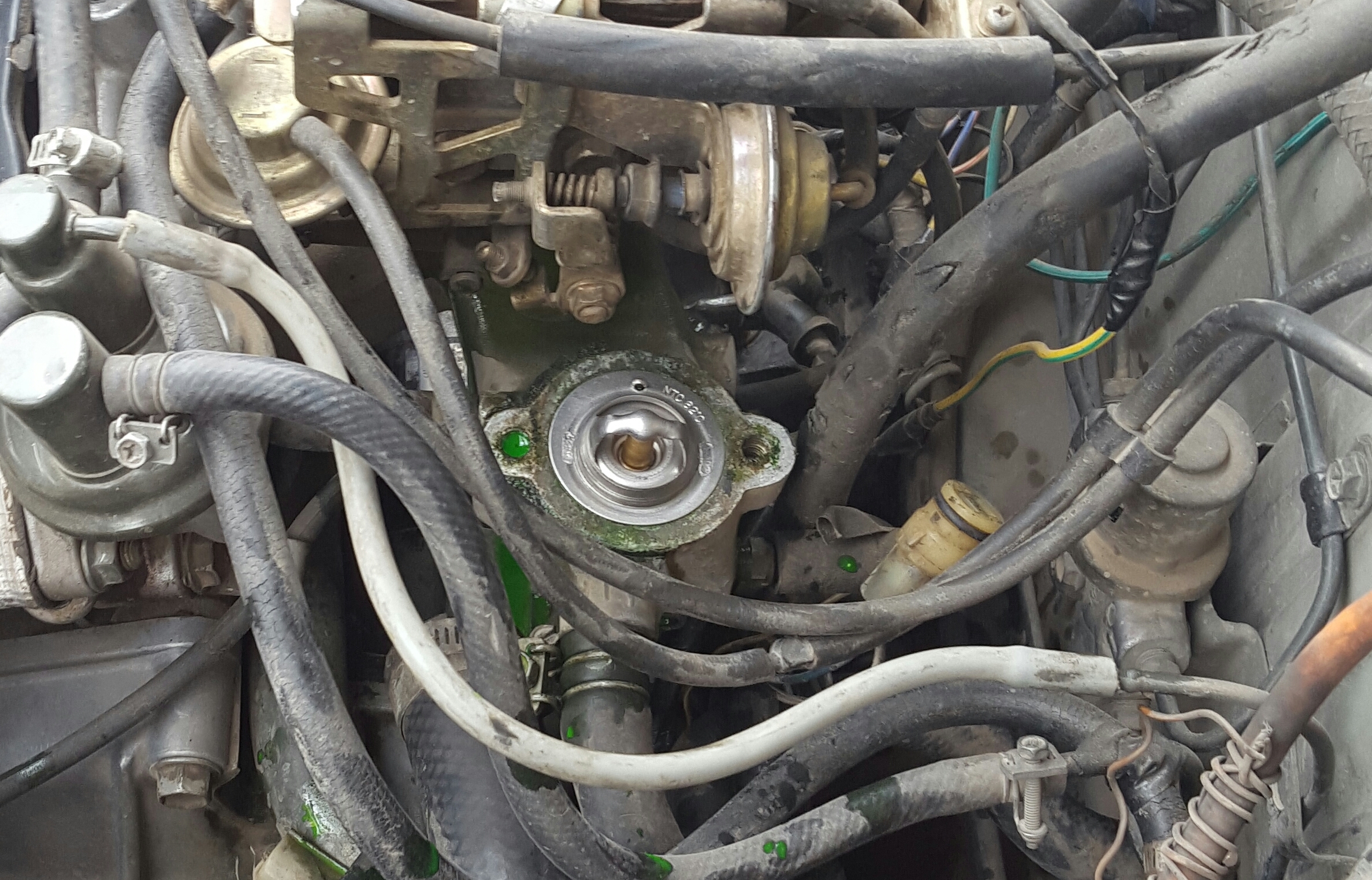

sir any good mechanic in islamabad or rawalpindi?jo t valve laga dy maira mechanic agree nhn kr ra t valve lganay ky liyay any plz tell me the total cost of t valve:slight_smile:
Usually mechanics throw it out, it's their favorite job. But when you are installing t-state valve beware and check flow of coolent when t-state open or close. Because if there is air lock or close loop is block you will end up with blown gaskit.
The Denso one was available for Rs. 700/-Any mechanic can install it, its not a difficult task in Khyber.

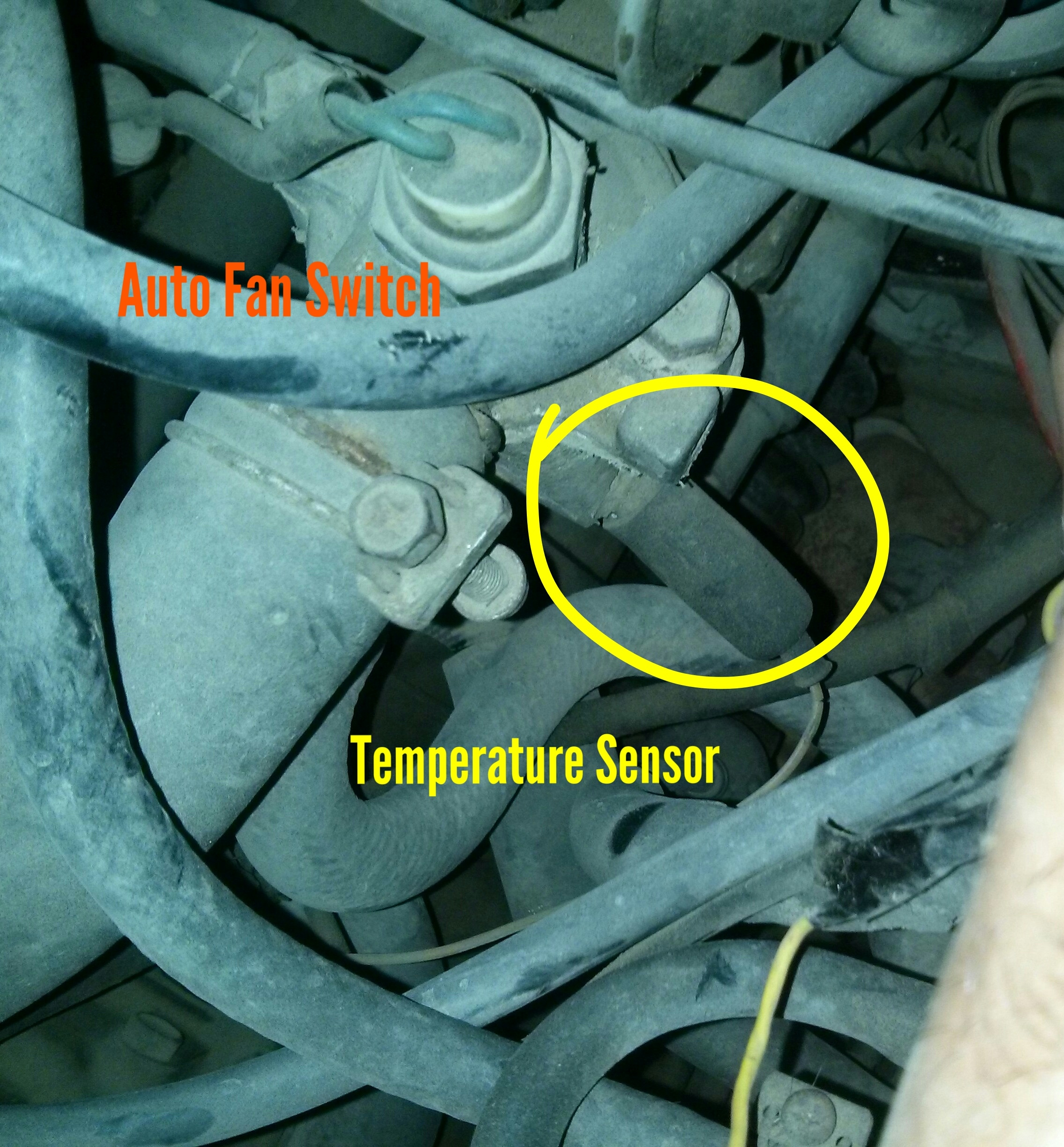

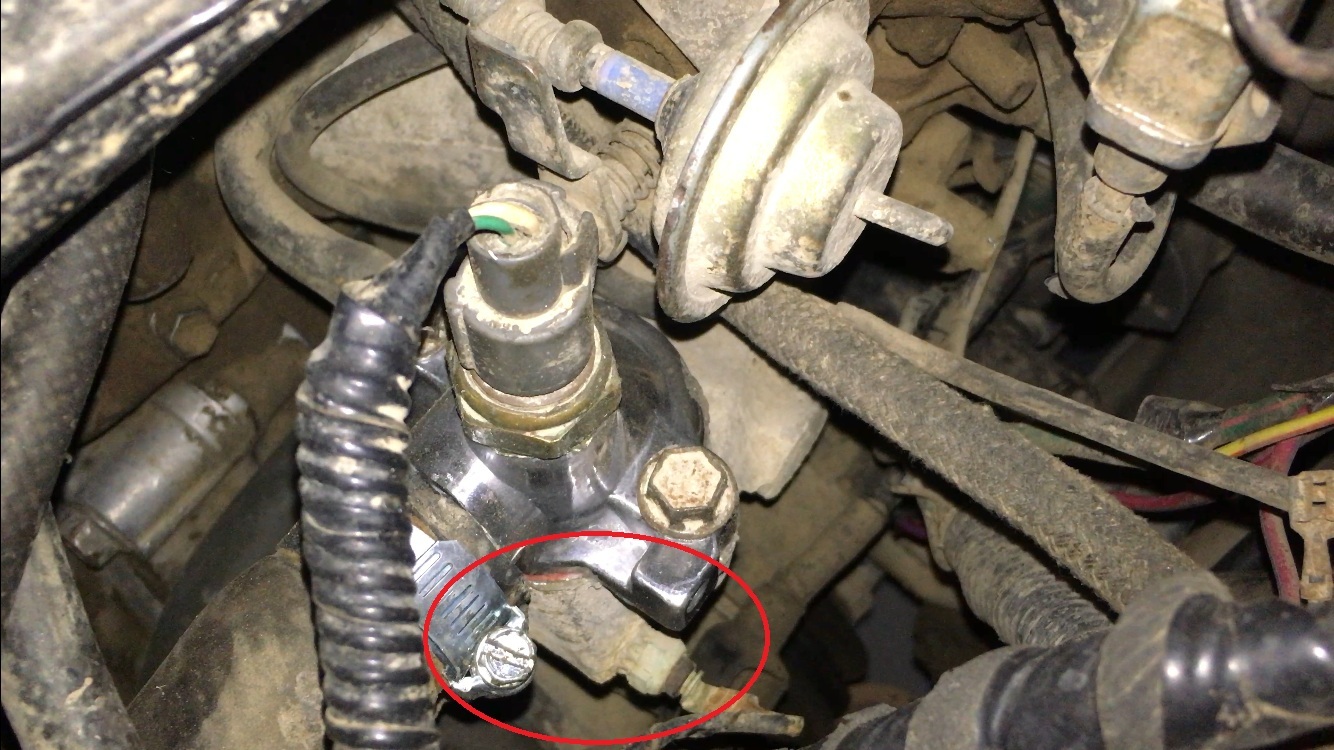

SalamCan any body point out where is this Temperature sensor located in engine in suzuki khyber ??
It is at thermostat housing back.Follow the upper radiator hose to engine you will find the thermostat housing.
Underneath this housing ??
Here it is, yellow one is sensor and orange one is radiator fan switch.
Thanks sir.
I think mine has gone bad.
Simply turn ignition ON, and connect this wire (usually yellow) to ground directly. You will see temperature needle going all the way to full mark. This will confirm weather sensor is bad or a wiring issue.

sir agr pahly sy thermo valve nhn lgi ho and abhi lagao tu temperature kitna increase ho ga ?mainy new engine bnwata ta and temperature wali needle py koi farak nhn parta halki si upper jati hy agr abi t value lgwao tu needle kitni upper jayay gi?
Actually different temperature gauges have different readings but if the temperature gauge is genuine, the temperature should not exceed 50% mark.
