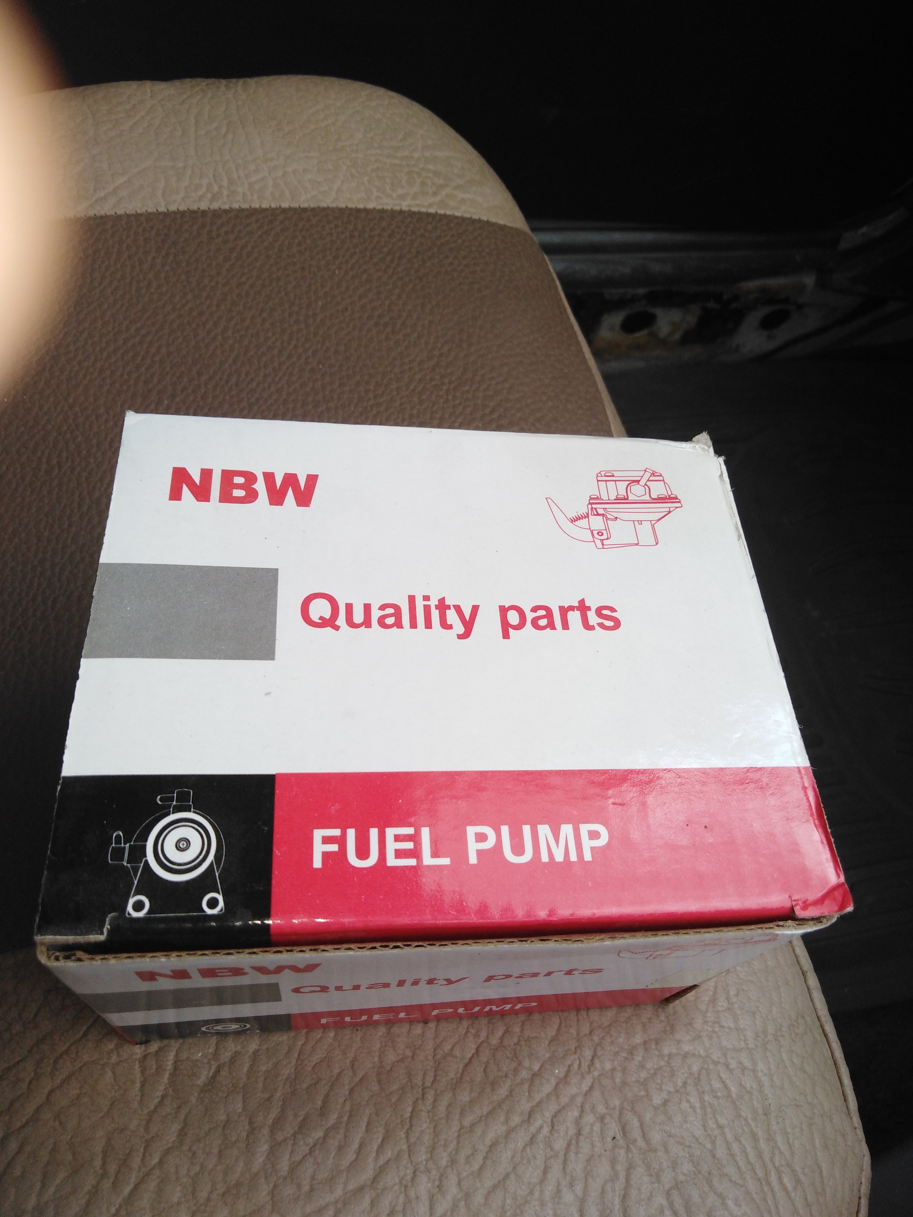

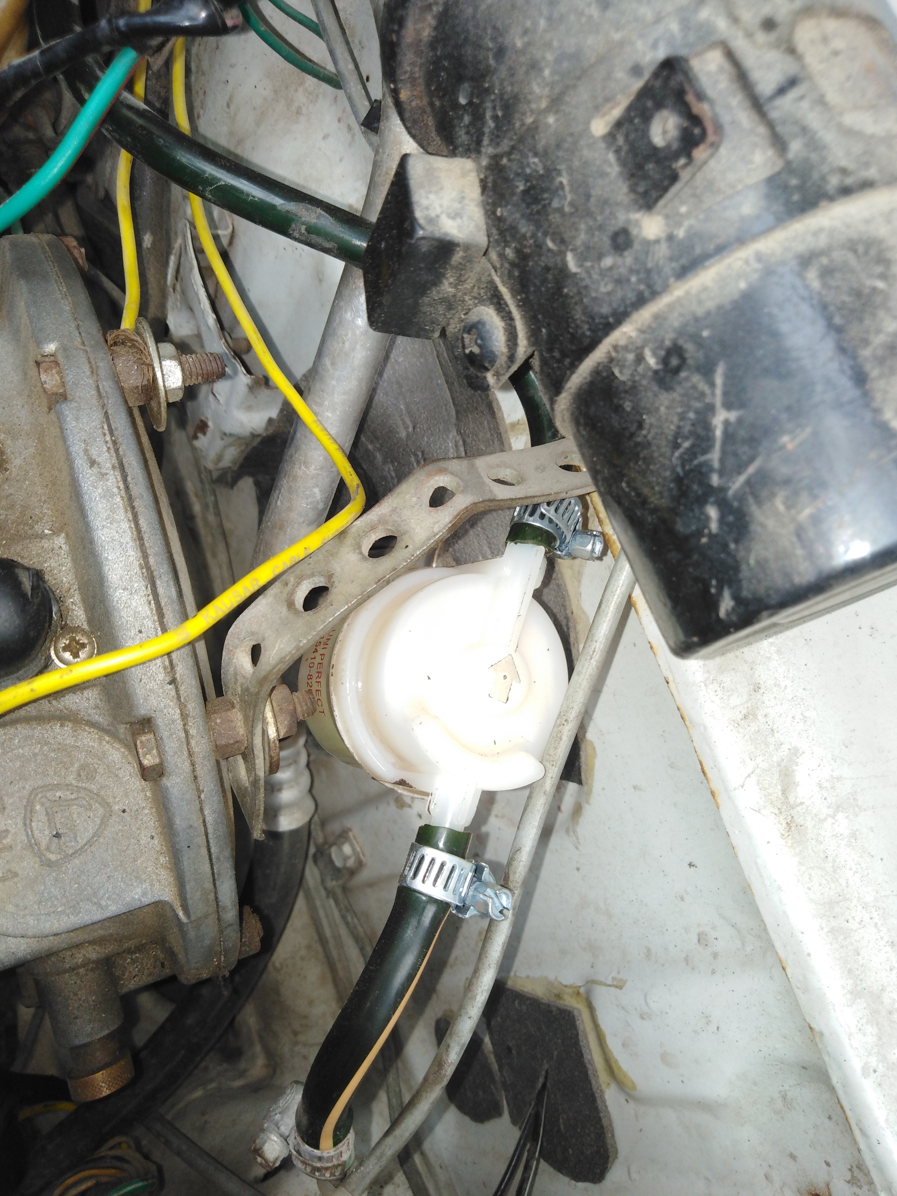

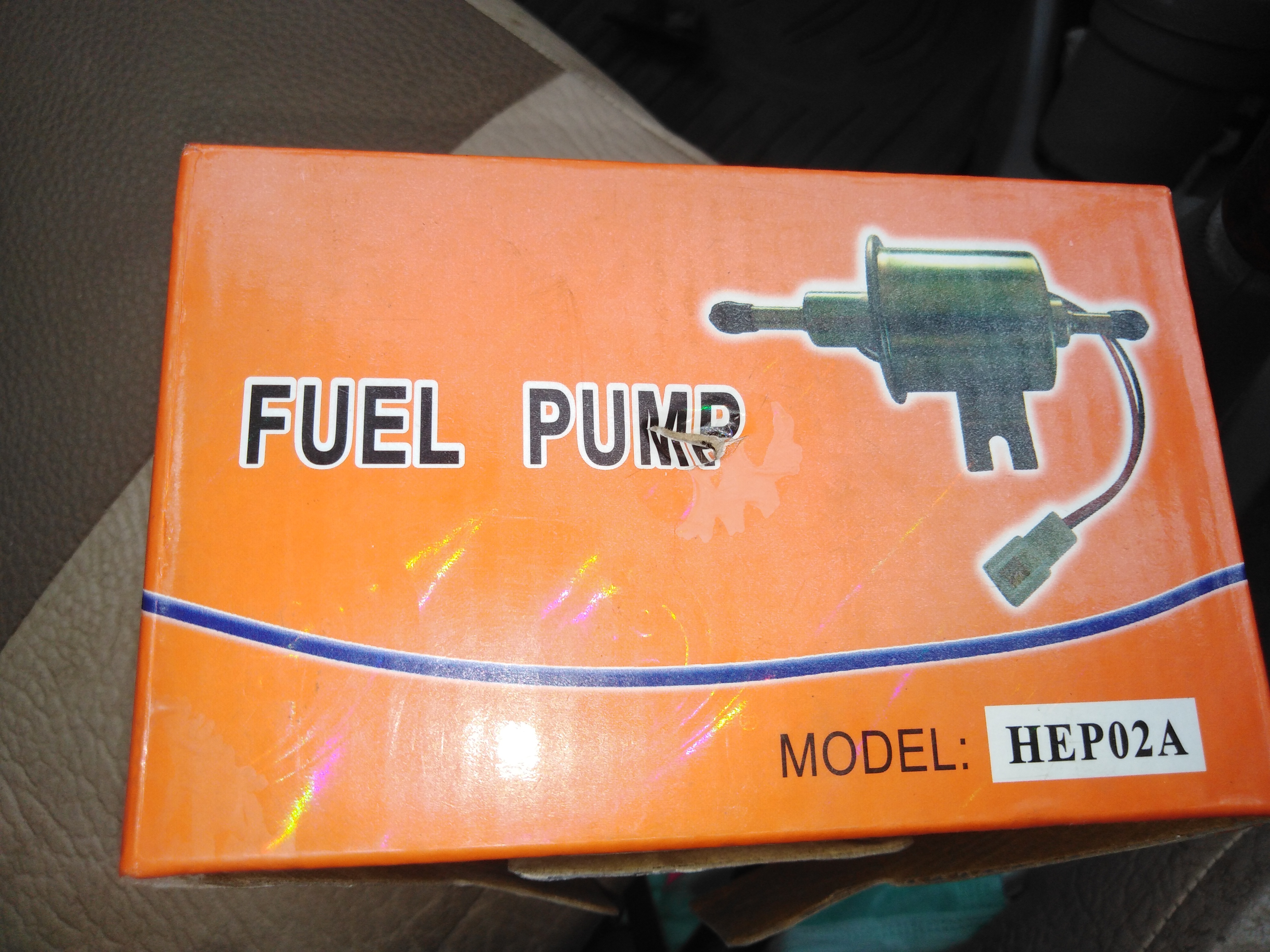

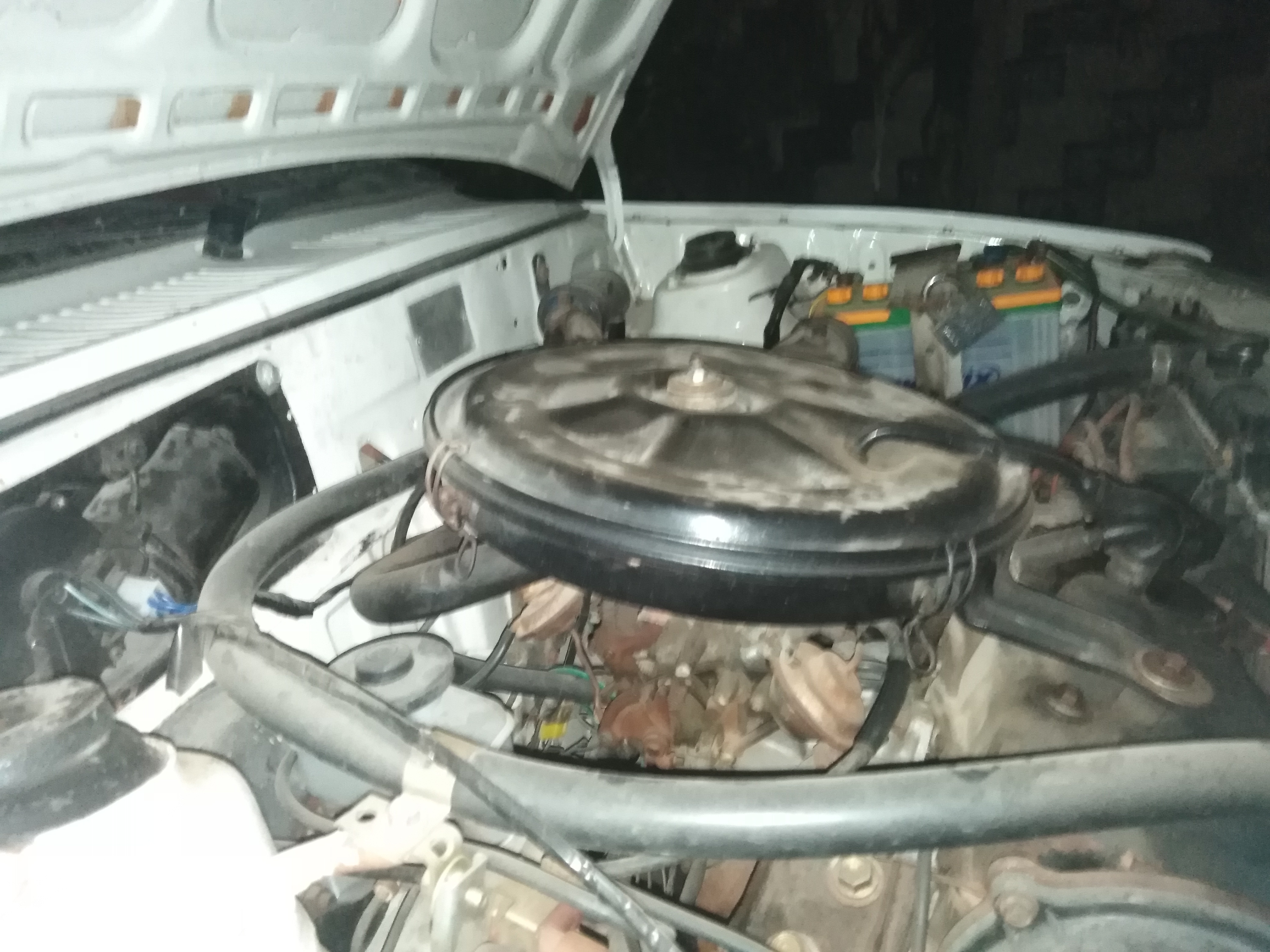

What is your suggestion, as my current electric fuel pump is faulty so i have to replace it soon.
This time, should i go for same electric pump (In-line type) of some better brand or put new mechanical pump (Out-line Type).
I have read from some threads here in pakwheels that in carburetor cars, if you will drive on CNG fuel then mechanical pump will fail soon as it does not cut off its operation when car gets converted from Petrol to CNG so its continous operation will cause issues and consequently damaging it
while in electronic pump, it cuts off its operation as soon as car gets converted from Petrol to CNG & restore to original operation when car gets converted back to Petrol from CNG. Is it correct or myth?
1 workshop told me that nowadays, mostly in-line chinese electric fuel pumps are failing because their flow rate is 70 or 80 Litre per Hour while recommended Free Flow Rate for sa 310 original carburetor is at least 105 Litre per Hour
