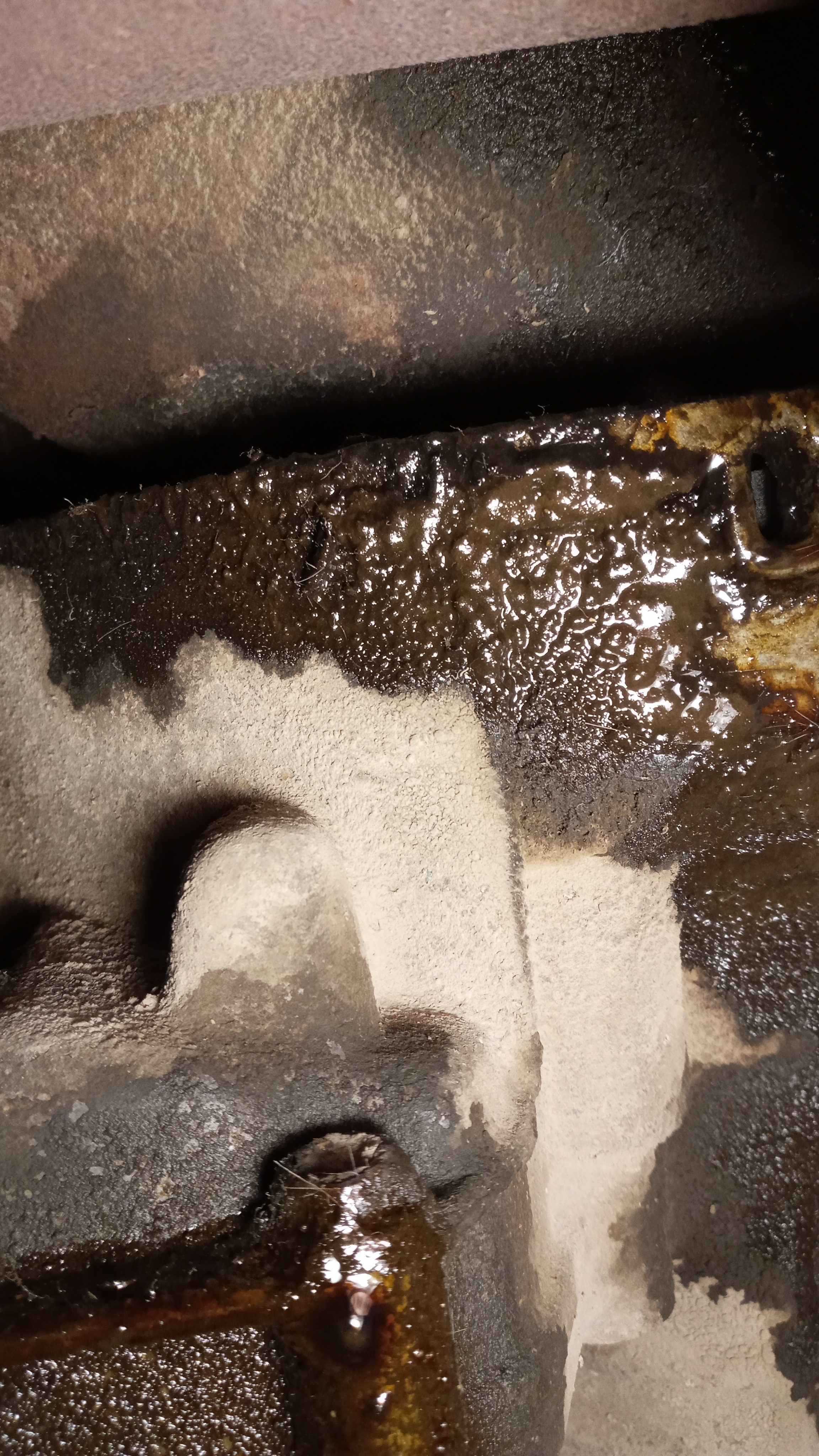

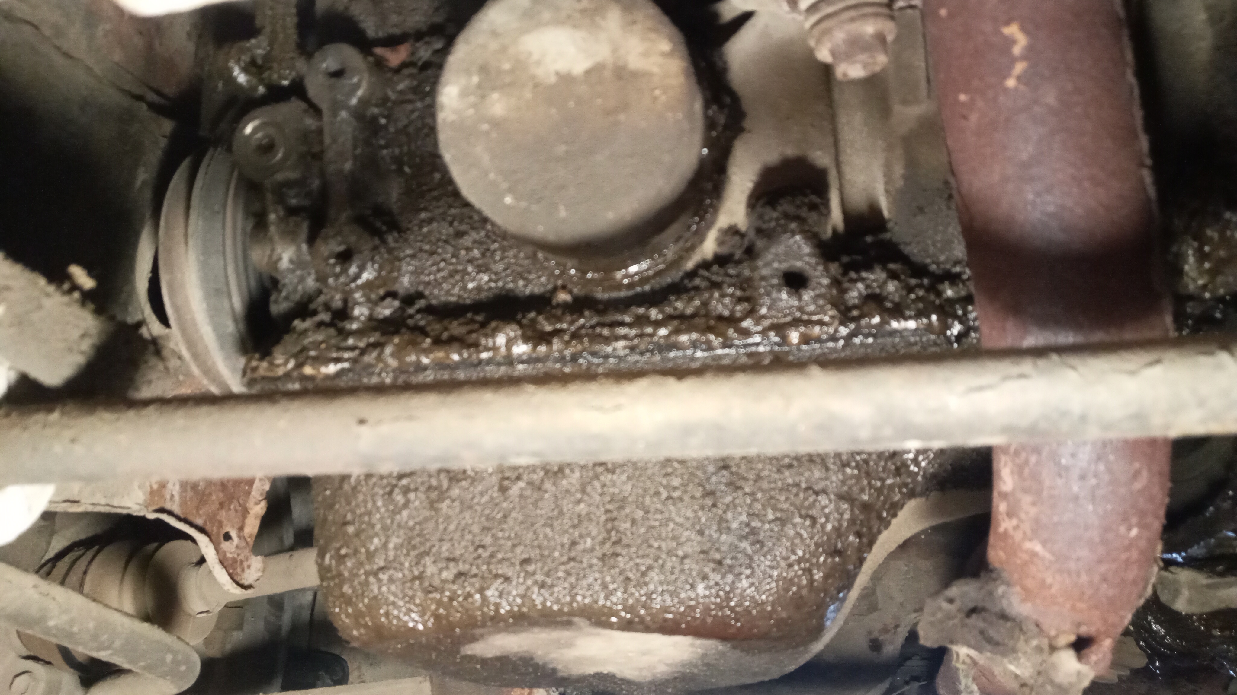

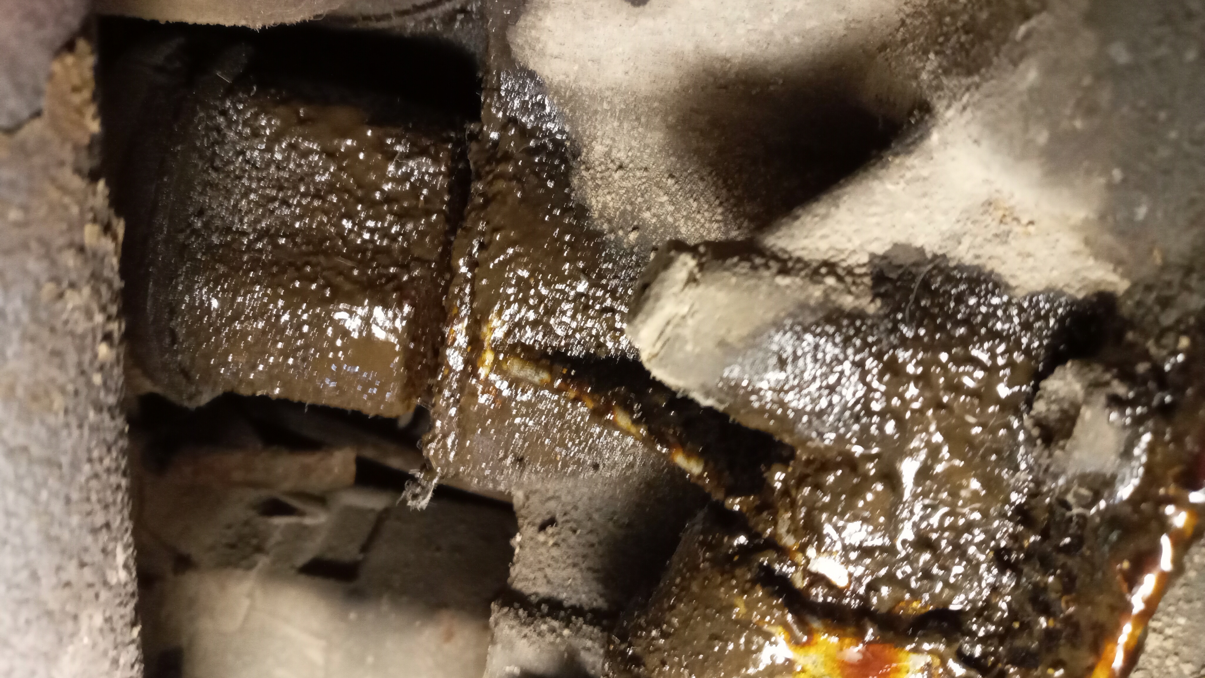

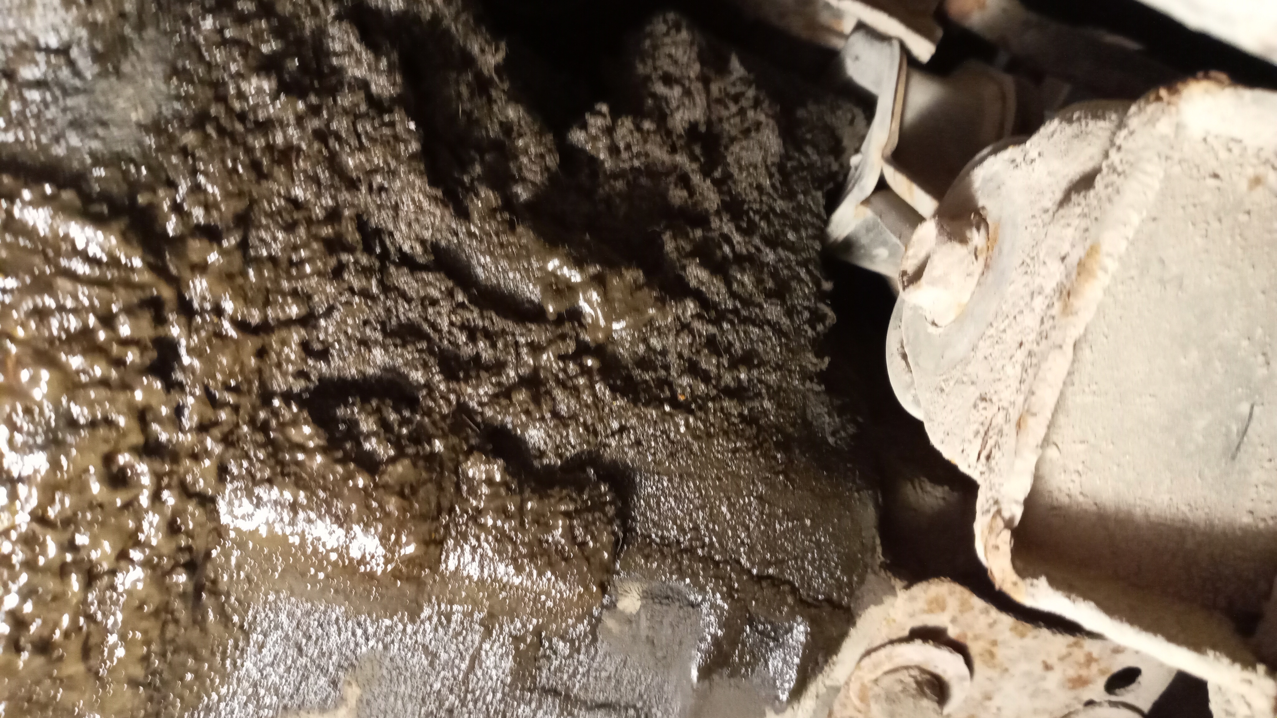

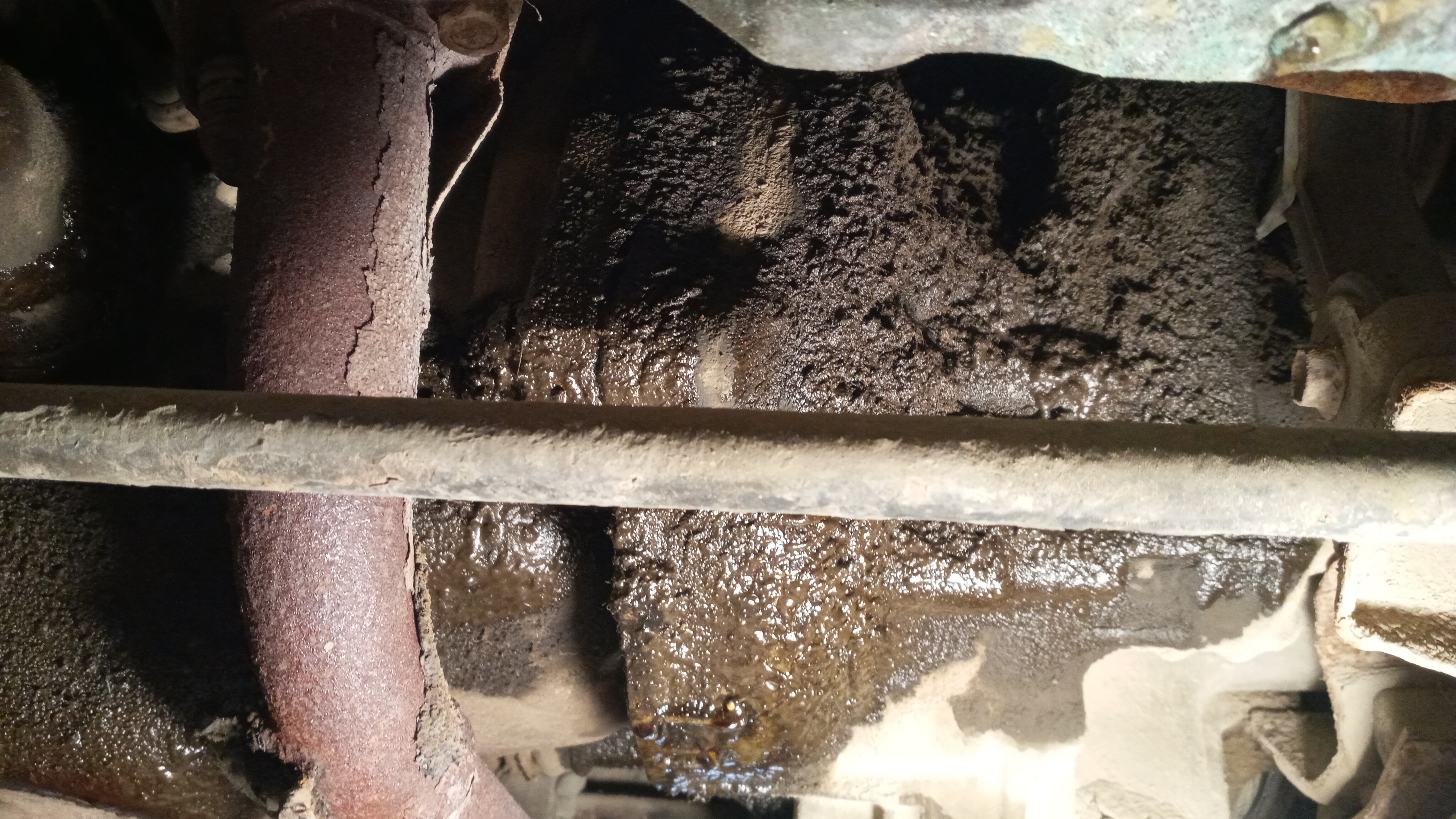

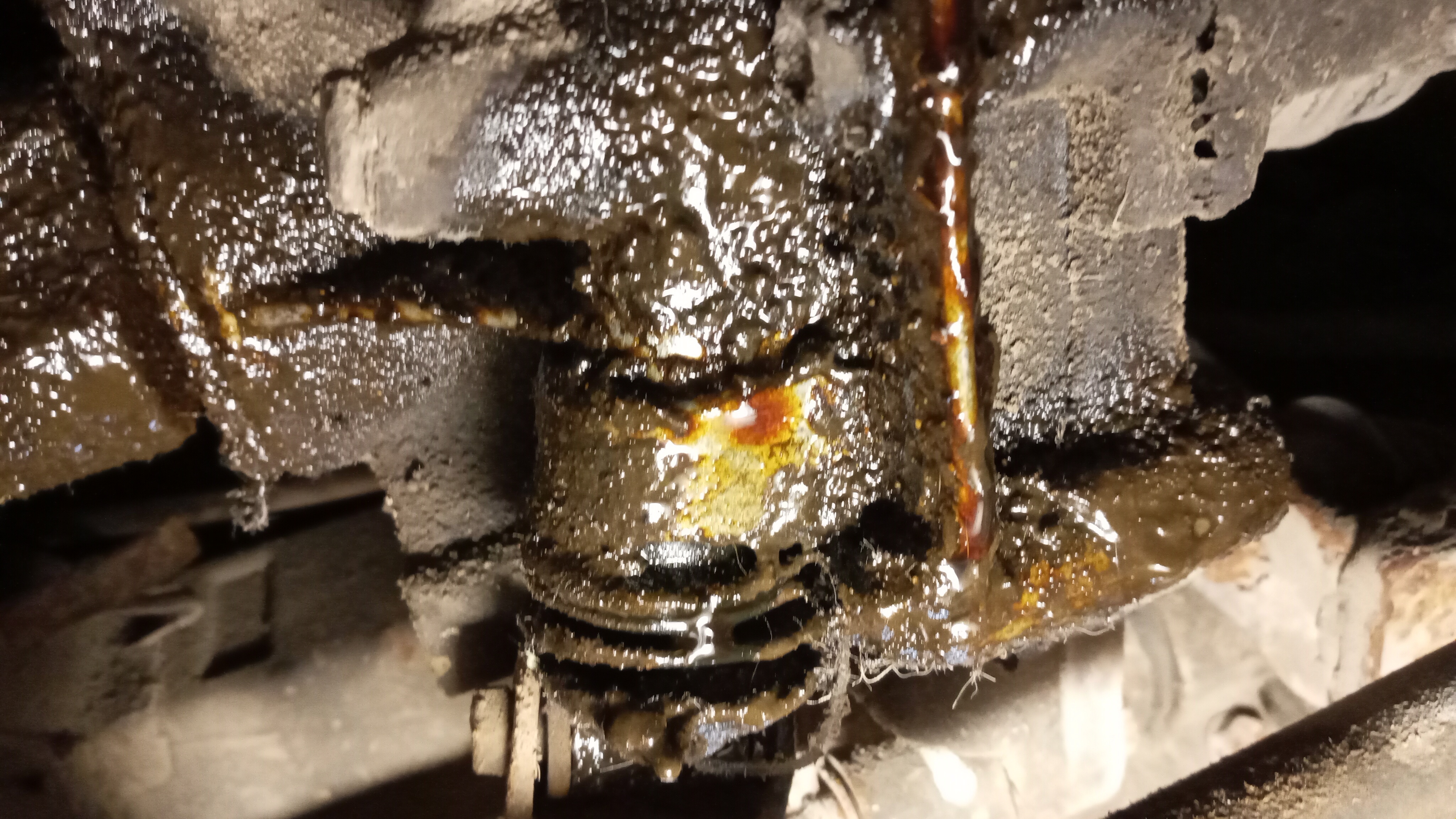

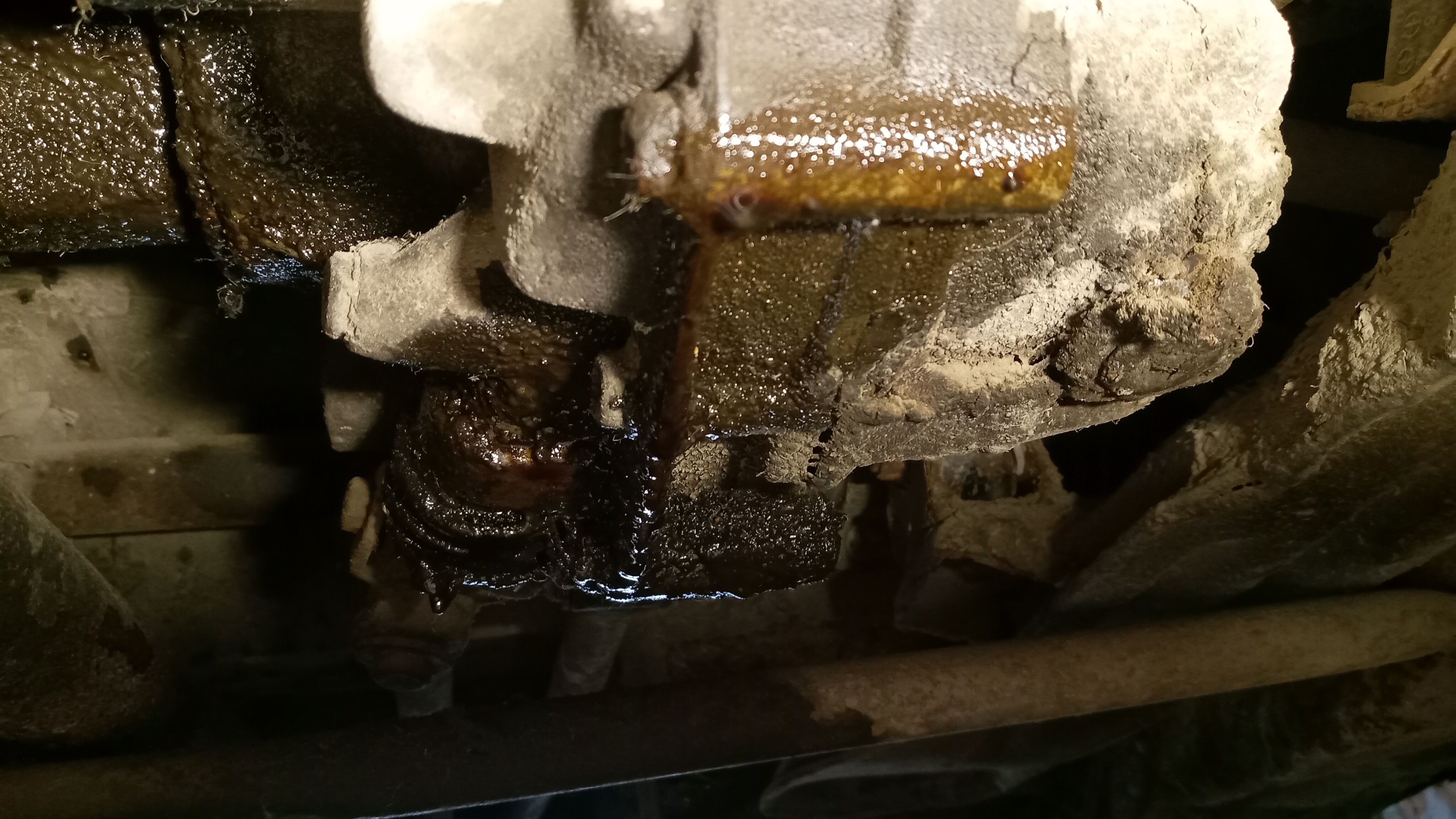

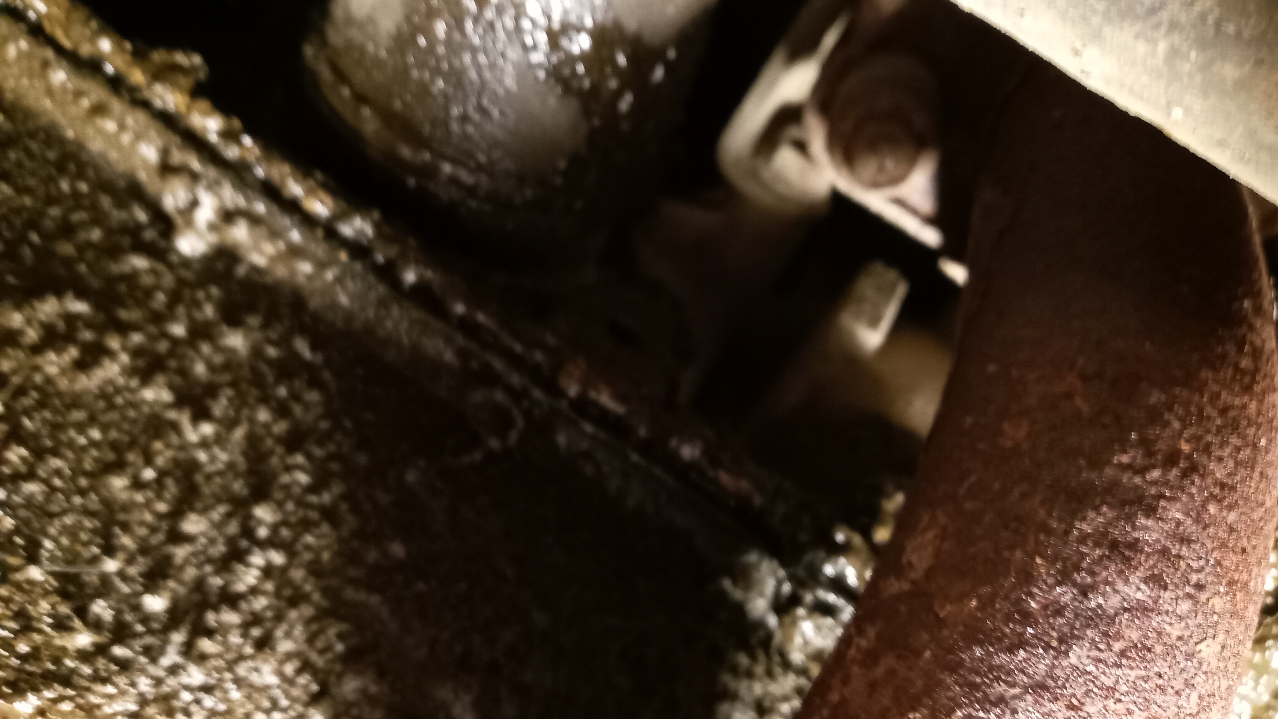

For Issues 1 to 4, you have to immediately change pcv valve and get your engine fully serviced from top as well as from bottom and under carriage side then get proper engine flush with only proper designated Flush oil instead of making it customized or localized one.
After it, you will get clear picture which seals are damaged and other components of Engine to be replaced
