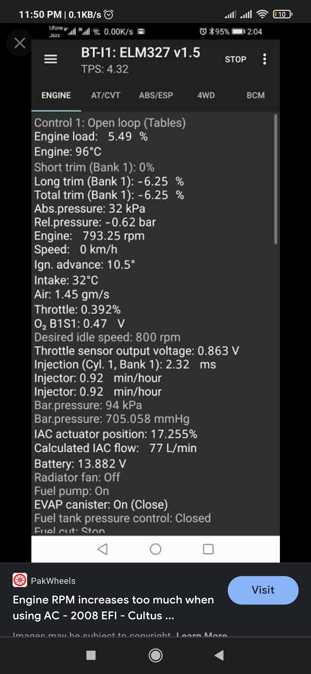

Isky lye apki fuel supply ka pressure low ni hna chaye, injector ko clean krwaen aur fuel pump ka pressure gauge sy check krwa ln wo low ni hna chaye. Short trim long trim ki value oxygen sensor deta h usko b clean krwaen aur working m hna chaye. Vaccum leak b ni hna chaye aur fan auto hna chaye phir ye values achieve hti hn. Good pickup aur fuel average k lye engine ka compression test krwaen aur TP sensor k voltage 0.82v krwa ln. Share your scanner values to find issue
