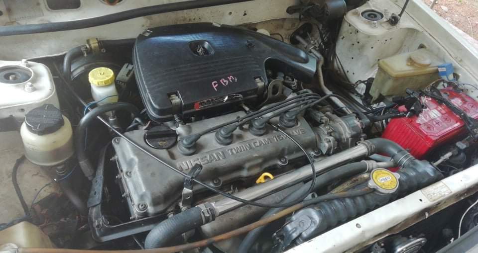

Wiring is not the issues relating to GA15DE.
It is the fuel pump if you are planning to swap it in B13. The electrical one do not work well, which they usually provide it with. The proper remedy for that is that you have to install B14 petrol tank, which has in-built fuel pump and fuel guage, otherwise, the fuel pump installed outside will vapor-lock itself and give you problem in starting. All I am talking about is GA15DE.
Regarding power, it is great. I can easily touch 150 km/hr on GAS with AC, yes, with AC and mind you my AC is also the Denso one what comes original with it and takes a lot of load.
So, you can guess other things yourself.
