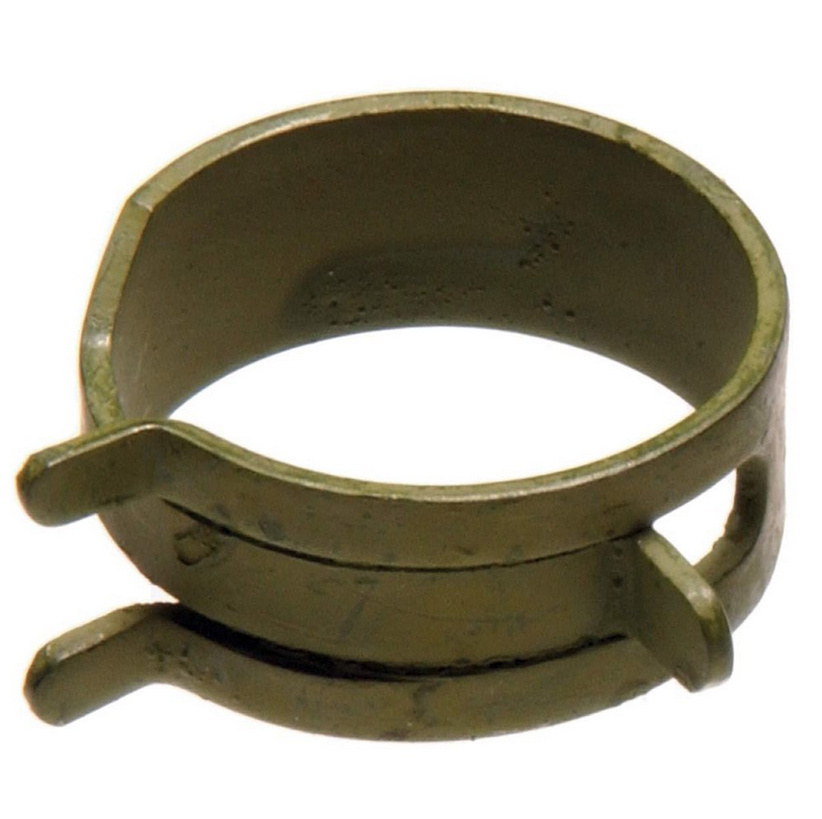

I've encountered a lot of "mechanics" talking about using worm gear clamps on cooling, oil, etc. hoses because they allegedly perform better than spring clamps.
On the other hand, you'll often see OEM hoses using a spring action clamp, like so:
Now, I don't buy it.
A spring clamp seems to distribute clamping force evenly across the circumference of the hose, reacting to expansion and contraction of the material with temperature changes.
A worm gear clamp, by design, would bite harder on one point on the hose and would not evenly distribute clamping force. This effect would only grow worse as a hose expands and contracts.
I would assume that after completing several thermal cycles, the clamp would begin to cause a leak or even bite into the hose and breach it.
Many mechanics, like politicians, learn to confidently lie through their teeth to maintain business. I suspect that worm gear clamps are only used because they are adjustable, low cost, and don't require getting the sizing right, not because they offer any particular advantages.
What do you think?
