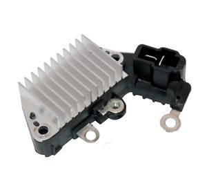

boss i was having same issue with my mehran 2016 model. When starts its show 13.8 and then on full load it goeas to 10.3 or 10.5. it consumed my car battery in 15 months.
i changed the new battery 38 amp instead of 30 amp standard battery. but still the problem was there even when driving in night when compressor starts the horn goes down and the car feels heavy.
my electrition told me to change the alternator because the built in original alternator of mehran doesnt bear the required load. so he put some kabli generator which was different in shape from that of mehran but the fitting was bolt on.
Now after installing that the volt stays between 13 to 14 on full load which i think is sufficient. the horn and lights function correctly. (i am using 100/90 watts headlight bulbs instead of the original 65 watts)
