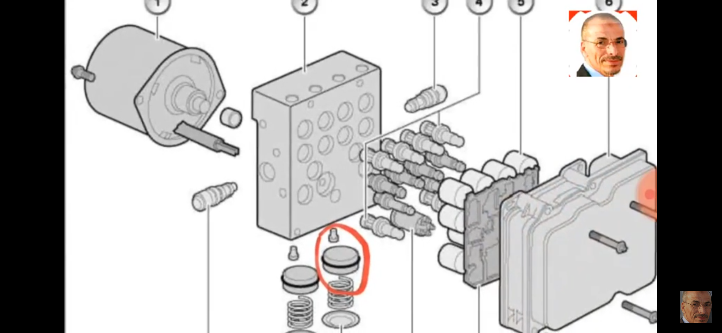

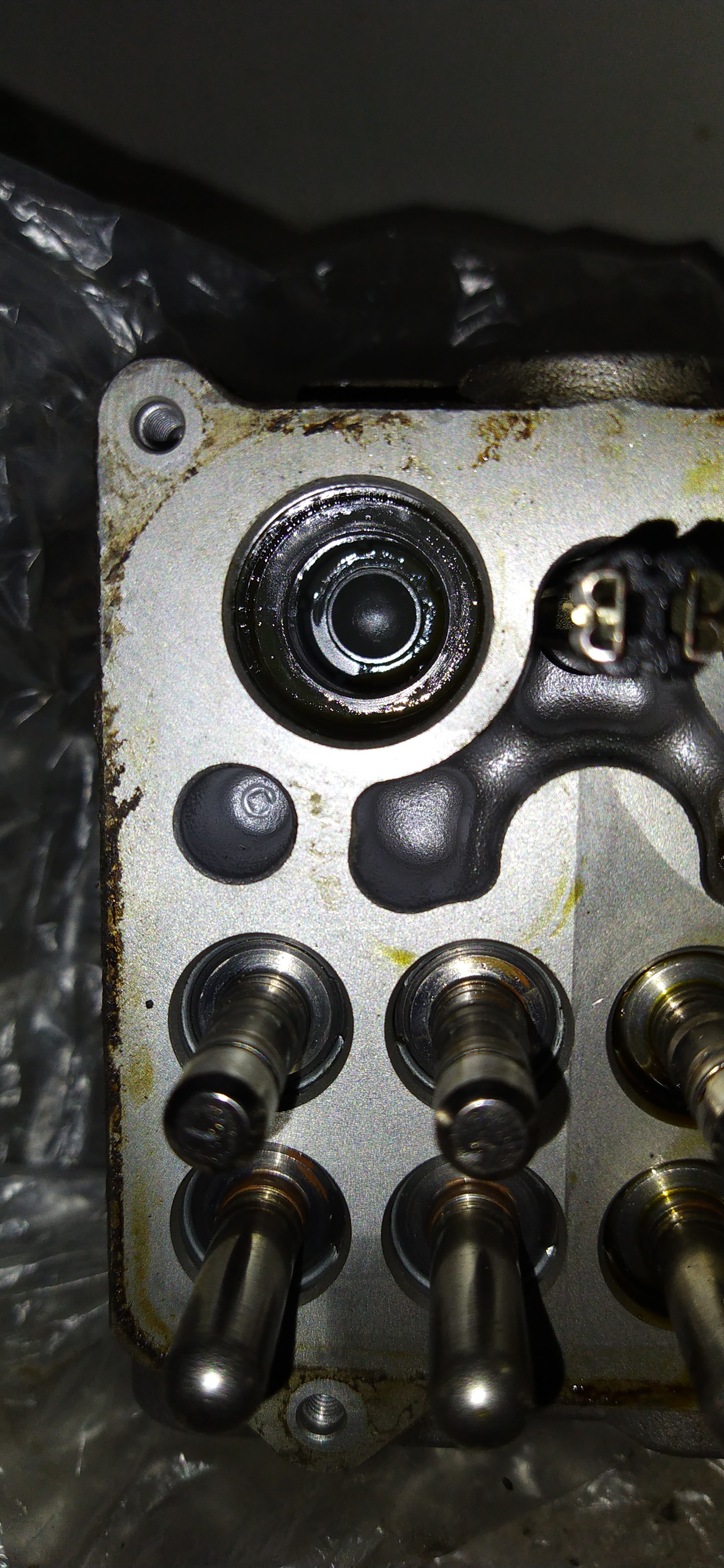

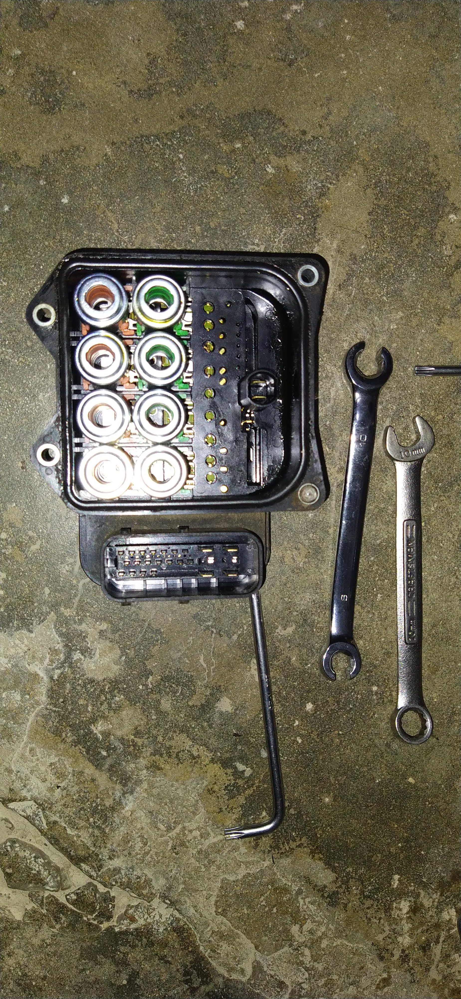

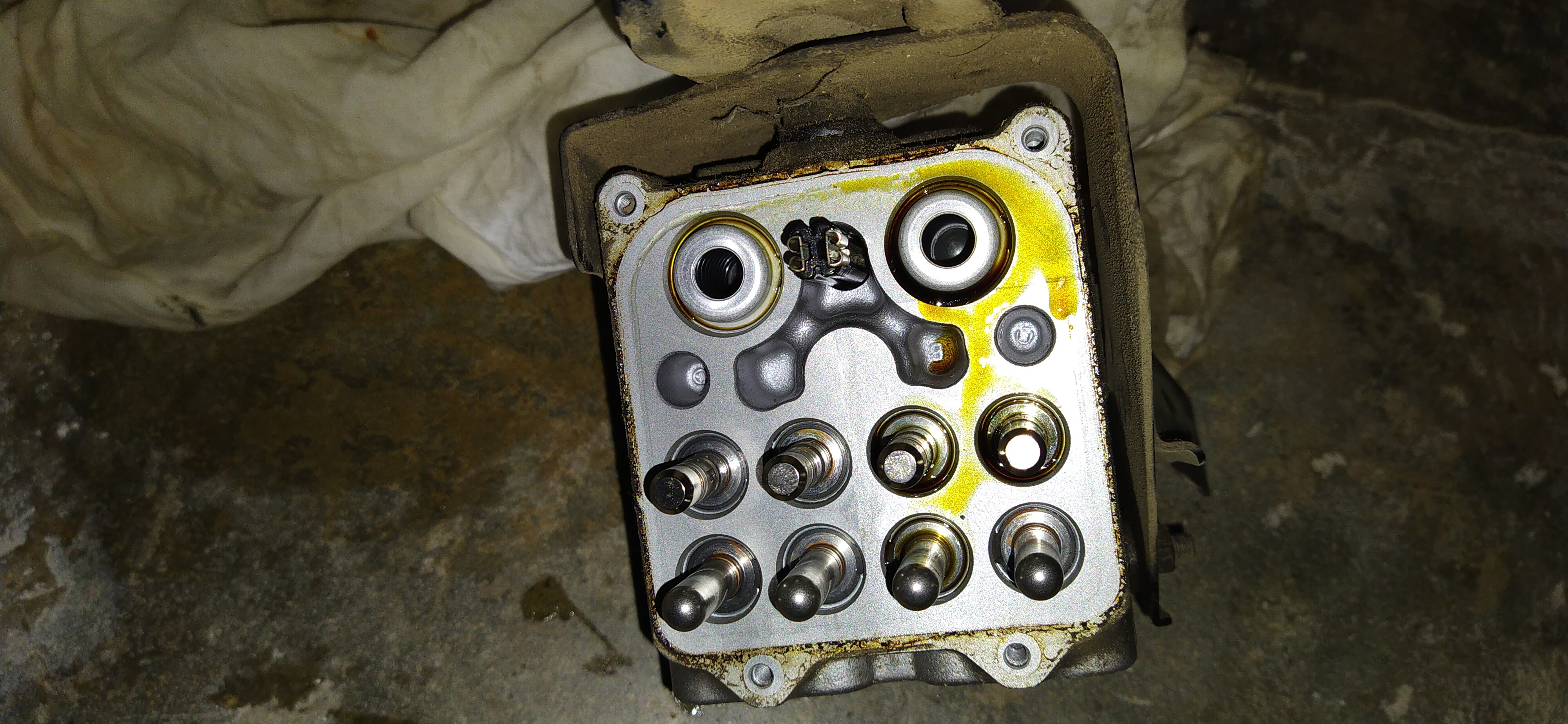

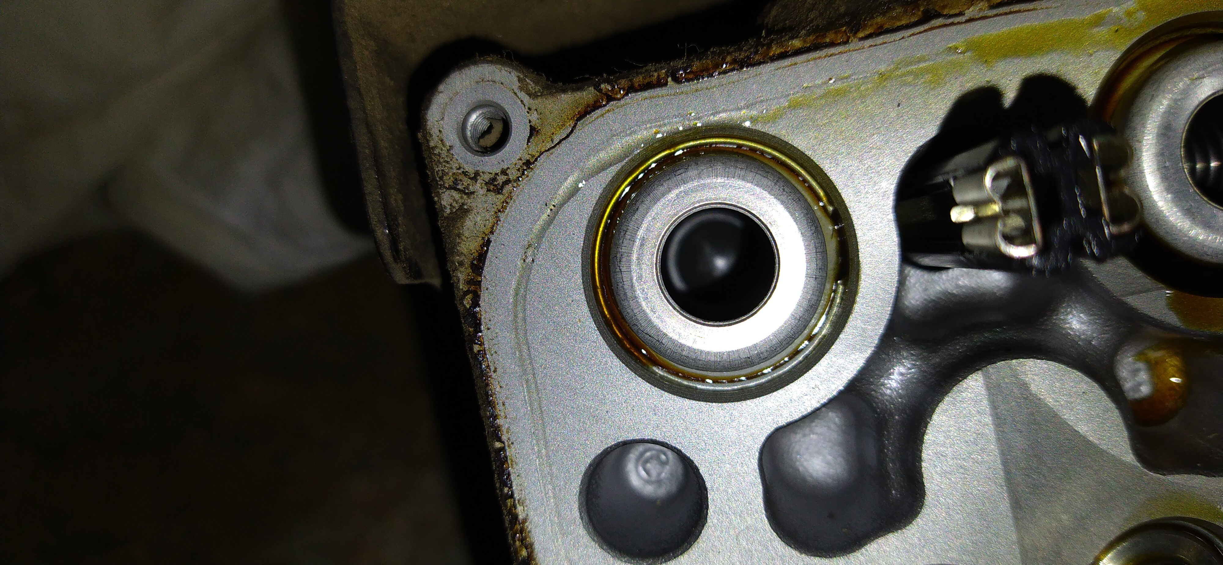

Searched around on internet and people were having similar issues, a video pointed that it could be the ABS.
Will be updating the proceedings in below posts.
