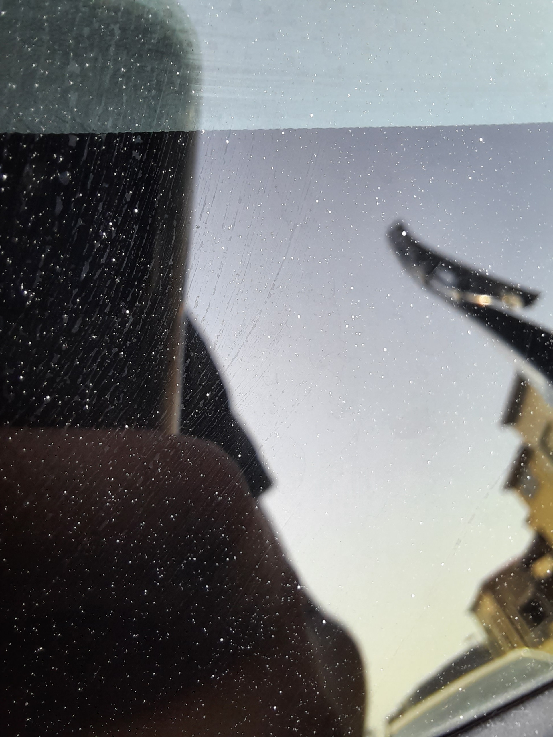

Aoa. Today after a week i decided to wash my car at home. When i was drying the car, i felt some dust particles (metal particles or glittery particles) sticked on my car paints surface and on windows. Its giving a really rough affect if i slide my hand on it. What is the cheapest way to eliminate those particles and what is the most expensive way to get rid off them. Want to compare. Im attaching some pictures.
Are you sure if these are metal and dust particles? If it can't be cleaned by car wash, then may be its paint.Where did you actually park your car before it happened?
It's not metal its paint fall out. Someone showered a paint and ur car was parked near by. All u have to do is to quickly buy auto scrub it'd max 1000rs from brother Ahmed yar. Use any shampoo and keep doing auto scrub.Don't go for compound with regmar. Don't.

Thankyou all for your kind and helpful advice. Clay bar looks promising to me. Havent heard about auto scrub(will def try that out soon). Ill go for a professional way cuz i dont want to destroy the cars paint job.
I had experienced same things about 03 years back. I got Autoscrub which is a spong clay. It is very easy to use and my paint and glass, everything was smooth once again.
