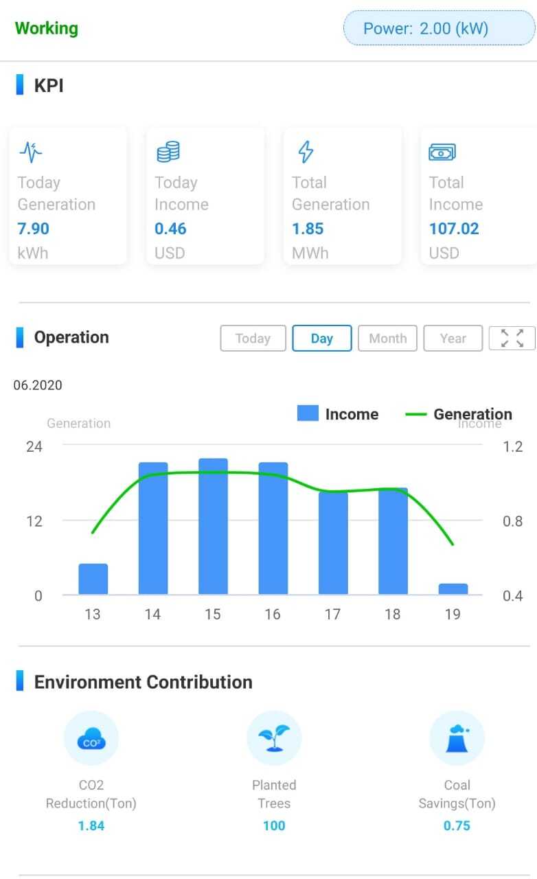

The payment was done on 15 July and the system started functioning on 15 February. That’s a 7 month delay. The majority of this delay was caused by IESCO and NEPRA (about 5 months). I am now using this system for the last 4 months and its working without any problems. It generates 2.6 KW at peak during the midday and total units generated during a sunny day are around 15-20 KWh. In 4 months I have generated 1850 units of electricity. The inverter has a nice app which you can use to monitor the real time power generation. I am attaching a few screenshots of the app.
