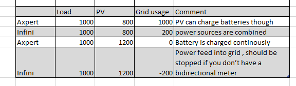

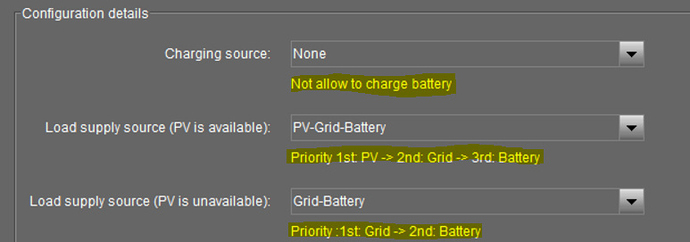

- When I used to reprogram inverters to stop grid feed in , I did not find any power going into grid. Can you share the links where you found this information ? As per my observation, shop keepers dont know how to stop grid feed in, so they end up saying its a stupid inverter
answer to your last question regarding
1) Refer to the user manual for connections
2) When load is greater than PV input , it will switch to grid power. If grid power is not avaliable, it will consume battery. When the battery DoD level is reached, the inverter will turn off. So inshort, the PV power always has to be greater than load. This is why i prefer hybrid inverters
a small summary
