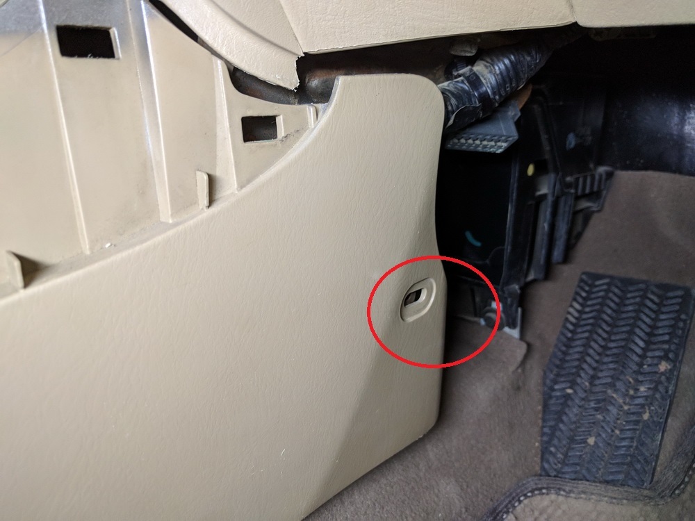

Turns out we have to remove the whole console altogether instead of just the shifter console.
The shifter console is screwed to the whole center console as pointed out by @punjabianz

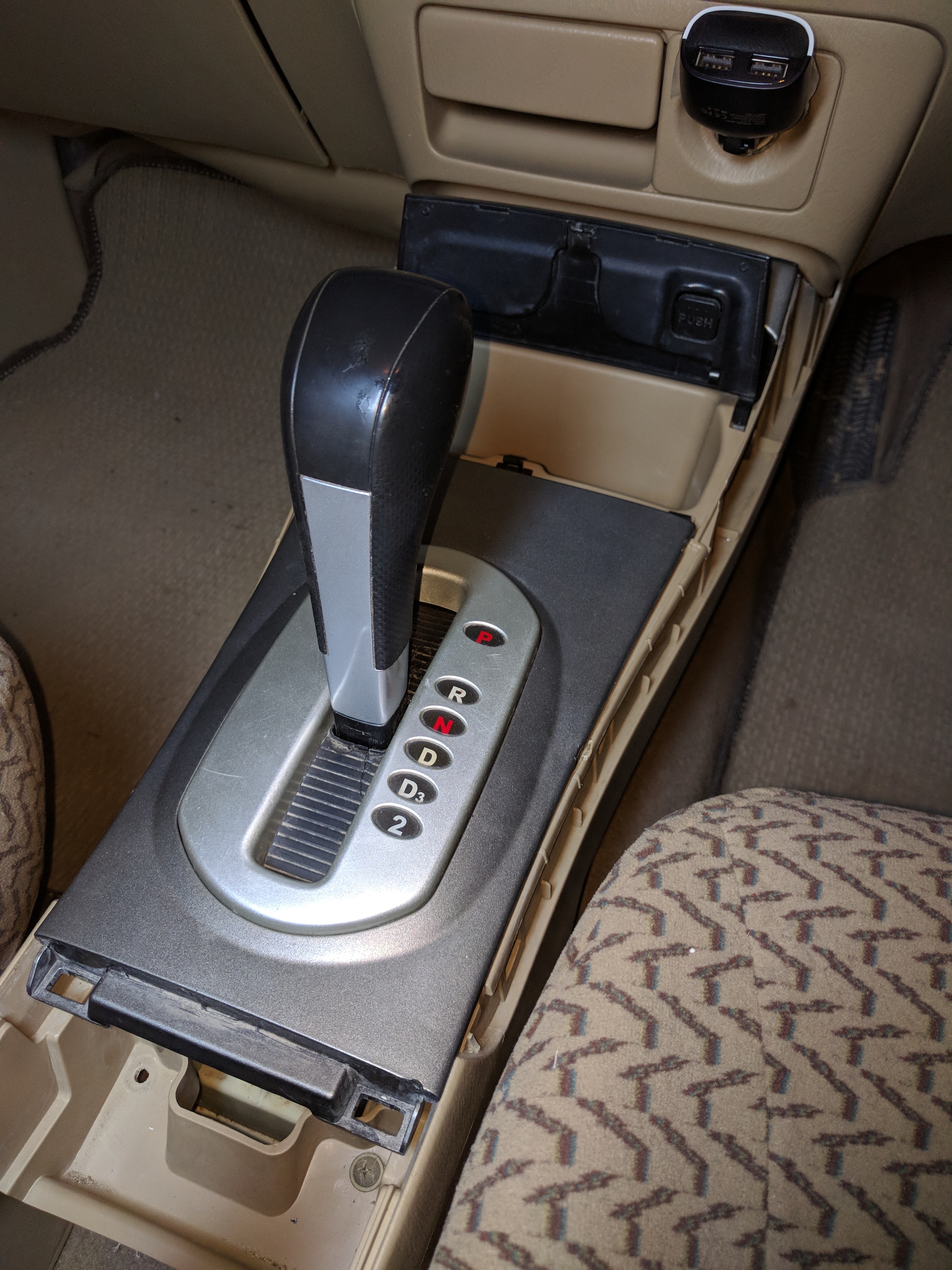

However, shifter knob wasnt required to be removed.

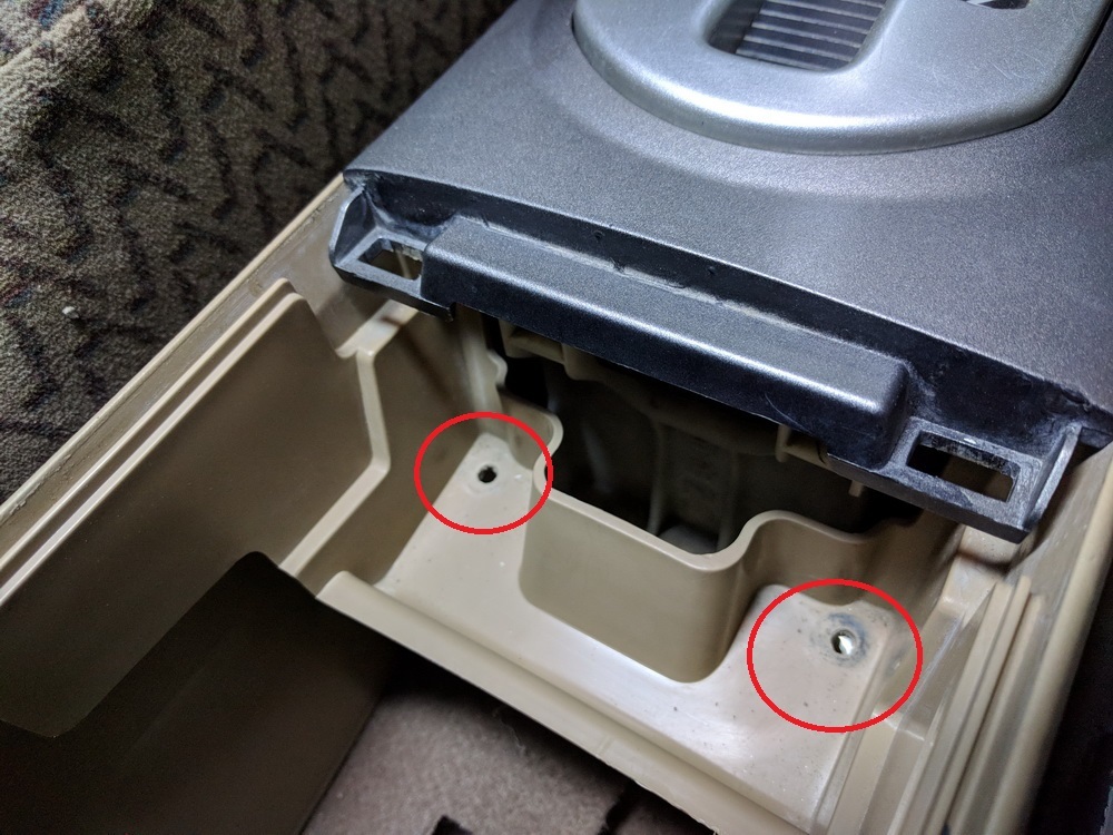

There are total 6 screws that need to be unscrewed.
2 on each side at front.
2 in the middle

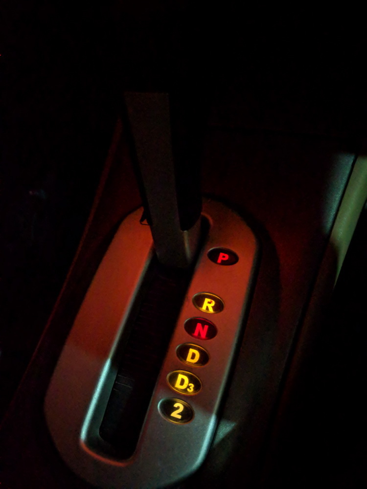

Finally have the shifter lit!
consider the problem SOLVED.
