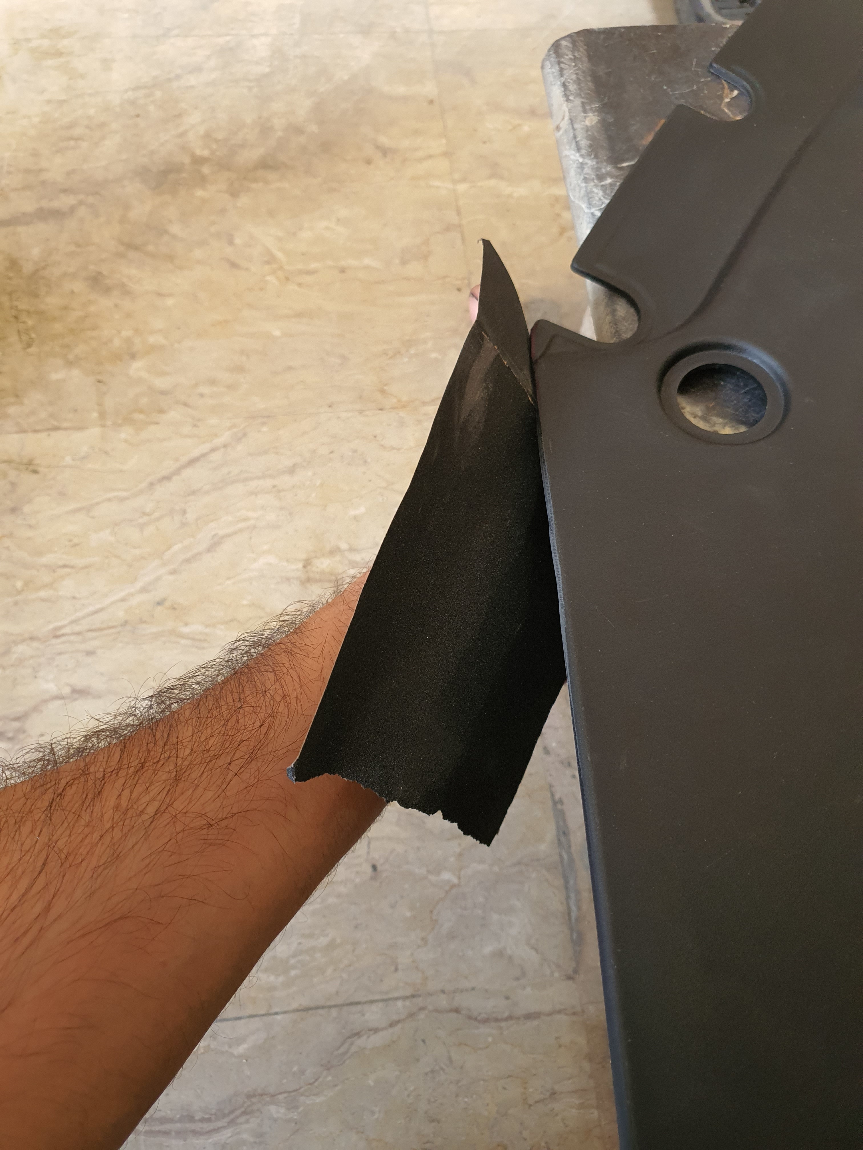

At first I decided to return these But thenI thought to my self.Let's do it a DIY

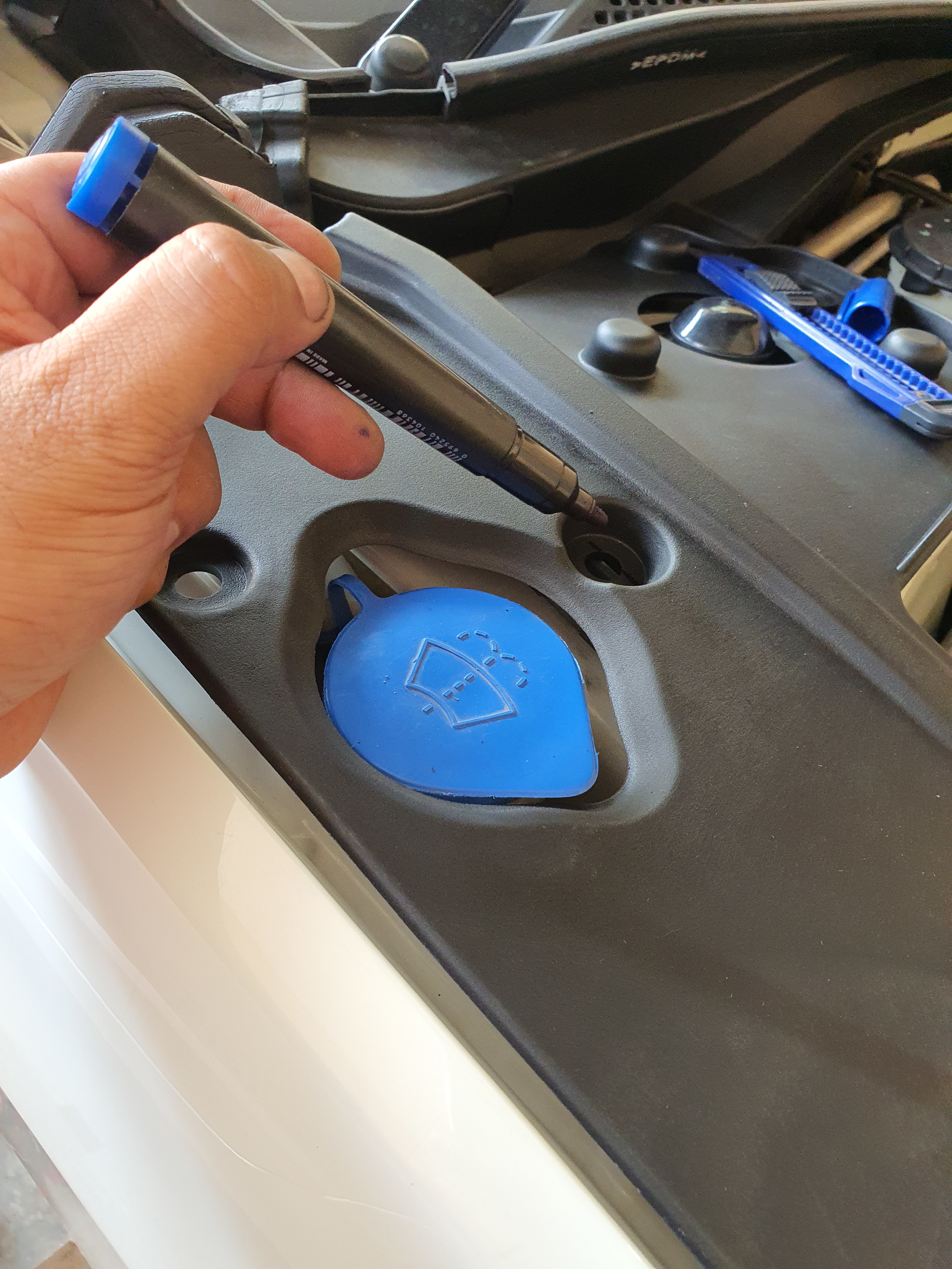

so I marked the extra part with a permanent marker.

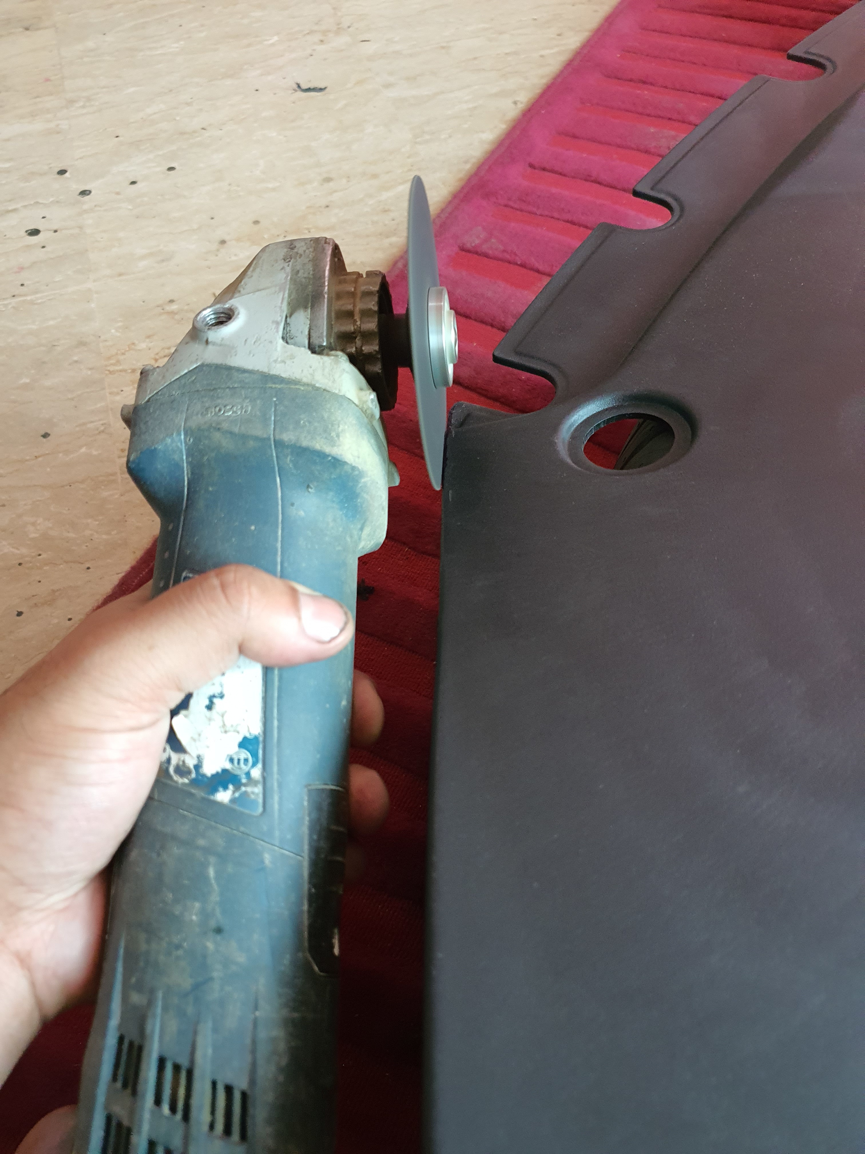

Thanks to Almighty, I had everything at home that I could need for this job.So I picked my the grinder and put cutter blade in it and carefully cut the extra part.I a. Posting only one picture.In practical I cut it in 5 to 7 steps and kept on check after every cut.

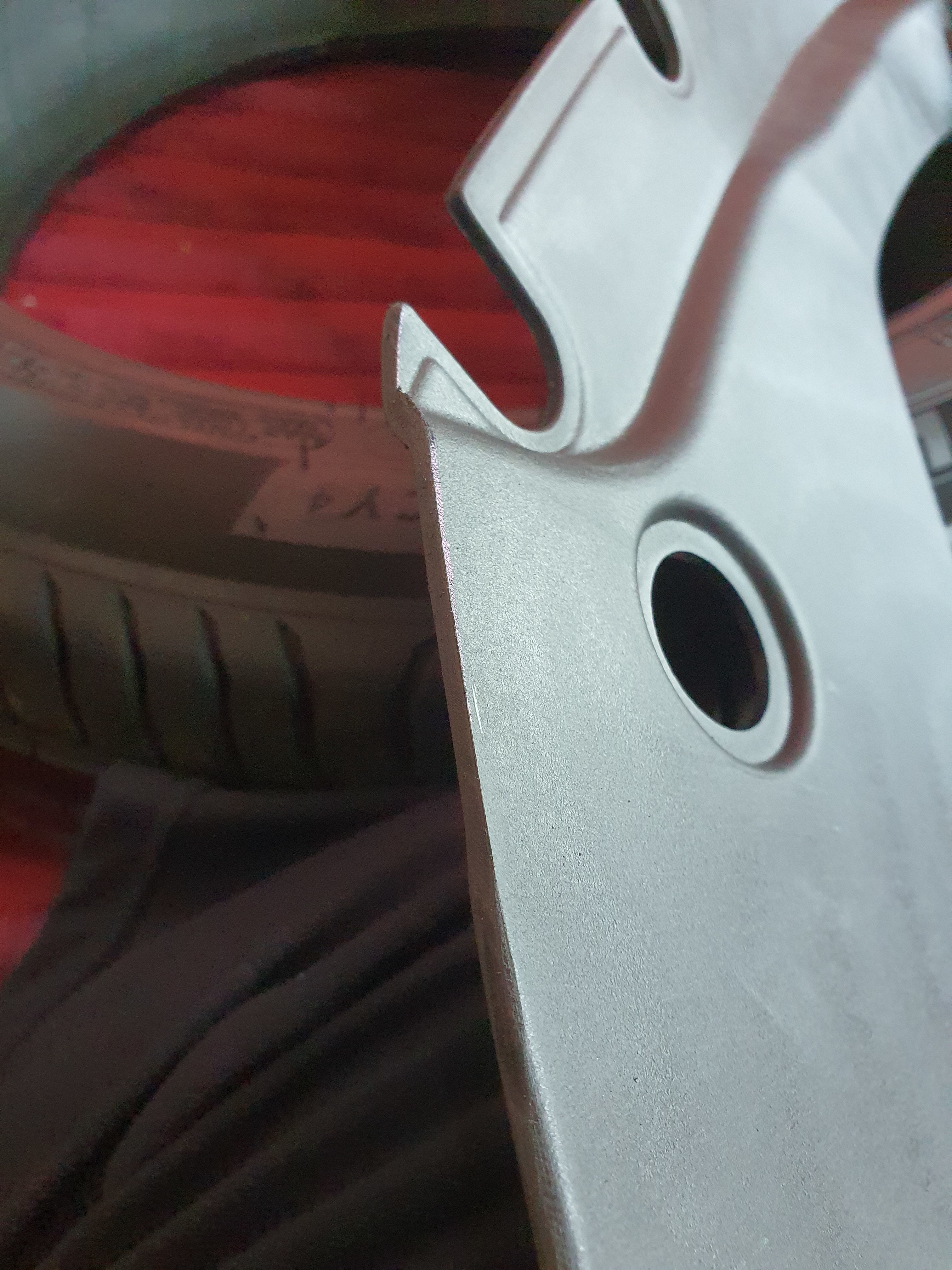

The I used sand paper to smoothen the cutted edge.

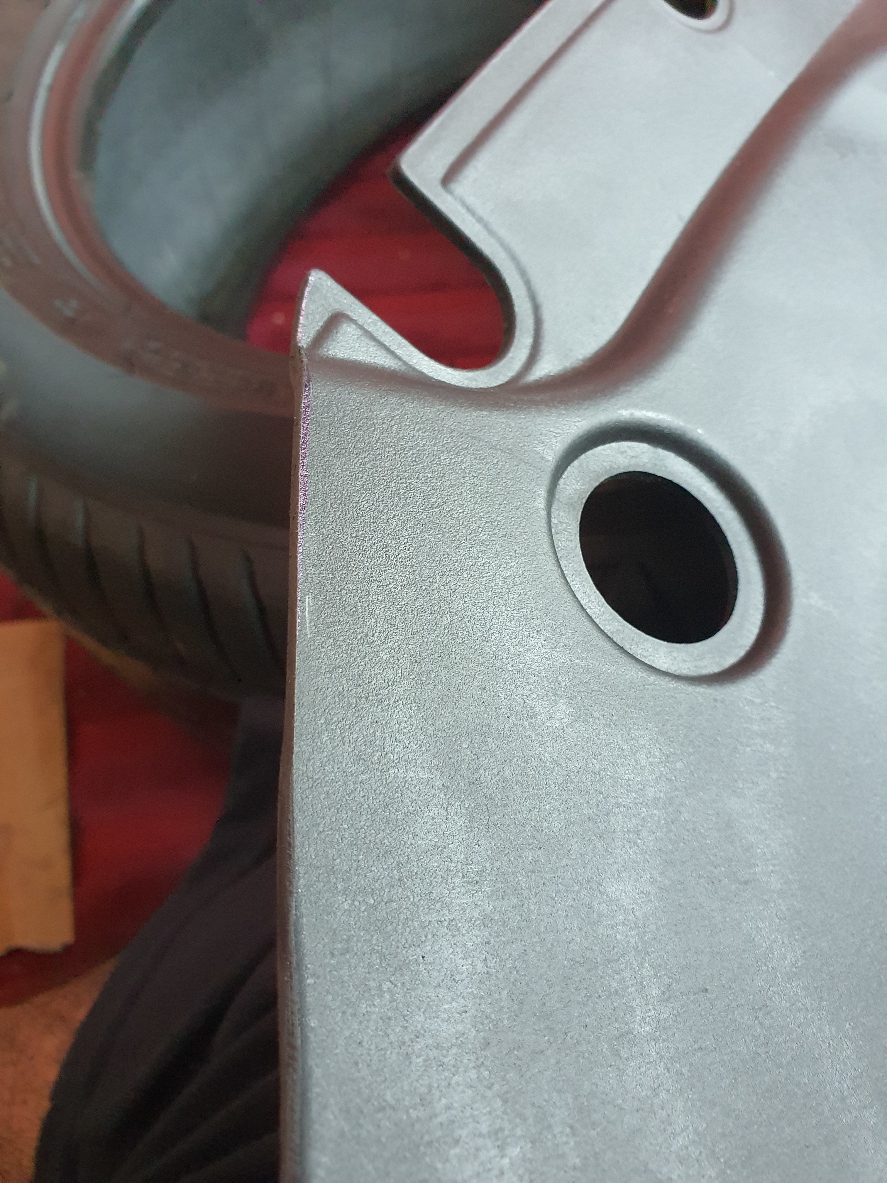

This is the edge picture after cutting and sand paper.

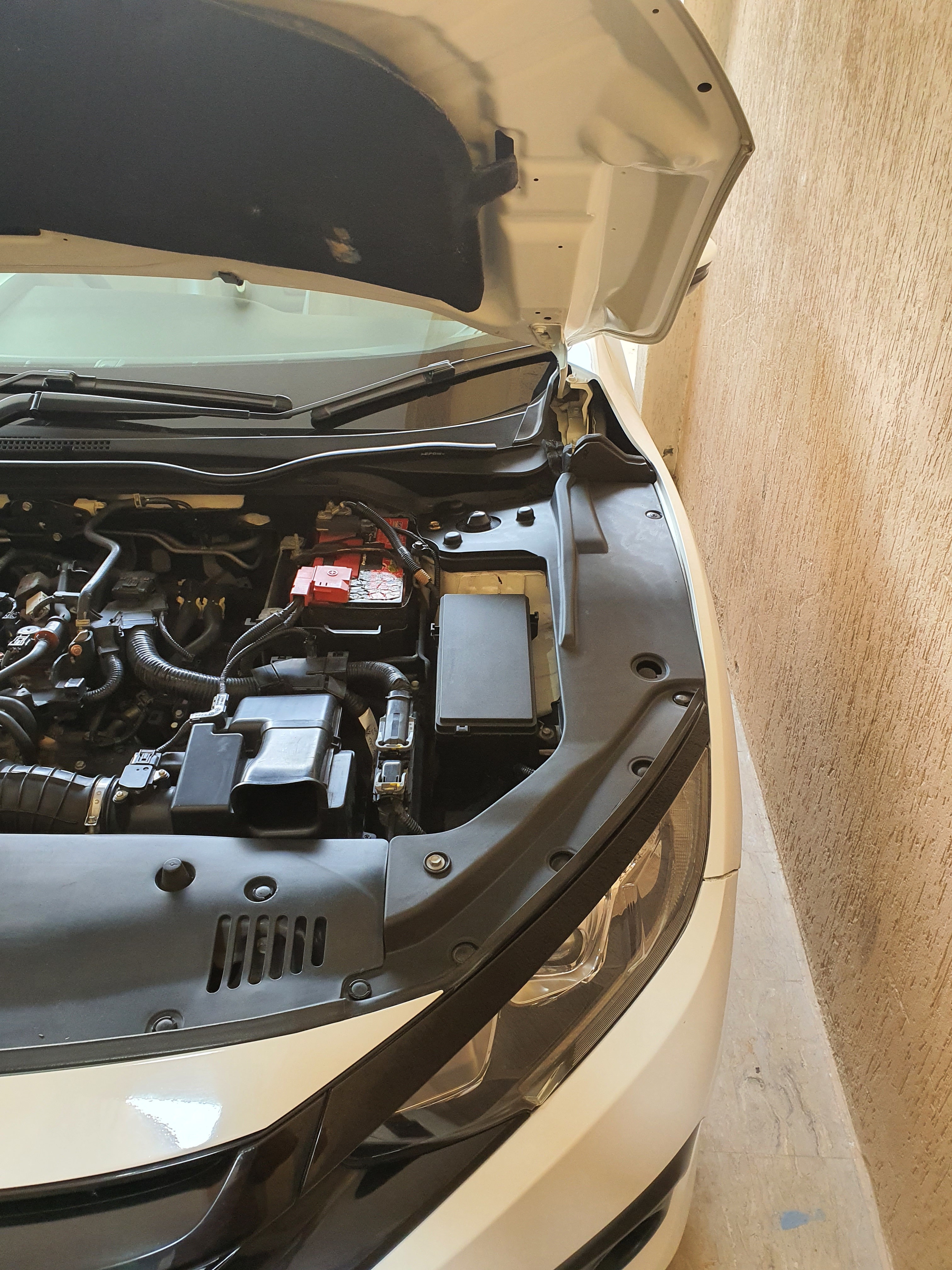

This is an existing bolt that holds the cover..
This is the final outcome of the passenger side cover.
Then when I was about to start for driver side, I faced new challenges.And there I found out that these covers are for left hand steering wheel cars (most likely from China).I will explain the installation and steps along with pictures .For now taking a break.Tea time

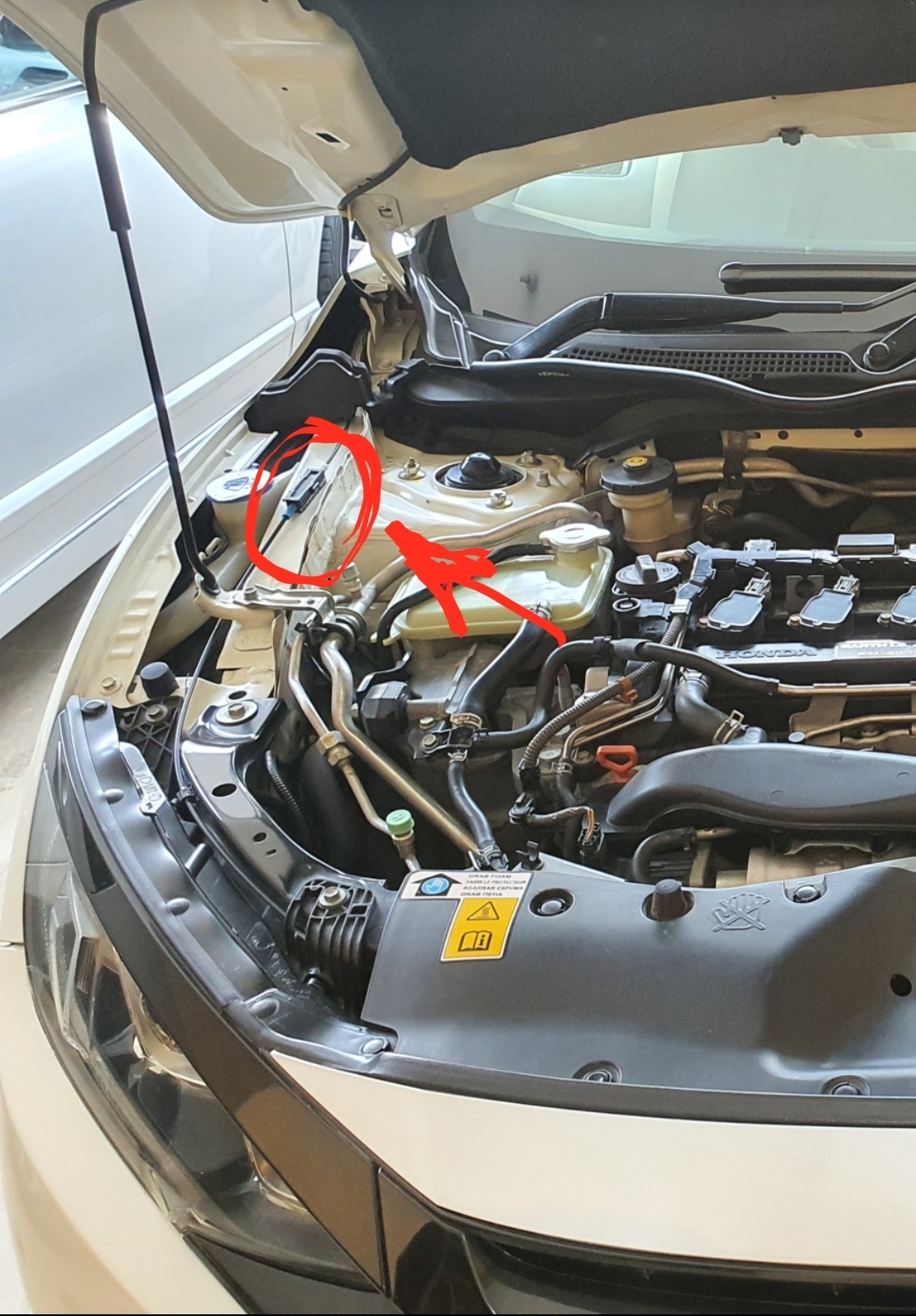

The story continues of installation of driver side fender cover..The problem started when I noticed that There is an assembly where two wires (hood opening wire) meet.And in the cover the slot to compensate its shape is on our passenger side cover.There I came to know that these covers have come from a Left hand steering car (Chinese).
I am talking about this thing..
Measure the square latch for bonnette and make square space in the covers. u have got all the right tools to do it.....

I marked it ..
Then I cut it.
