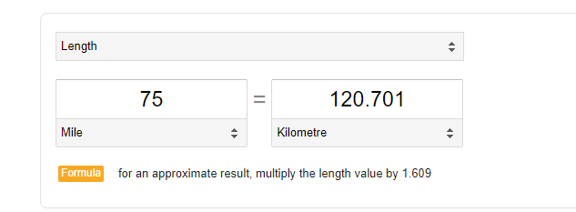

i have installed a speedometer application on my mobile and have found the following reading
when the needle is at 40km the application is showing around 55 to 60 kms
when the needle is at 75 km the application is showing 120 kms
