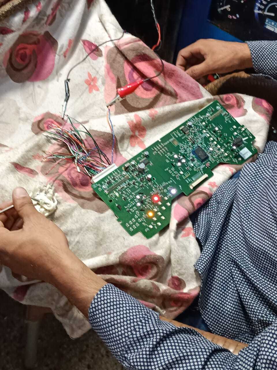

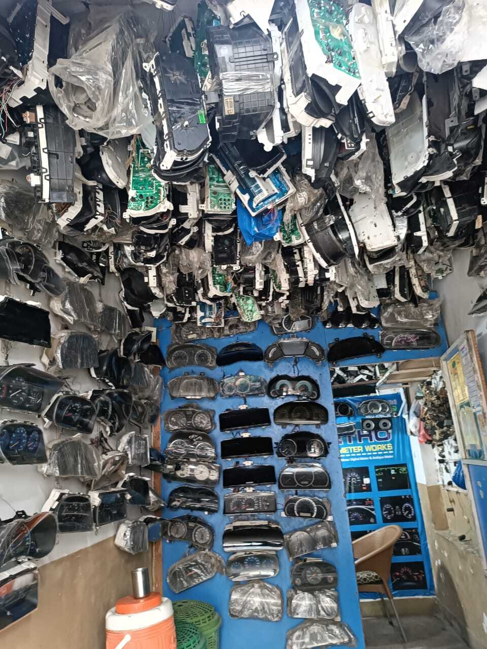

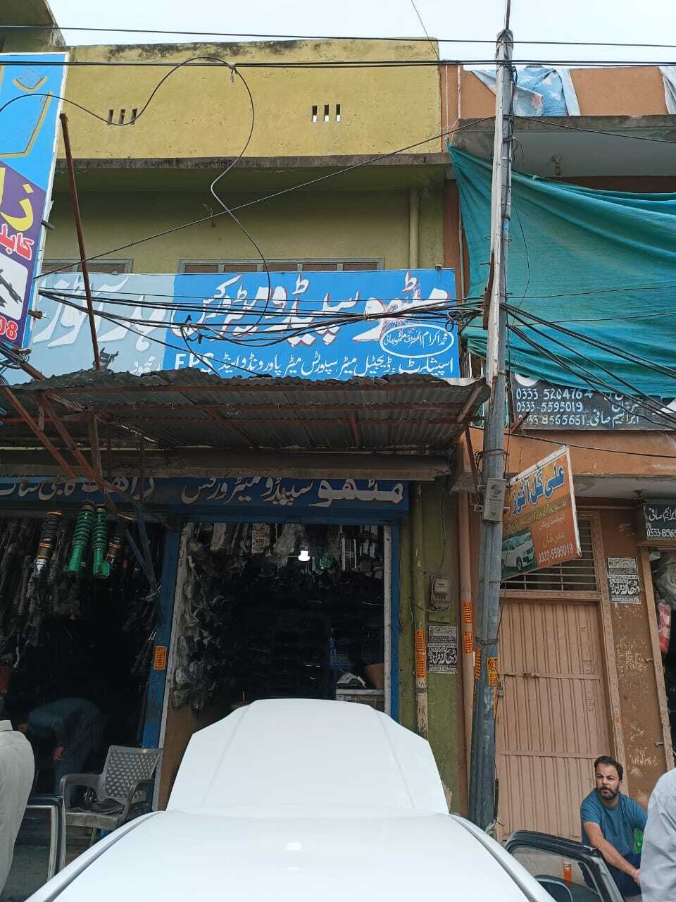

finally ended up with this dude "Mithu" in glass factory road- khoo....saw meter behaviour and in 30 seconds said its meter problem.

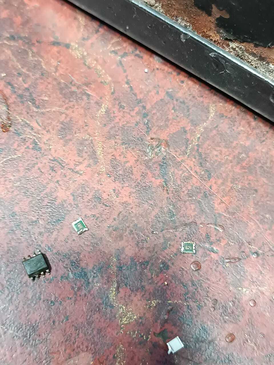

took ic's from donor meter and fixed it.very skilled guy.
got quoted 40-50,000 for kabli meter...meter fixed in 8000
