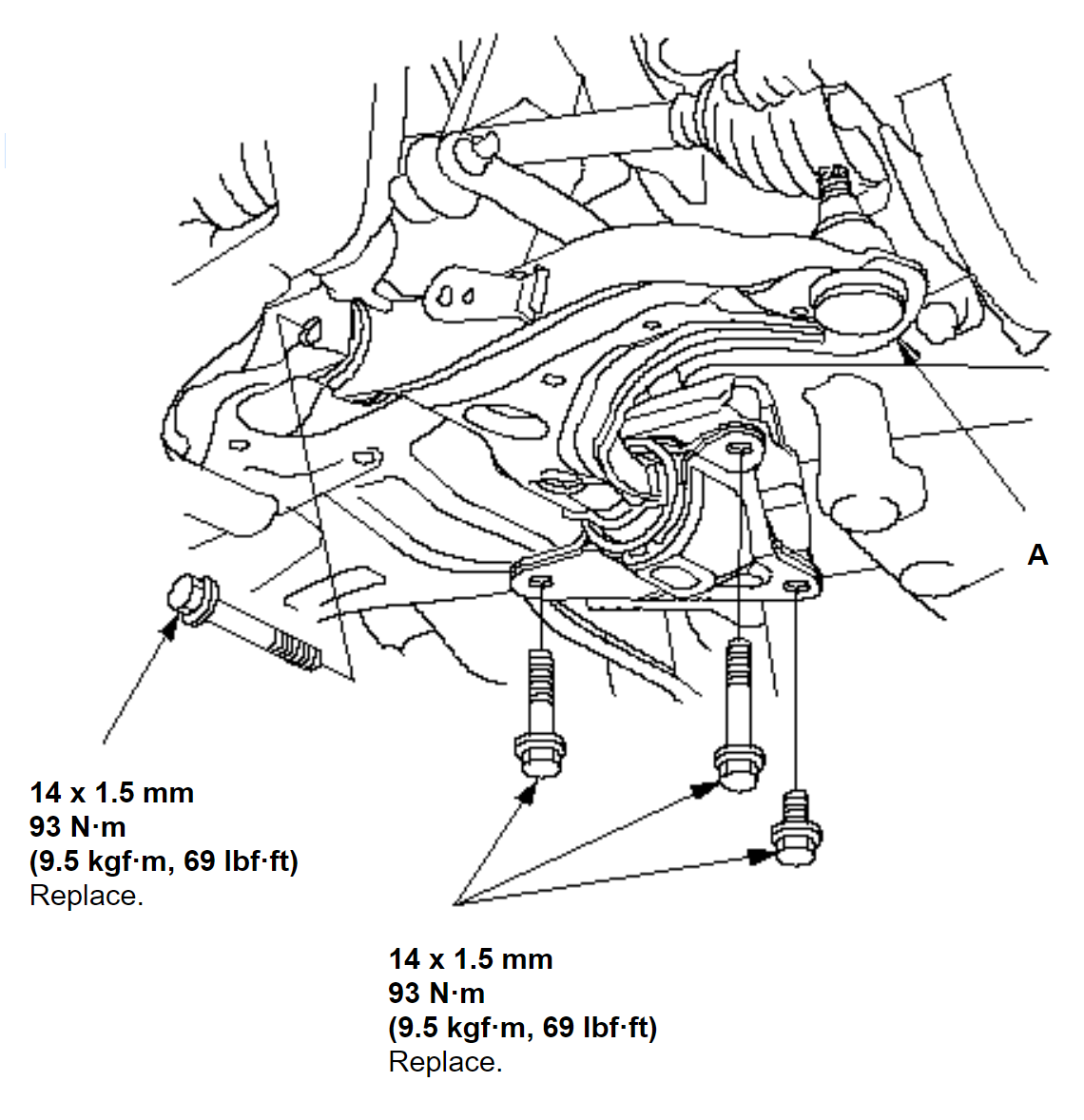

That lower control arm you replaced, should be tightened when the suspension is on load, not hanging free in the air.
Go to a proper place ask them to loosen the bolts and retighten when suspension is on load.

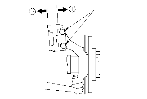

Secondly same for the bolts on the strut. When suspension is on load tighten . Go for alignment after.
