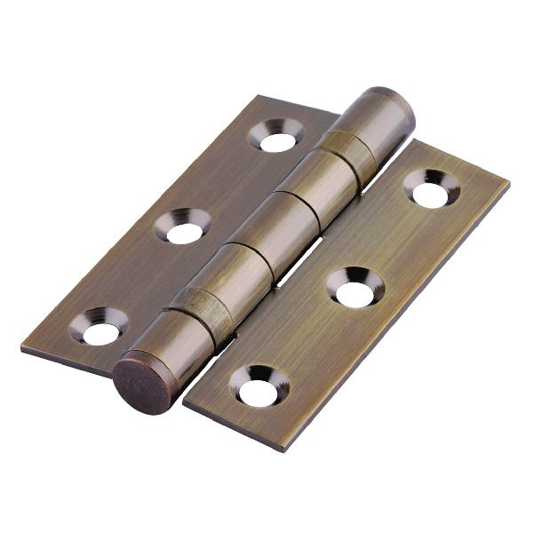

Bearing Based Hinge.
-Bearing based mechanism, bearing are inside the cylinders
-Very smooth flow of door opening/ closing
- Long life and more reliable
- Have strong integrity and do not deform over period of time so door always remains in level
- No abnormal sounds over period of time
- Good interior finish
- Not so much price difference w.r.t simple hinge

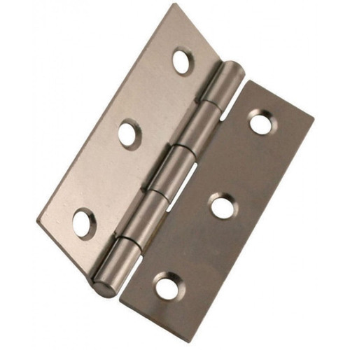

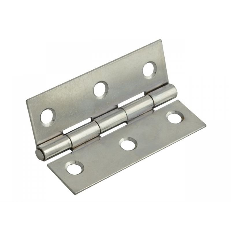

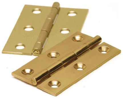

2) Non Bearing based Hinge or Wire based Hinge
-Both part of hinge are connected with each other via cross-intersected 2 mm wire
-Hinge level tend to out in case of heavy door
- Not capable of bearinh load of big doors
- Door opening/closing problems due to hinge deformation over period of time
- Less rates as compared to of bearing based hinge
- Gives very disturbing sound after some time and you need to lubricate it regularly
-Below average interior loooks
