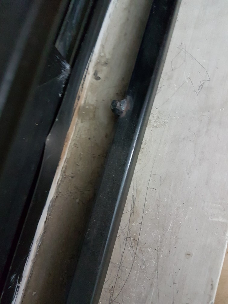

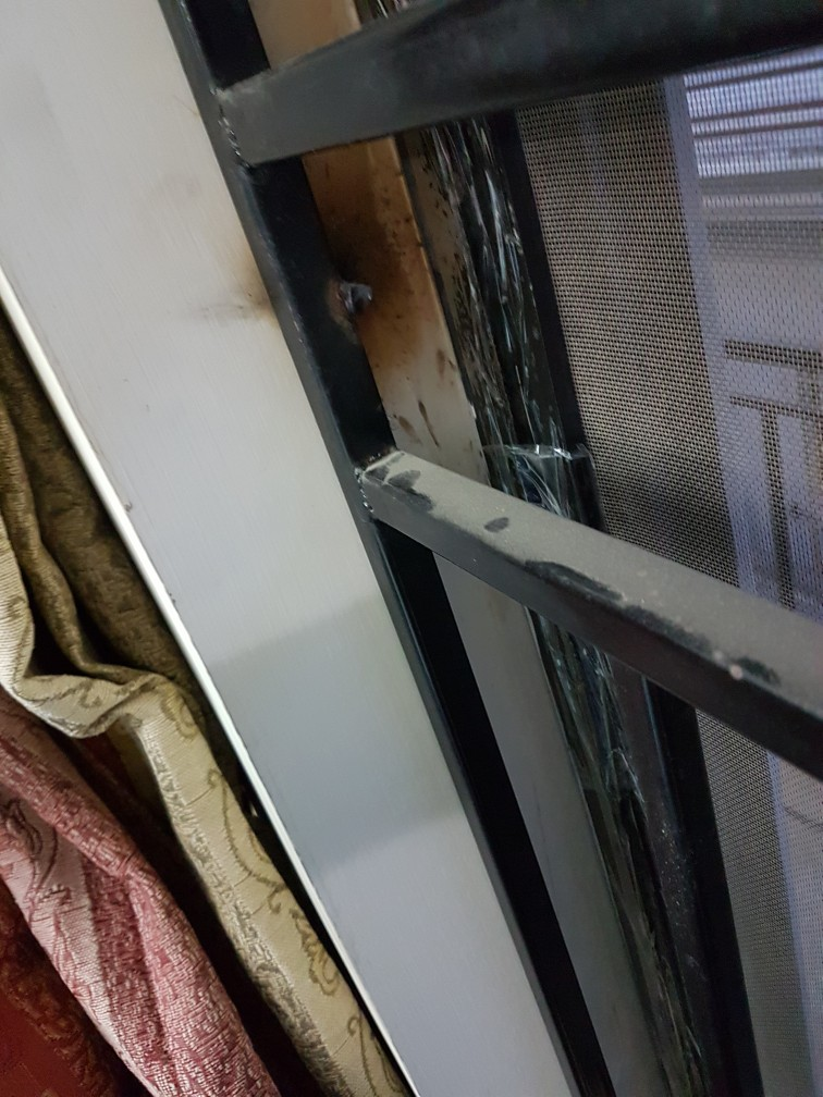

Steps for Welding the Grill with Sarya
1- Prepare the grill as per window size
2- Identify no of 3.5 inch long sarya (sarya size 2.5 sootar) pieces required (usually 10 - 12 pieces may be required for an normal size window. 3 for top, 3 for left side, 3 for right side and 2 for base)
3- Paint all the sarya pieces as well to minimize the corrosion rate
4- Once grill is prepared, painted , keep grill inside window. At least 3 inch inside from wall corner
5- Make spot on wall with help of marker for making an hole for 2.5 sootar sarya.

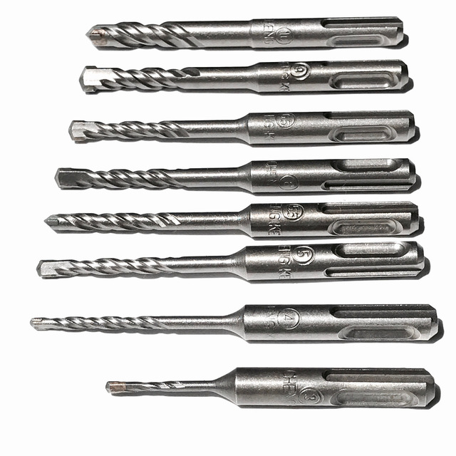

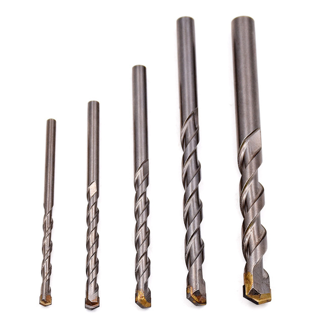

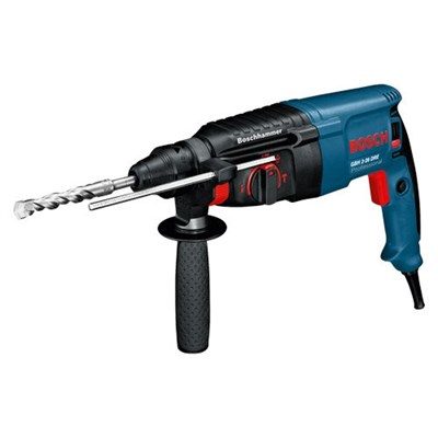

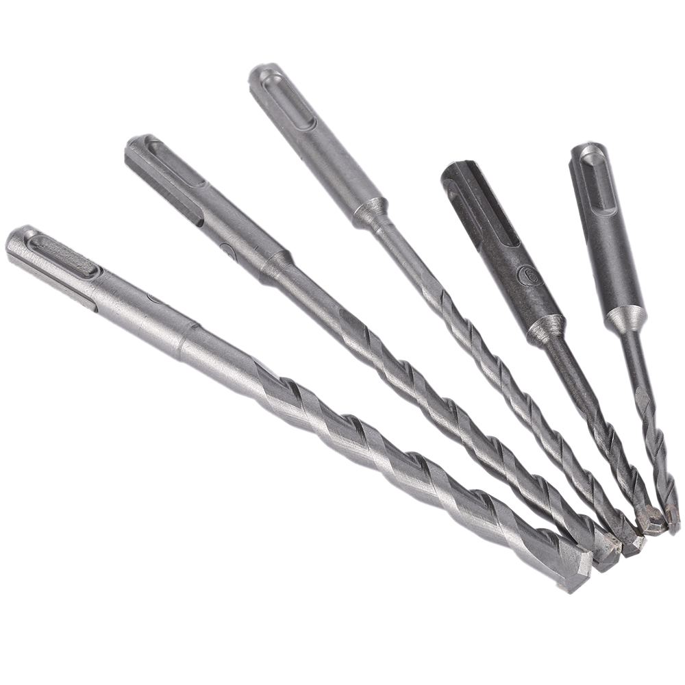

6-Make holes on marker spots with help of rotary hammer (Hilti) drill. Use appropriate size of bit i.e. hole shall be of that size in which 2.5 sootar sarya can be inseretd easily. Niether it shall be very tight, nor it shall be loose otehr wise grill will loose. Hole depth inside wall shall be 3.5 inch.
3 inch sarya will be inside wall and 0.5 will be outside wall.

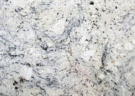

7- At bottom side/ base side if marble slab is present in window, use sehhesha verma for making hole in marble/granite slab , once you clear the marble segment, then you can use regular bit which you used for making other holes.
8- Once all holes done, insert the sarya with help of hammer. Keep only 0.5 inch outside wall.
9- Keep grill in window
10- Weld in a good manner from all sides.
11- Once welding job done, advise paint guy to do the final touching
12- ENJOY your sleep with security and safety feeling.

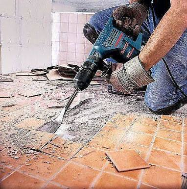

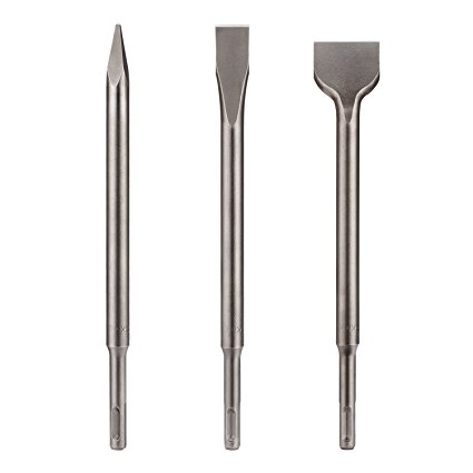

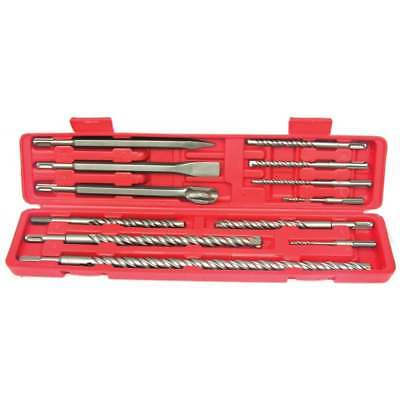

Few pictures for reference are given below;
