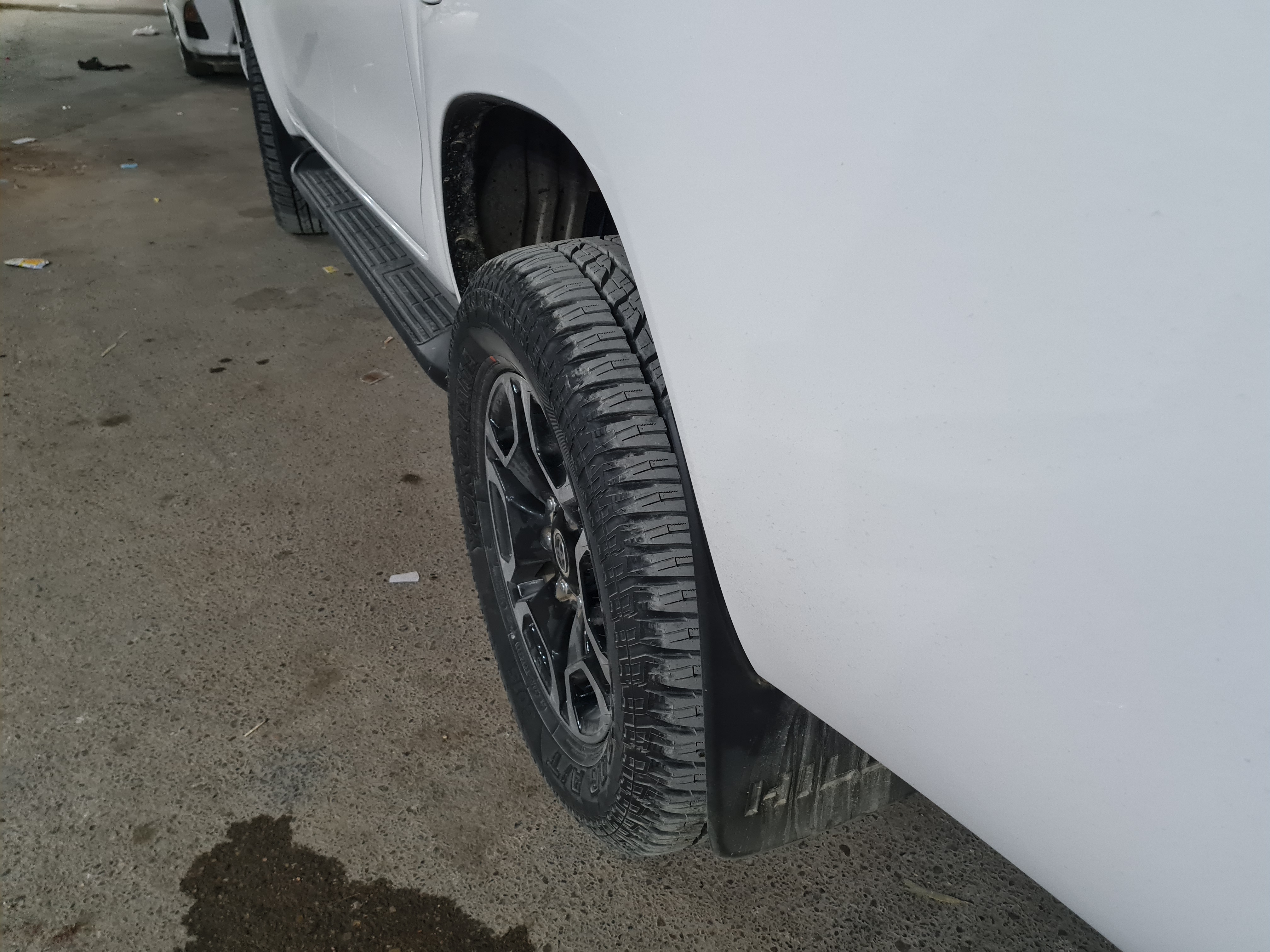

Now last month, my Thai shocks requiring replacement after crossing 100k kms were replaced with agri-autos ones and that's where the ride became real hard and bumpy (shitty). Since the tyres also required replacement soon, couple of weeks back, I got them replaced, upon a good friend's recommendation, to Geolander G015 285/60 R18s, four month old production. And after that drove them from Lahore to Islamabad.
There is negligible difference (placebo effect as qwerty said above) between the two. Comfort-wise there is no difference. Grip-wise yes, I'd rate them 10% to 20% better depending on terrain and wet conditions.
Also, bear in mind that both in my case as well as my friend's case, the front tyres touch the mud flap while making a full turn and using brakes. If you're not using brakes and at slow speed, the tyres do not touch the mud flaps. But if you're coming down a slope (on a mountain) and have to take a sharp turn as on Margalla hills or for that matter any mountain path in northern areas, the tyres are going to rub hard on the mud flaps.
Moreover, please also note that economy-wise, the Geolanders are at least 0.5 km / L and at max 1 km / L less economical based on my motorway as well as within-city usage thus far (two tanks).
