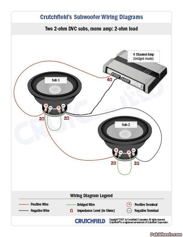

Maggi , correct me
People say thay
4 ch amplifer can run 4 speaker and 2 woofer
at a time
i dont agree with these people cause
while hooking the subwoofer to the bridge , the Filter needs to be at LPF ,
lets suppose i hook 2 subwoofer on 2 bridges on 4 ch amplifier , then how will i hook hup?? the speakers
cause , on hooking woofer , the LPF will be use
but speaker cant be used on LPF ,SPKR need to be run at Full or High pass filter if tried to used , they will produce bass and on turning up volume , distortion will appear ,
so its means that ,
1 woofer to bridge , and 2 speaker to rest of 2 channel
or optional 2 speaker addition in order to give a load of 2 ohms to amplifer , by hooking both terminals of speaker each other
