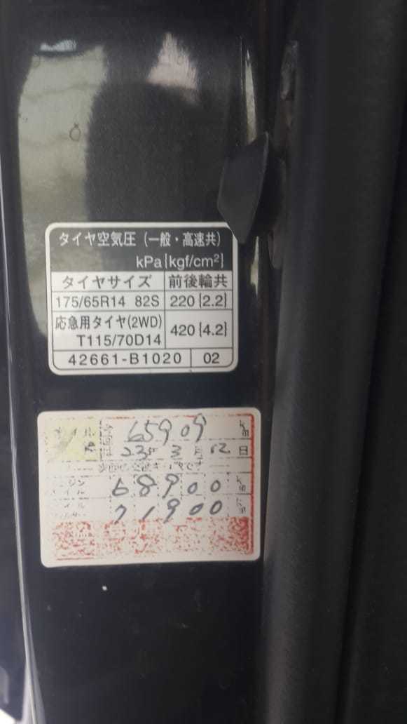

OK Brother. First let me share with you the tire specifications of my Toyota Passo X, Model year 2013:
(This sticker will be placed when you open the driver door, and look towards the bottom of B-Pillar of your car)

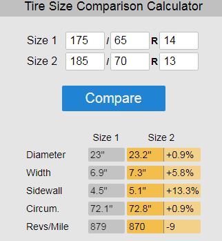

Brother you are using 175/70/R13, they are only wider by 10mm then my current tires, otherwise, aspect ratio and rim size is the same.
Brother did you check the sticker? I really doubt 175/65/R14 as the stock recommendation for Toyota Passo.
If this has been written on the sticker, kindly share the pic.
Brother if you change to 185/70/R13, tires will become wider and section height will increase a bit and overall, little to no effect!
If you change the rim size to 14 (which I really doubt is the stock one), you will be severely compromising over its suspension!

Look at the sticker of your vehicle, which shows complete tire specs.
