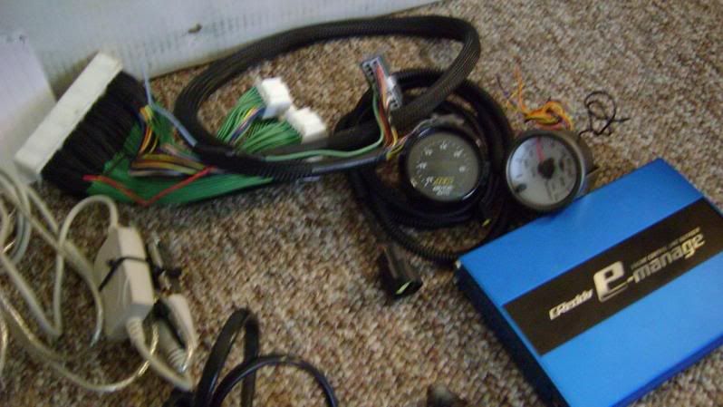

Hello Hemi,
Can you provide some more information on this kit? If it is an original TRD kit for the 1zz-fe, then does it have the necessary electronics for the installation? As far as I can remember TRD supplies all necessary electronic mods to fuel the car correctly with the supercharger.
TRD kits are pretty easy to install if they are purchased in a complete package.
Here is what they say on the Net:
TRD USA SUPERCHARGER KIT 1ZZFE KIT
35% increase in power and torque with 7.5 lbs of boost.
TRD USA 1ZZFE KIT
The bolt-on unit is integrally cast and is equipped with new efficiency and performance enhancing features,
such as a race-inspired supplemental injector for enhanced full throttle performance and an internal bypass
circuit for fuel efficiency and smoother operation at low speeds.
Peak torque is 145 lb.-ft. supercharged @ 4000 RPM vs. 125 lb.-ft. stock at 4200 RPM. Peak horsepower
is 166 HP supercharged @ 6800 RPM vs. 130 HP @ 6000 RPM.
As with TRD’s 4.7L V8 Supercharger, this unit also features the new exclusive TRD Engine Management
System engineered to provide peak engine performance.
So do you have the extra injector and the fuel management system with the supercharger?
