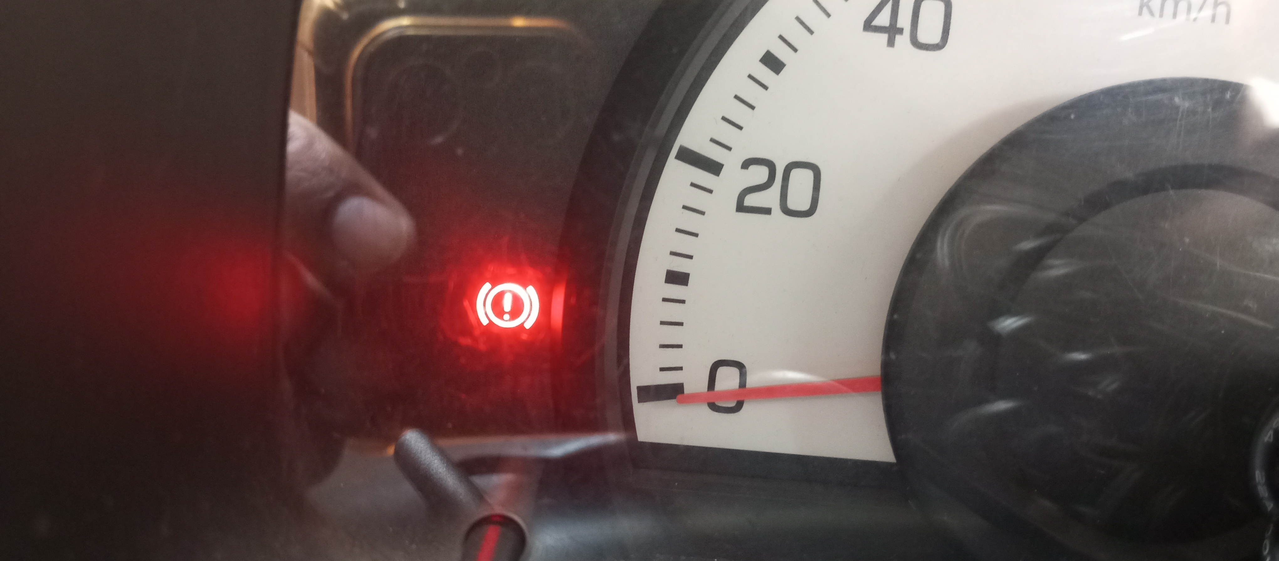

I just have received a continuous beep and alarm on Suzuki Alto 2020.Can anyone help me to identify this alarm/beep and and resolve the issue.
Lower the hand brake b4 driving. Pull it up to full then let it go, if it persists check the hand brake electric connector and switch (it may need some trim removal to get access). Lastly check the brake oil level in the reservoir.
@cremaI didn't check this but I think you are right. I'll do that in a little while. Thanks for your valuable advice.

If handbrake is released, this would mean low brake oil.
