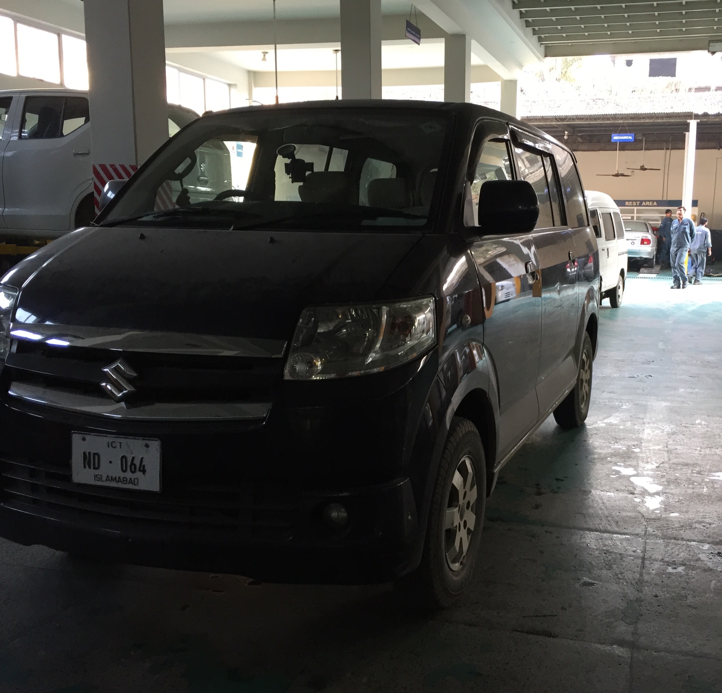

@sameerulhaq064 is your APV fixed and running good after filter in pump is changed ?
Well, the Baleno decided to give up the same day when APV gave up. So I got her fixed first(Fuel pump died). For now APV is standing idle. Will get her fixed this Friday In Sha Allah. Thanks for asking.

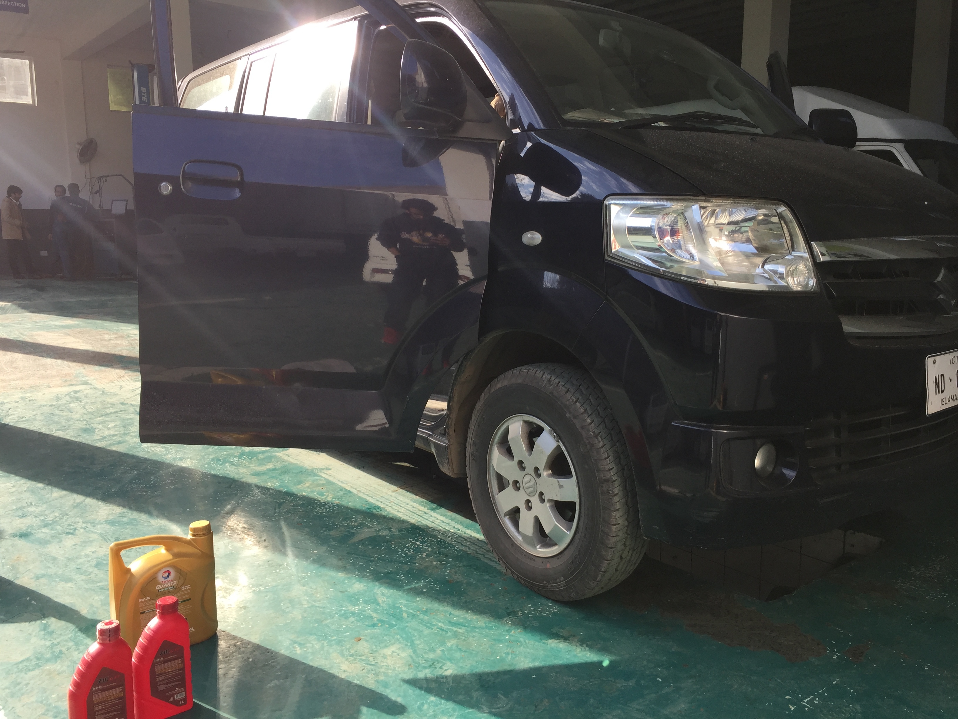

Engine oil and gear oil was changed last week. Used total Quartz 5W-30 fully synthetic engine oil this time.
