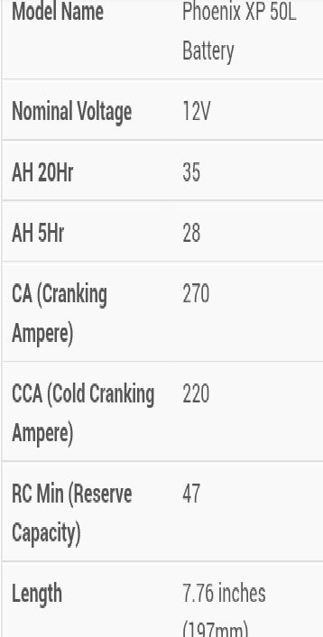

Battery wala gave me Phoenix XP50L in Rs. 3800 & got my 2 years old battery of Phoenix old model XP50 in 600 so i had to pay 3200. He told me that XP50L has 11 plates & 50 ampere(while my old one had 9 plate)
I saw all packs of battery but could not find any written info about this battery.Later on found after installation, i found online that it is of 9 plates.
MY SUGGESTION IS TO INSTALL AT LEAST 11 PLATES Battery in Cultus with at least 55 or 60 Ampere)
do not get confused between model number & ampere.All battery companies r making fool such as AGS 65 does not necessarily means 65 amperes, it will be 40 or 45 ampere(65 is the model number
GO ONLY FOR AGS or Exide. Do not try Phoenix battery(As i am not much satisfied by it personally)

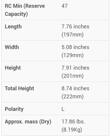

However i am attaching spec. of XP50L which i found:
