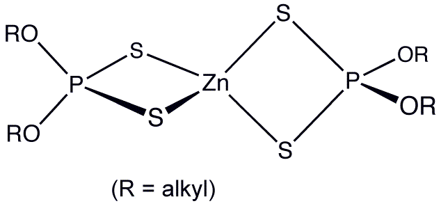

Zddp has this molecular structure which is obviously showing contribution of Phosphorus & sulphur in Zddp
