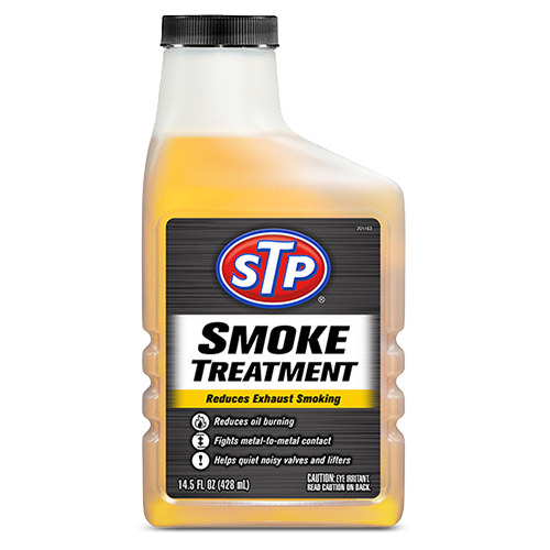

These partial Engine rebuild is always headache. Seems u haven't changed pistons & other parts.
There was no need of STOP OIL after such repair.
Engine is not properly repaired. Chamber and other issues r there.
Quick start or Late start is not directly linked with Good Engine.
