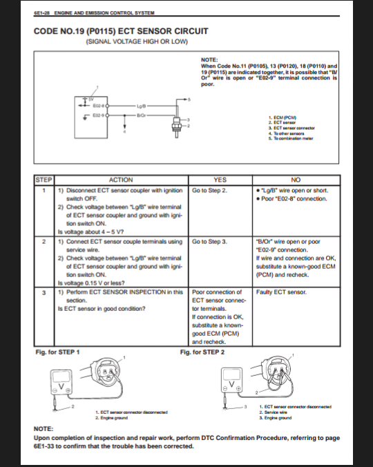

Its an update for those freinds whose radiator fan doesnt turn on at right time. And they are facing engine over heating issue.They suppose to check ECT (engine coolant temprature) sensor wiring specially its ground wiring. My engine was suffering from same problem and found ground wire the real culprit.thanks
I have ordered correct part number of ect sensor for my baleno from aliexpress. So what do you mean by ground wire?
Check the diagram below. U will find ur answer
