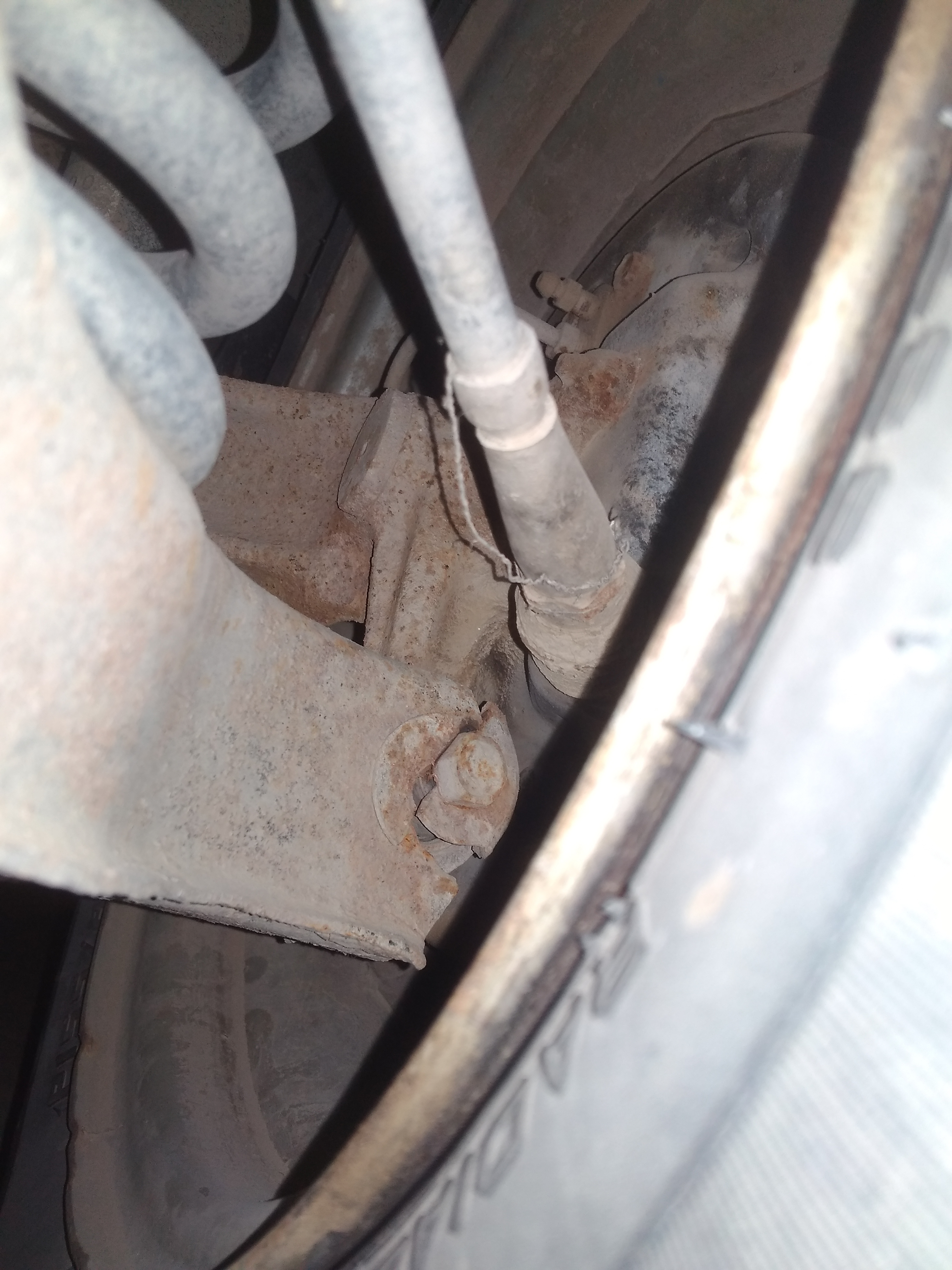

Now rear chimta is found cracked where Tire side bolt is present. Should it be welded or replaced. If replace then from where to get original chimta in lahore? Option of kabuli?
By chimta if you mean control arm aka kenchi then buy new chinese pair and install it. I did it in my liana and a brand new pair chinese along with bushings and ball joints costed me 3800 only last December. Total worth it and peace of mind. Do not go for kabli. Its my advice
Yes, I think they are called control arms. You can see front ones in first pic posted above.... however broken one is of left rear side.Will Chinese last long? Any specific brand?Thanks
Here is the pic
It should be changed. Get a kabli in good condition.
any cost idea?
I was talking about front control arms. But i am sure new Chinese are available for rear too.
