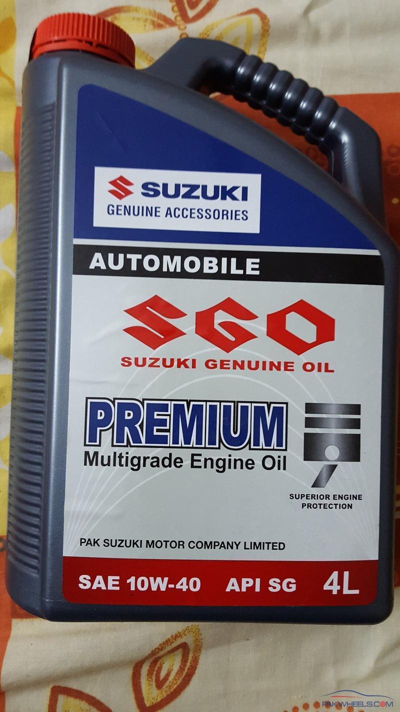

Btw after head repair, car is giving little smoke in starting and silencer has also some carbon...which was not before repair.. I have to change its oil today.. still I have to go for Zic x7 (10w40) or some other viscosity?
go to any Suzuki dealership and ask them to pour EXACT 3.5L of SGO Premium oil. use 150 rupees wala oil filter they offer. you will be good to go.

Thanks I just talked Macca motors and they said they have ULTIMATE for 5000KM in Rs 2800. They say its better than PREMIUM?
didnt they have Premium? Ultimate is API SM and the same is used by dealers in all cars from Swift/Liana to Ravi since inception
Means premium is better?They are saying premium is old tech and Ultimate is new
unko bolo k Cultus beshak model 2014 ka hai mera but usme G-series engine 80's ka hai which is 'old tech'
Hahaha
Macca Motors have PREMIUM and it is of 1800, 1000 cheaper than ULTIMATE . Its good option..
hmmm ok
Dr sb, API SG (Premium) is for cars with flat tappets - CUltus, ALto, Baleno, Mehran etc. so its for you...
API SM/SN (Ultimate/Efficient) are for Liana/Swift
