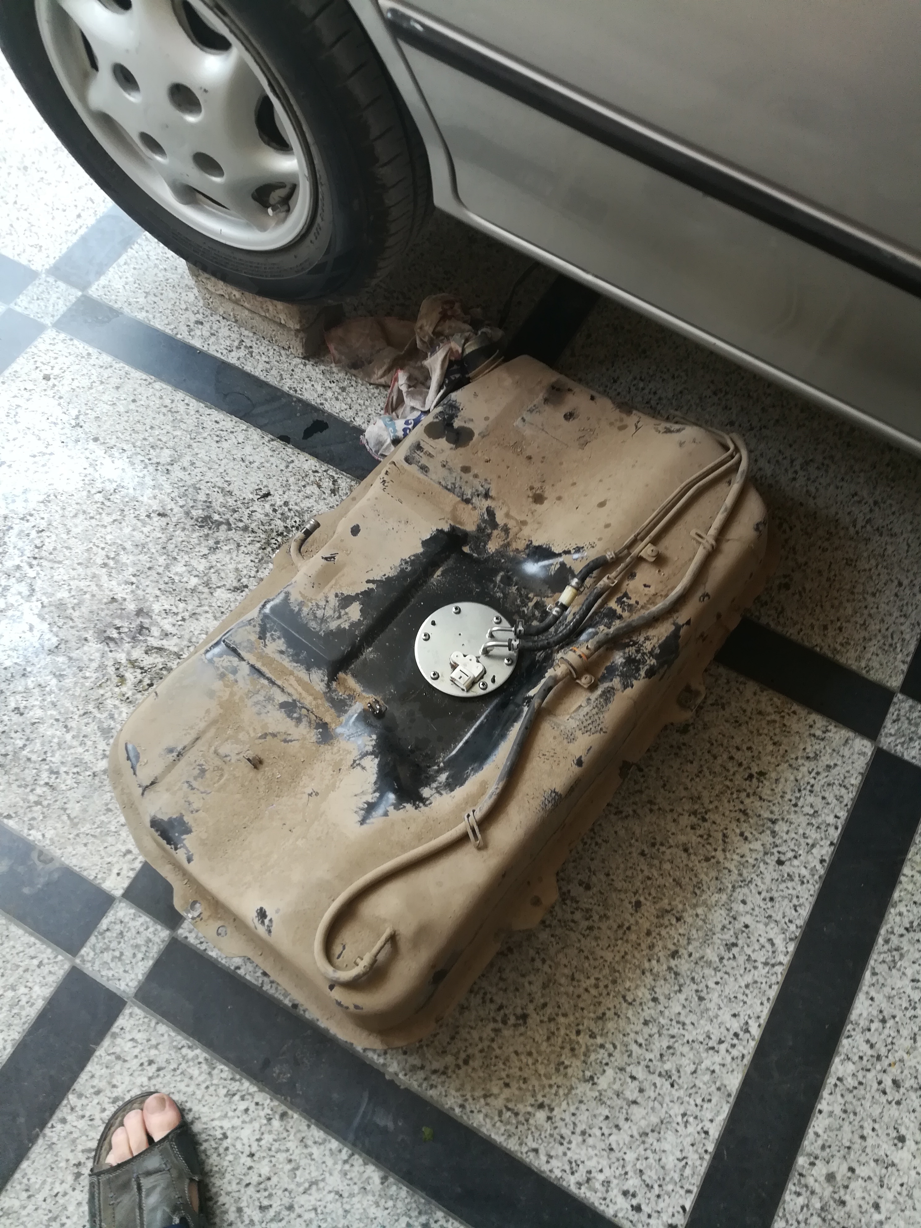

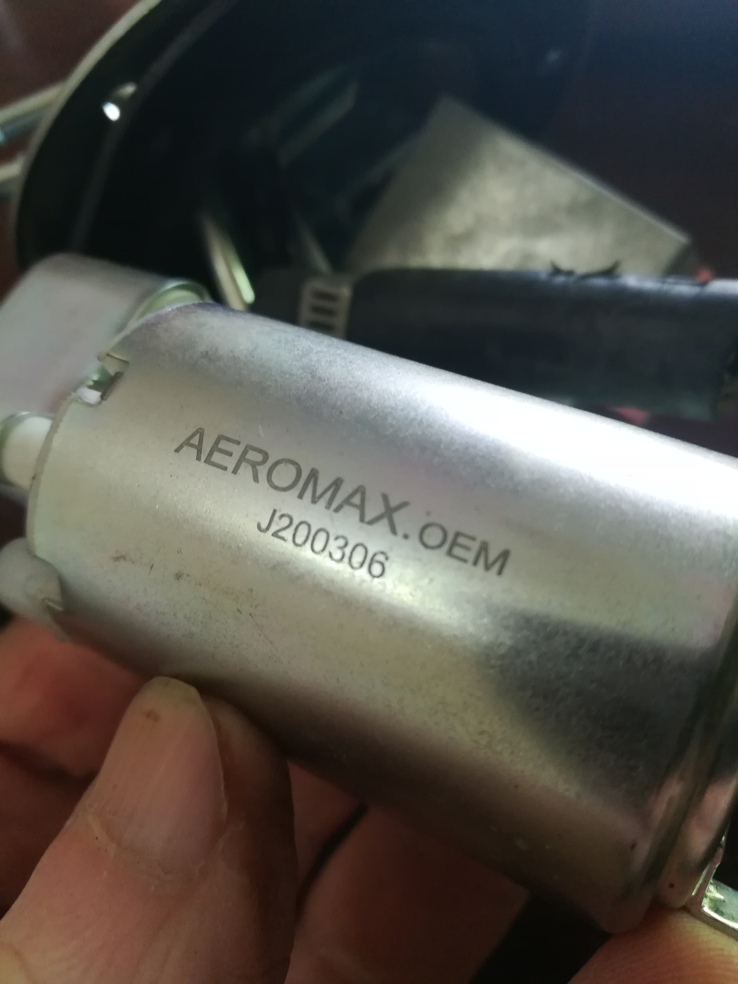

Finally found a acceptable chinese pump aeromax they give on year warranty. It was time for DIY. But I was alone so kinda tough try it only if someone can help u. Lets see how it goes. I wish Suzuki could have given fuel pump access under rear seat instead of removing whole tank. Also found some water in tank. Also see condition of my 2001.
