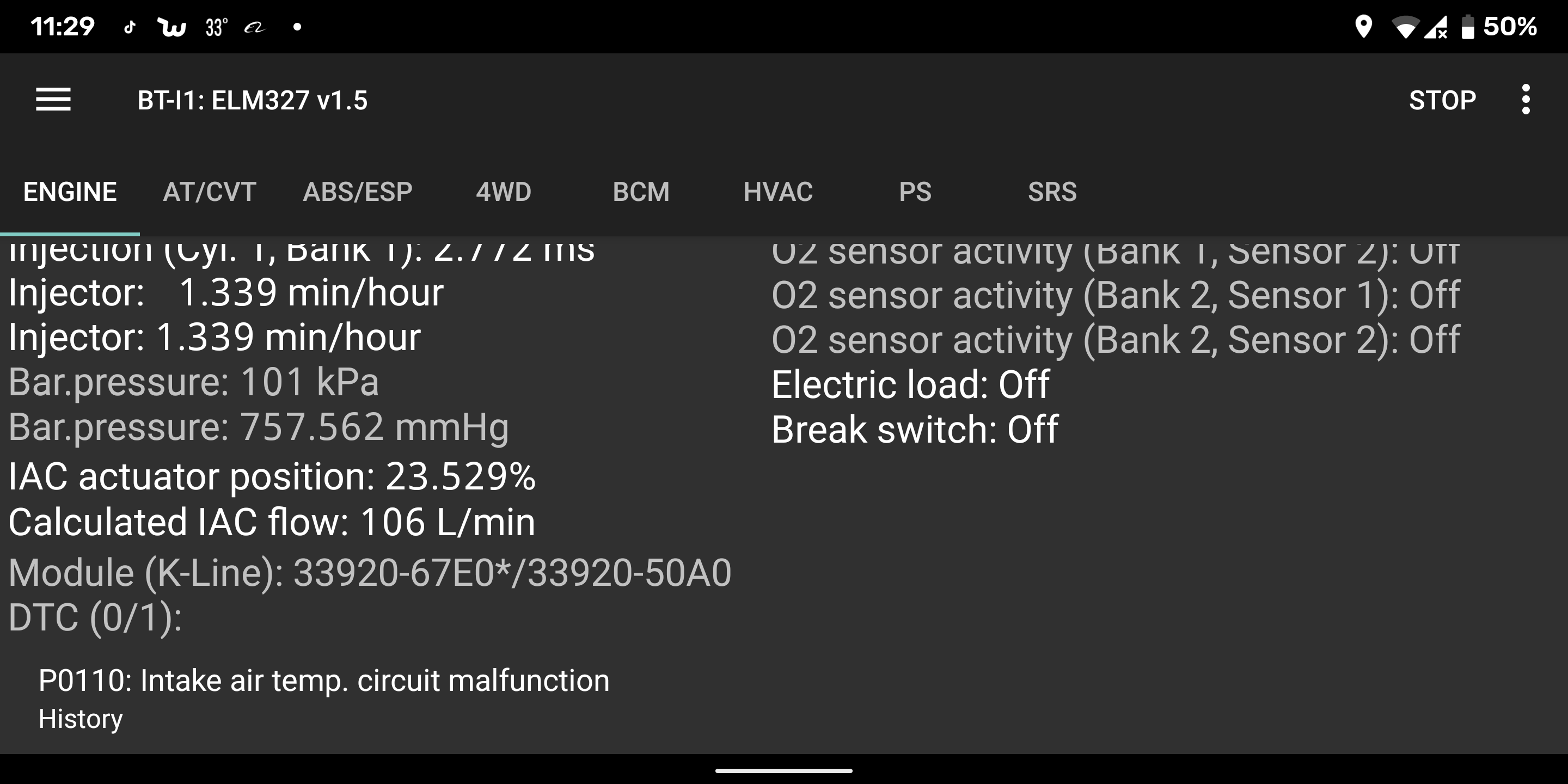

Can you check and tell me what could be wrong.

There seems nothing fishy from this screen shot. Double tap your smart phone screen when scan it next time,scanner will show more parameters like TPS voltage and IAC valve duty cycle percentage, Those readings are important to disganose the rpm issue.

So I take my car to drive and this DTC came up. Also I have notice that the IAC valve position stays at 38 to 40% when I press cltuch and release throttle. The reading shown in this pic are of complete Idle position values.@margallar @RehanBhatti
Your IAC valve position % is correct. What is your TPS voltage at idle on scanner?
0.76 on Idle.
Btw the reading of IAC you are seeing in scanner pic is at idling when car is in running position it stays 38 to 40% I think that is the reason RPM stays high.
Bro, IAC valve duty cycle should be 0 to 50% at warmed up idle.
