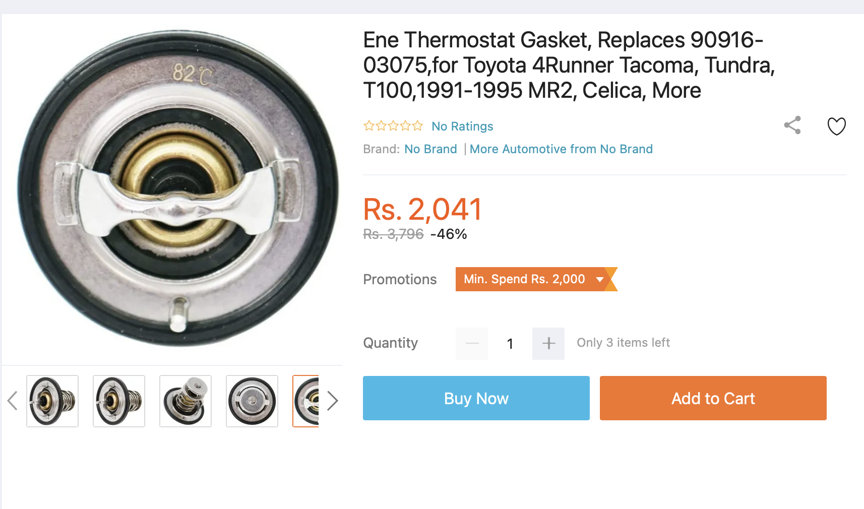

This wont fit, the flange is too wide,
Fit an 88c tstat, make sure the system is corroded or full of trash or rust, and itll be fine.
