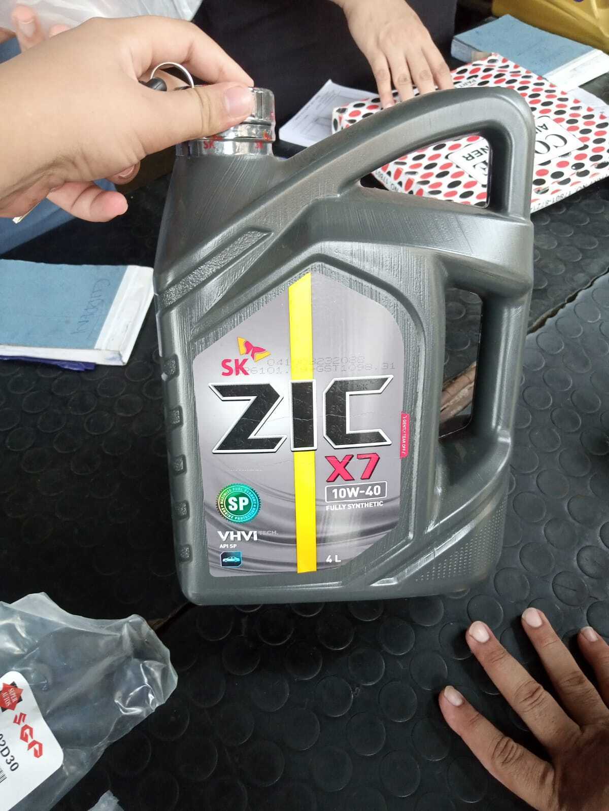

So I have finally been able to change my previously blocked off with a wrapper PCV valve. Changed the oil to 10w-40. Hopefully will go well and, if it does I will change to to 10w-30 on the next oil change. Got this oil as per fellow pakwheeler's suggestion.
New mechanic disapproved slightly and said, "while yes this is the recommended grade for this car, but cars, like your that are considerably old and above the 100,000 kilometer mark, thicker oils are better suited for the engine's protection." Got an oil pan gasket seal, and we were shocked to see that the oil pan didn't even have a seal at all, but instead filled to the brim with silicone. Got brakes serviced and clutch adjusted. Clutch feels very similar to the clutch of my new alto, (which should be a good sign?) Tuned and timing checked. Apparently my accelerator cable was about to give away, got that changed, there is a noticeable change pressing the accelerator now. Went for alignment and guy said that the ball joint of right side needs replacing and should be done immediately. Went back for that and mech and he said we'd need a whole control arm, so we got that for 2700.
