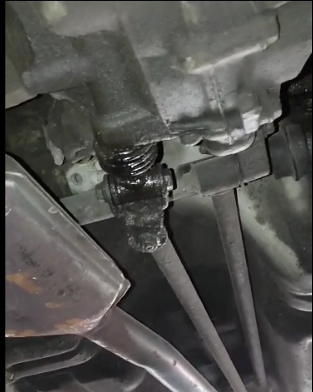

The car has only driven 27 km since the last oil change (I posted it here, and this was when I switched from 20w-50 to 10w40).

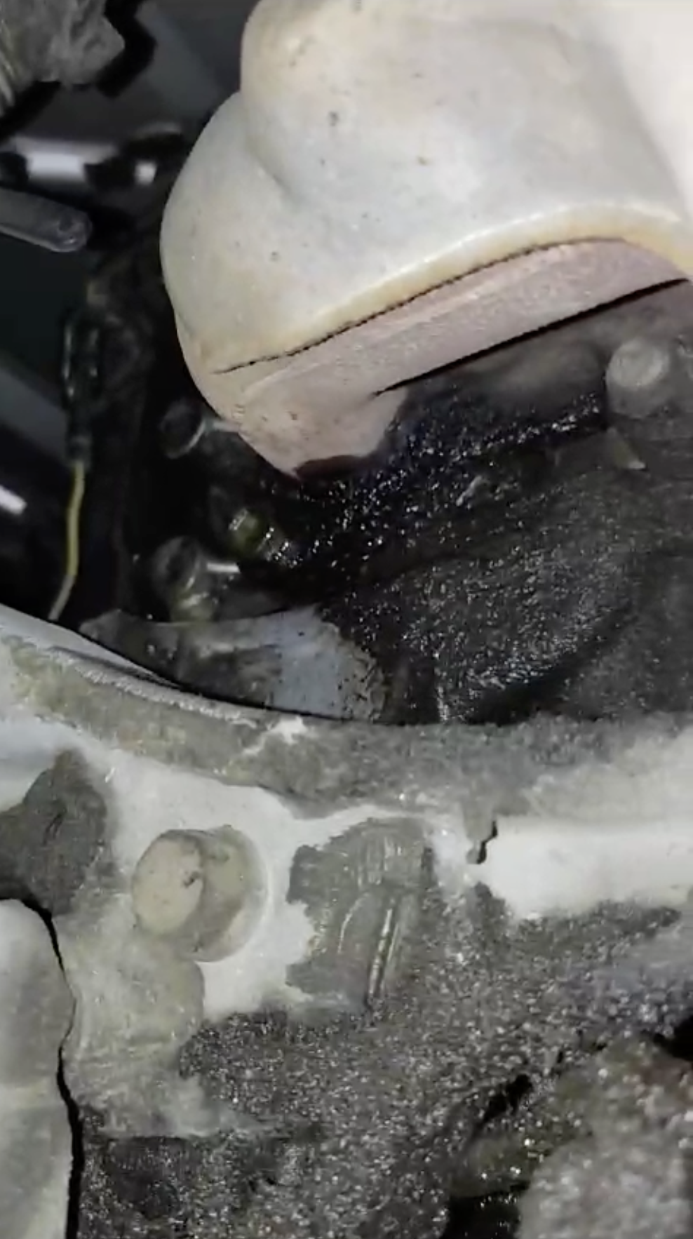

Yes, the head gasket and exhaust manifold gaskets are leaking and need to be changed. It's odd that there are no bubbles in the radiator while the car is idling. I don't think there's even a thermostat in place.
