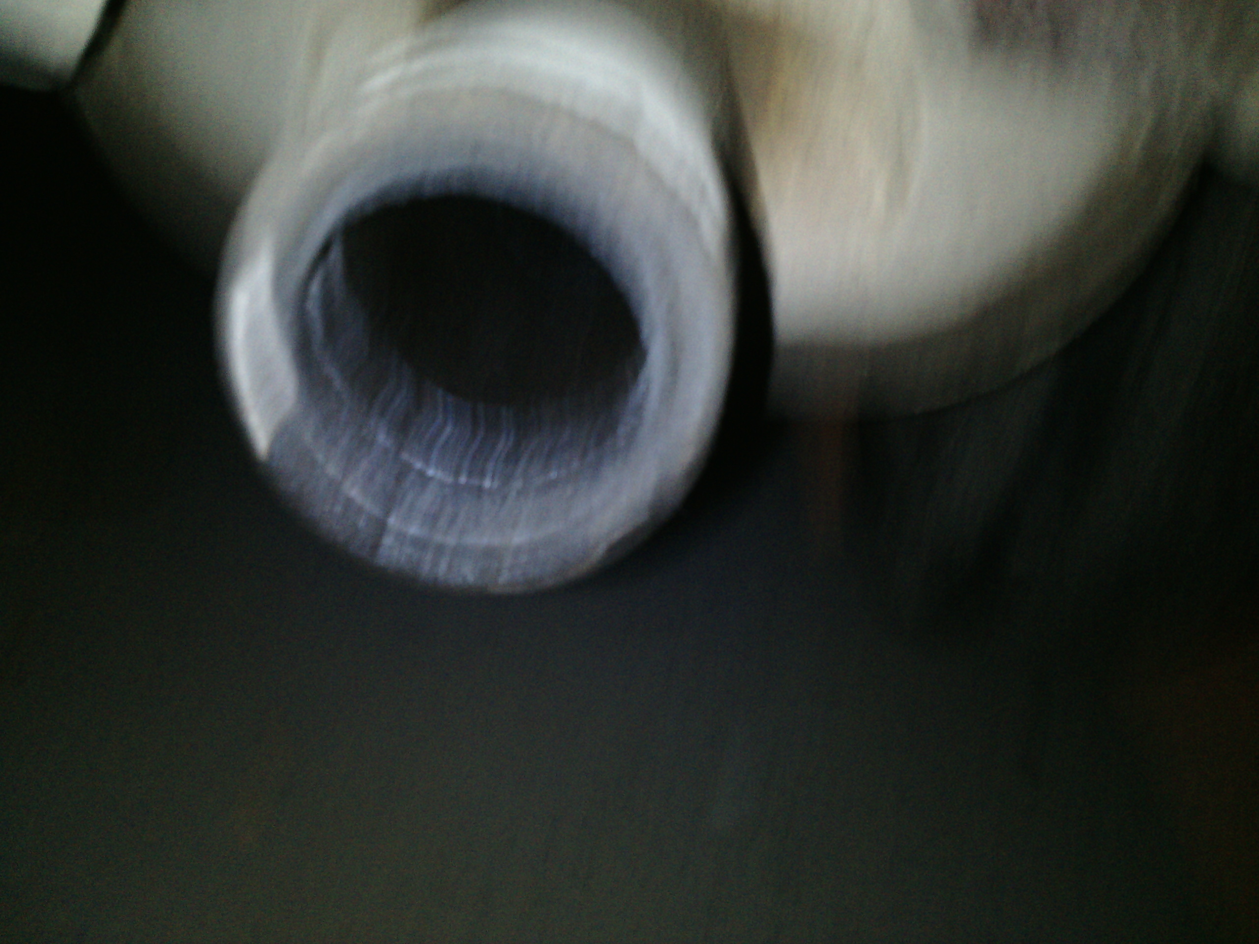

Its metal pipe which is connected to waterbody.
