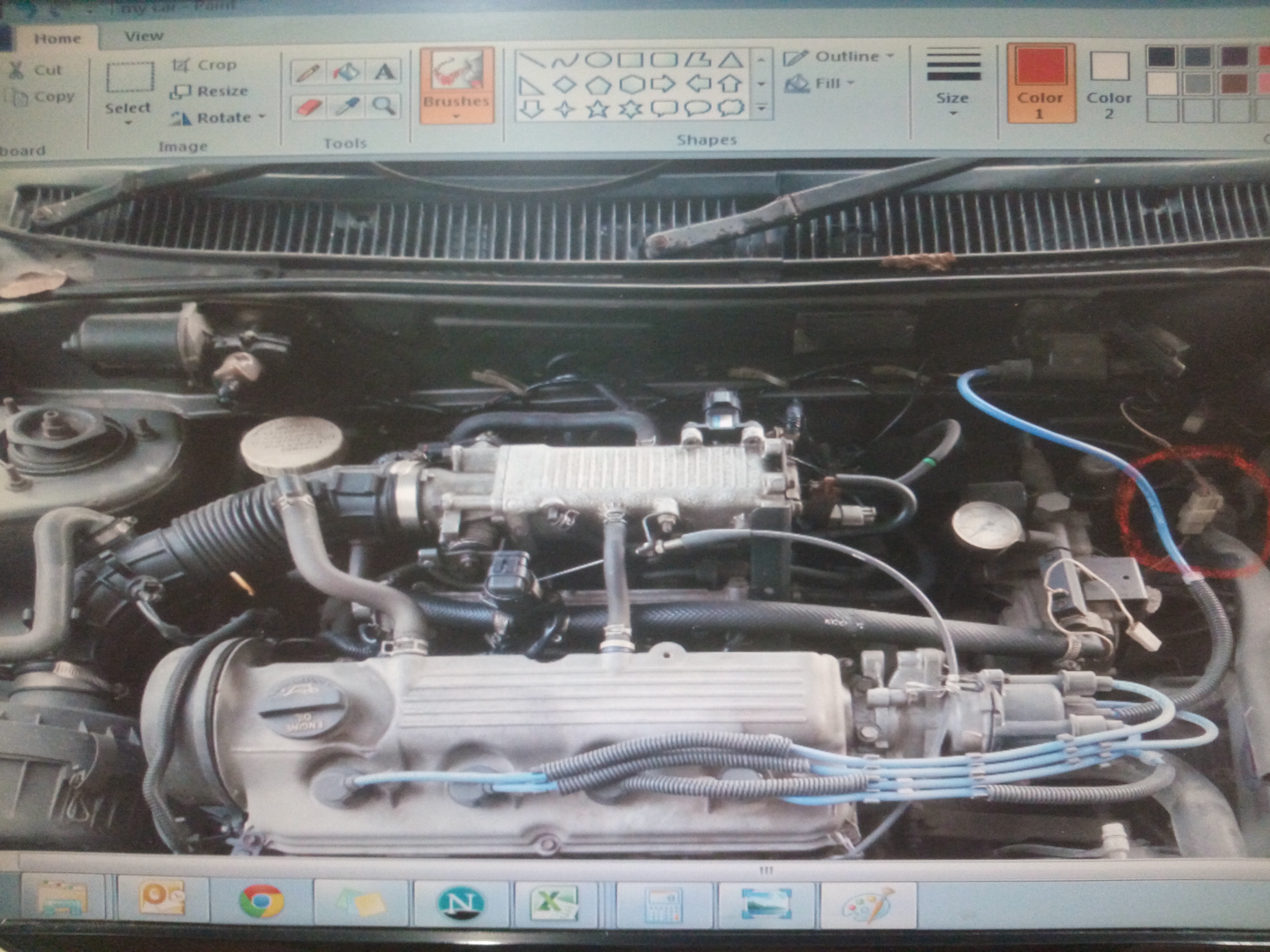

The humming sound seems to be normal the way it used to be before... infact the fuel pump also seems to be working fine. My first thought went towards the battery too but that seems to be in good shape aswell as all the accessories and lights are working fine.
Here's some update on the car:
After getting it checked by a mechanic who checked the coil, cdi etc and then an electrician who checked the wiring, fuses etc.
Today I went to a guy for inquiry who checks cars with his scanning module thing (obd) to catch any errors. He said that most probably an IC is blown that exists on a "card" which costs atleast around 25k to replace (much more from Pak Suzuki). I think he meant the IC on the ECU board is blown.
Has anyone ever experienced such situation and how much does it cost if anyone knows? Also he mentioned in some cases resetting the computer solves the problem has anyone had it resetted? Any help is appreciated.
