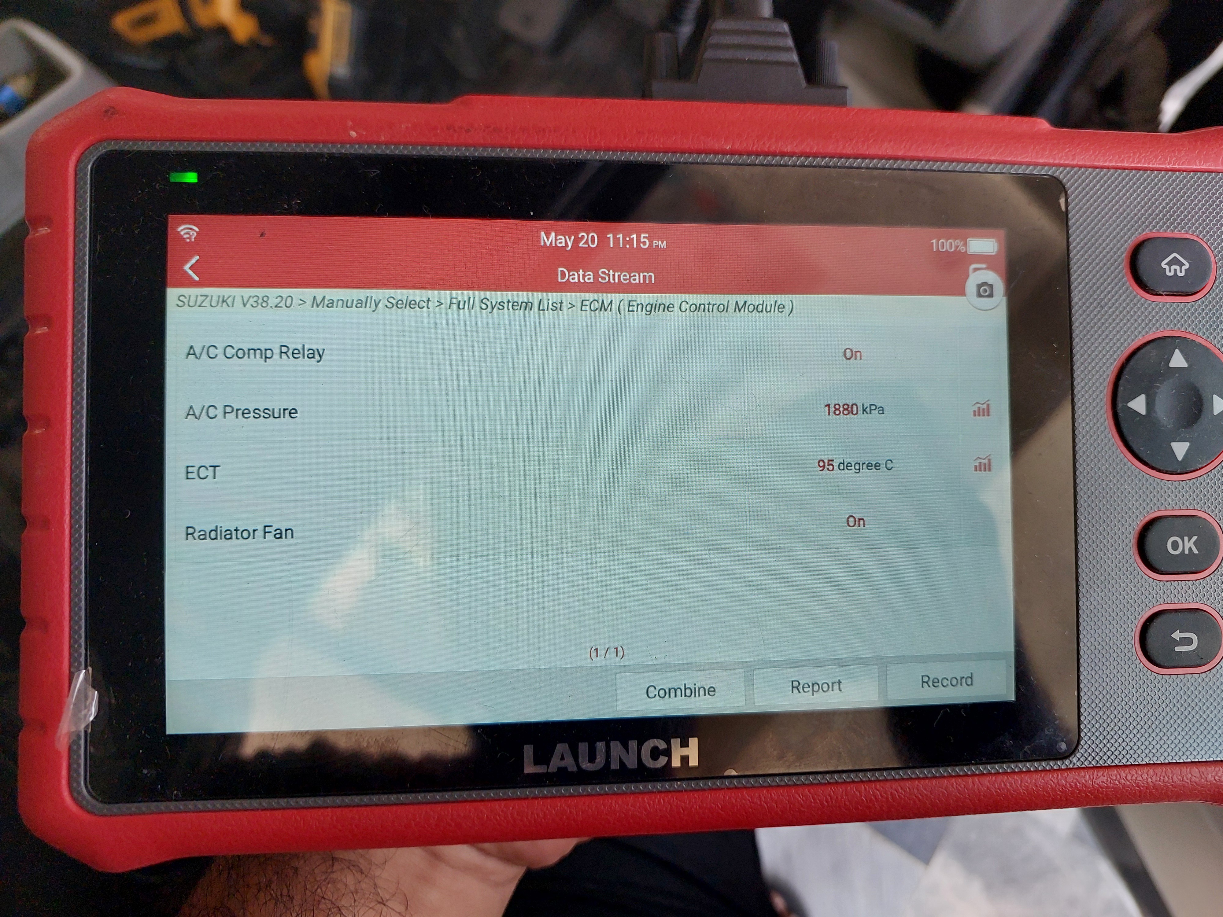

So, i hooked up my scan tool and ran diagnostics while on a test run. I was unable to recreate the issue, but I am going to try again.

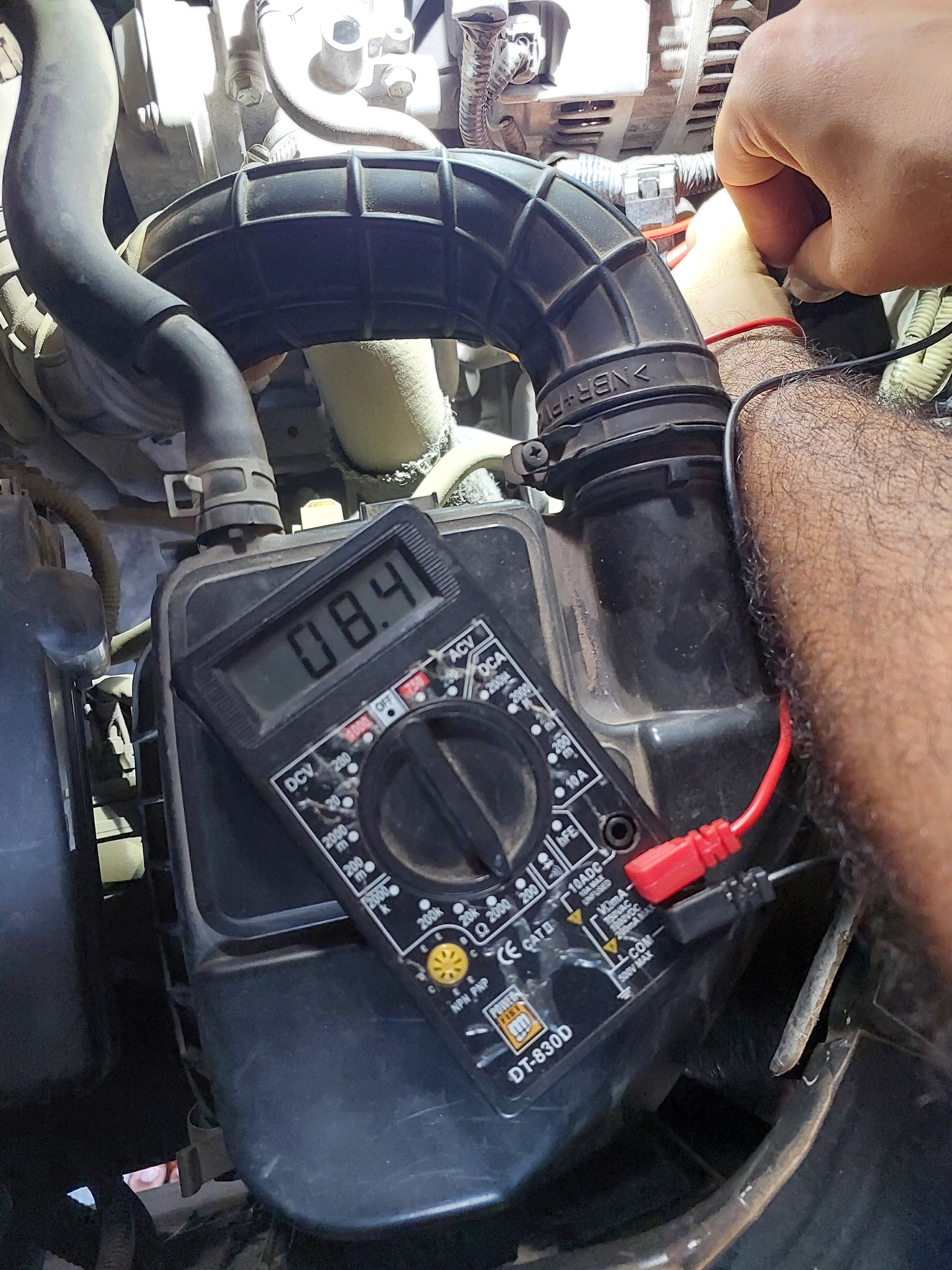

I am going to try and jack up the vehicle and remove the belt cover to inspect the compressor and connector.
