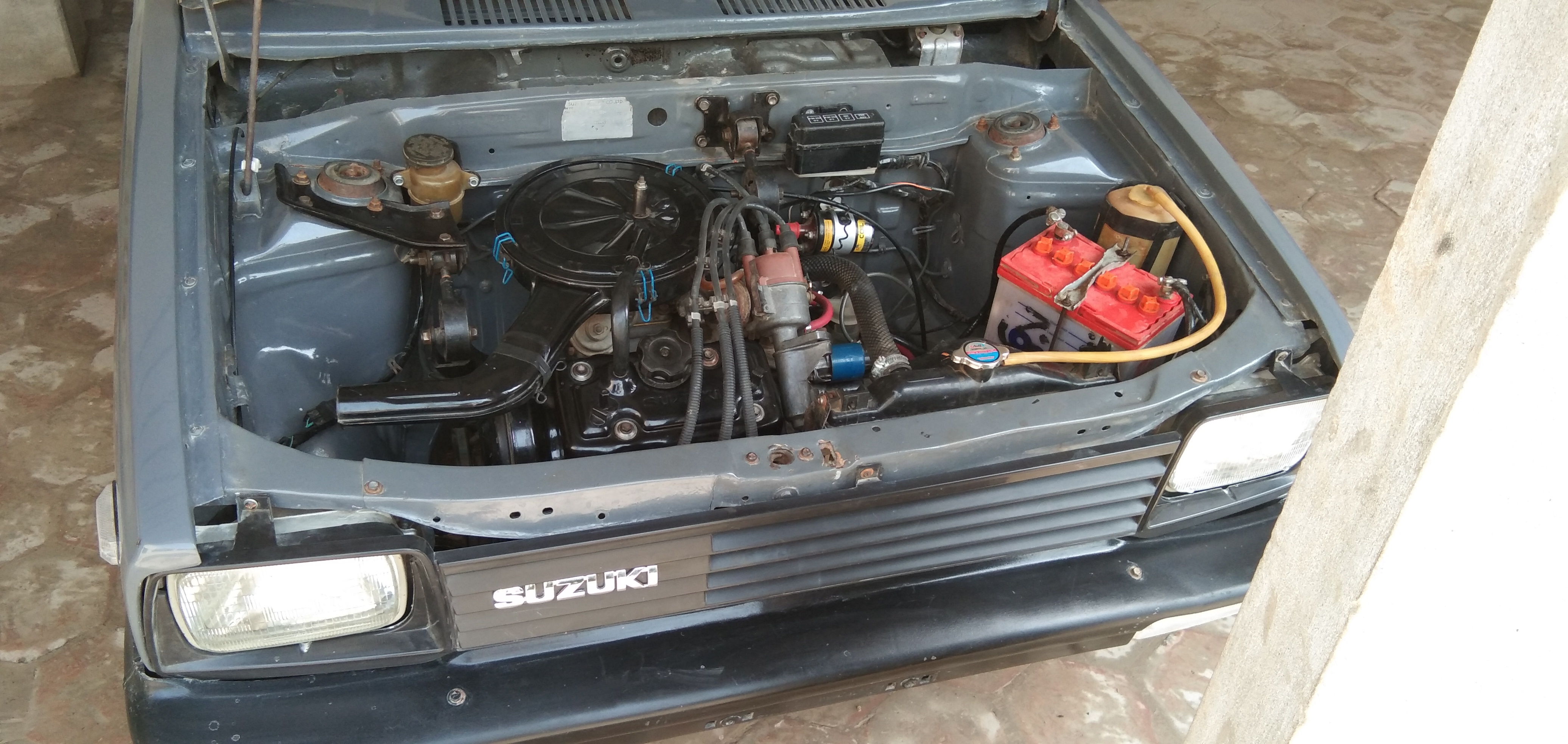

Now check few things:
u have recently installed the radiator. check if there is no air remains in the system.
does it overflows the coolant when hot from the bottle or the cap
hows is the temperature needle. does it goes to hot or not.
Water level stays same or u need to put water every time u drive.
