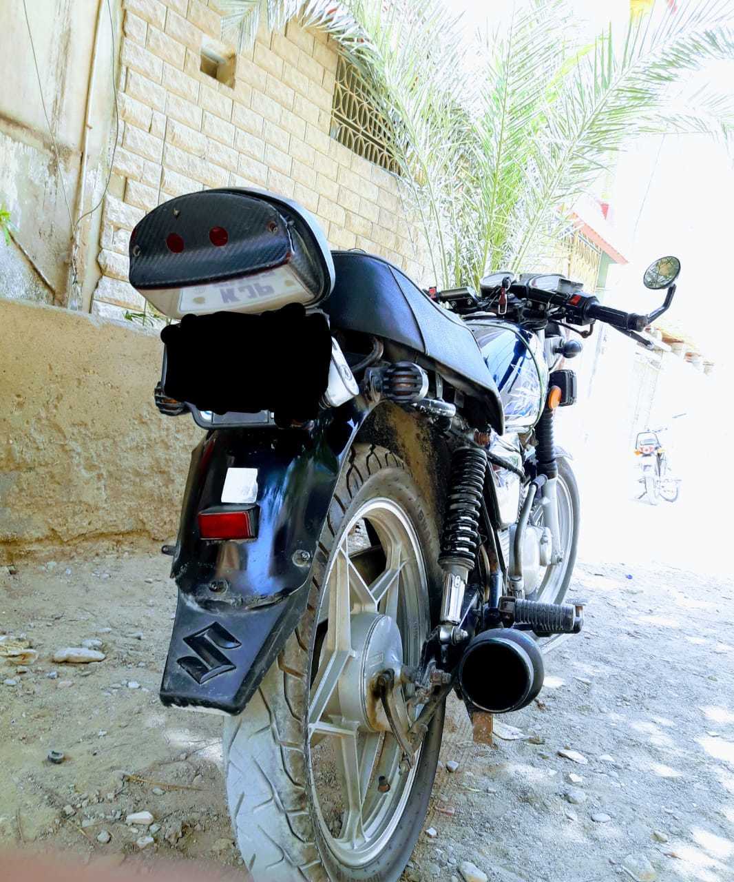

Whats the max size of rear Tyre we can install in stock swing arm of GS ? I'm currently using Swallow Tubeless 100.90.18. Is se bara size bhi install ho sakta hai kya ? Front ka bhi kisi bhai ko idea hai to bta den.

I have a 110/90/18 cruise type installed on my GS. They say it is the fattest you can go without any alterations. Provides good grip though but yes the 90/90/18 make it lighter to ride.
